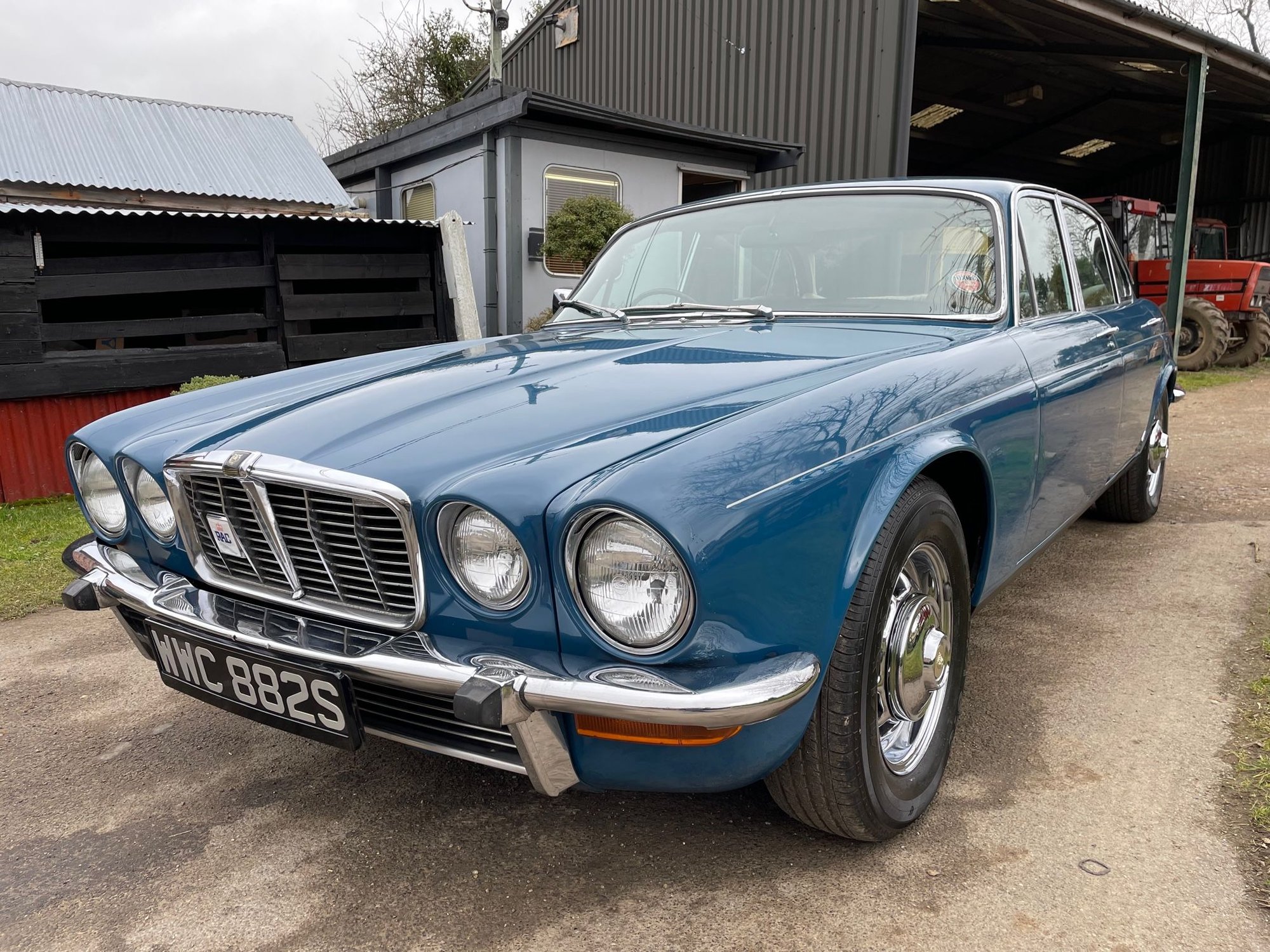

Hi all,
New to the forum and thought I'd provide some info on my status. Back in the mid seventies when I was around ten years old my father took me to a car showroom in Maidenhead UK where amongst other cars they had a '75 series 2 for sale. In the naivety of a youngster I fell in love with the car, but my father said he couldn't afford it and would keep his 1970 Ford Zephyr. I never forgot that car and it always stuck in my mind. As I grew up, I didn't forget this longing, but felt the car was more suited to the wealthy middle aged. As a result, and the luck of having a good career my passion moved on to Porsche.....924, 944 and several 911's. But I never forgot the Series 2 Jag. Now well in my fifties, I decided to look for my unrequited love ! After scouring many ads I found a '77 series 2 XJ6 in Squadron Blue, and it was only around ten miles away. The owner had passed away and after some time his wife decided it would need to be cared for by a new enthusiast. I viewed the car and could see that although by no means perfect, it was an honest motor with original service books, lots of history, parts invoices, many old tax discs and thirty five out of a possible forty two mot certificates. The car has never had a full restoration but has received ongoing attention as necessary, just as you would a modern car of today. When I test drove the car It wasn't running at all well, however I could see it was a fuel issue and nothing serious. Unsurprisingly it turned out the AED auto choke was playing up and I've since wound in the needle jet to over ride this, albeit some 'nursing' required until warm. The car had a current mot but there were a few minor issues that needed addressing. Initially I thought I would get a mechanic to sort these things out but decided the whole idea of this was to have some quality enjoyment from the car and do as much as I could myself, and I've thoroughly enjoyed every moment over the winter evenings of '22 & '23 :Fit black & silver number plates
Replace o/s 7” headlamp (halogen with internal sidelight)
Paint inner wheel arches
Replace o/s interior light bulb
Replace spark plugs
Works and adjustment to AED auto choke
New air filter rubber bellows joint
Replace n/s submersed fuel pump
Replace windscreen washer pump (front bumper removal)
Replace alternator belt
Check and top up ATF fluid
Change oil & filter (20/50 oil / OEM Jaguar filter)
Replace air filter
New Lucas Battery (069)
Re-paint battery box
New floor over mats front & rear
Replace sheared n/s bonnet pivot bolt—(front bumper removal)
Fit new horns
New HT leads
New distributor cap
New rotor arm
New coil
Replace air filter warm air flexi pipe
Jenolite rust convertor and overpaint drivers floor panel
New fuel tank filler cap seals
Paint chrome wheel black recesses
Replace water pump bypass hose
Check and renew various jubilee clips
Disconnect, clean and lubricate and re-connect positive and negative power connections (bulkhead)
Check and top up power steering fluid
Grease rear axles, ball joints, wheel bearings and steering rack

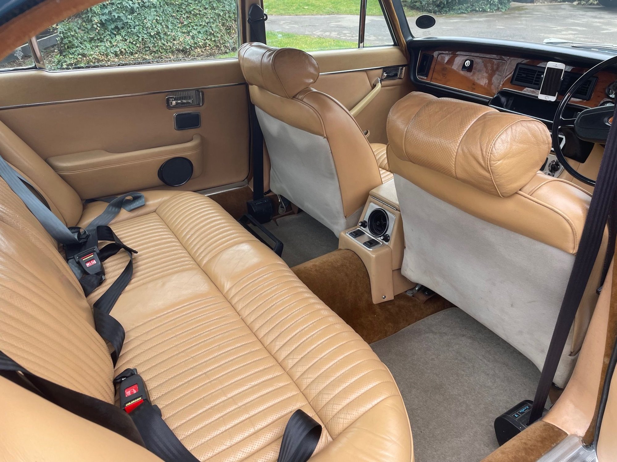

Clean & apply leather treatment to all upholstery (three applications)
Replace OEM Jaguar grille emblem
Replace crankcase breather cap
Replace throttle spindle rubber bush
Fit new front brake discs & pads
MOT pass 20/3/23 (no advisories)
I still have a few things to address such as sagging headliner and L/H fuel tank sender but the car is running well and a joy to drive ! It's great to read owner experiences on this forum and a wealth of information. Many thanks !!

Lovely! This Jag appears to be in generally excellent condition and the work you have done will guarantee proper operation.

nice color, whether original or not, very nice. The XJ is now a Certified Classic (byJaguar World Magazine).
Congrats !

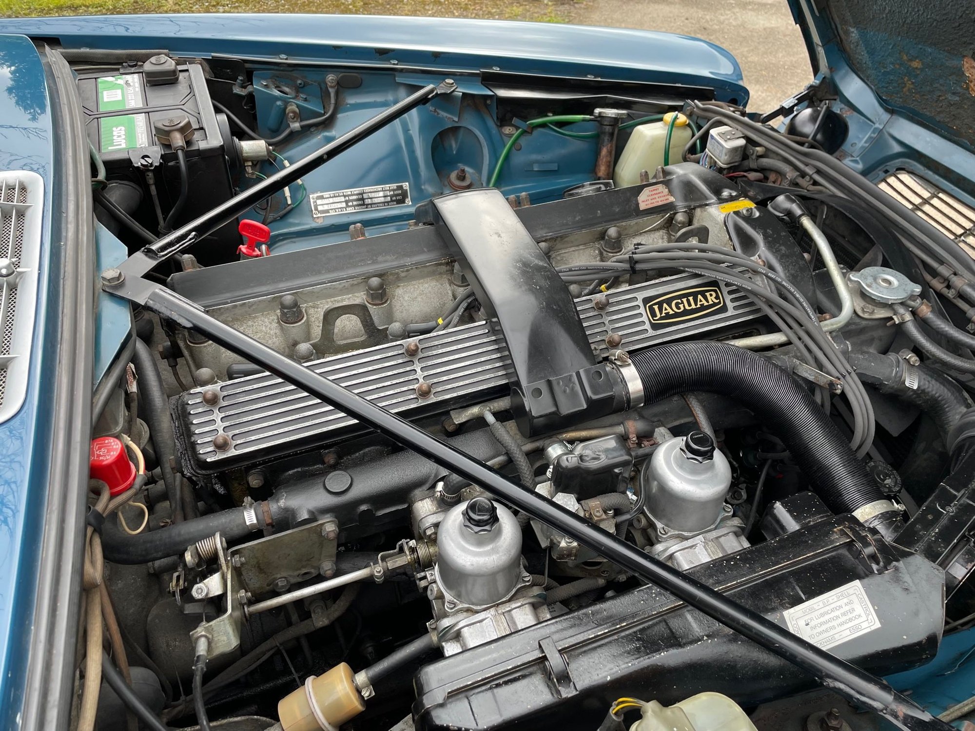

Jose, glad you like the colour, yes it's Jaguar
Squadron Blue and the engine bay has that original 'matt' finish
