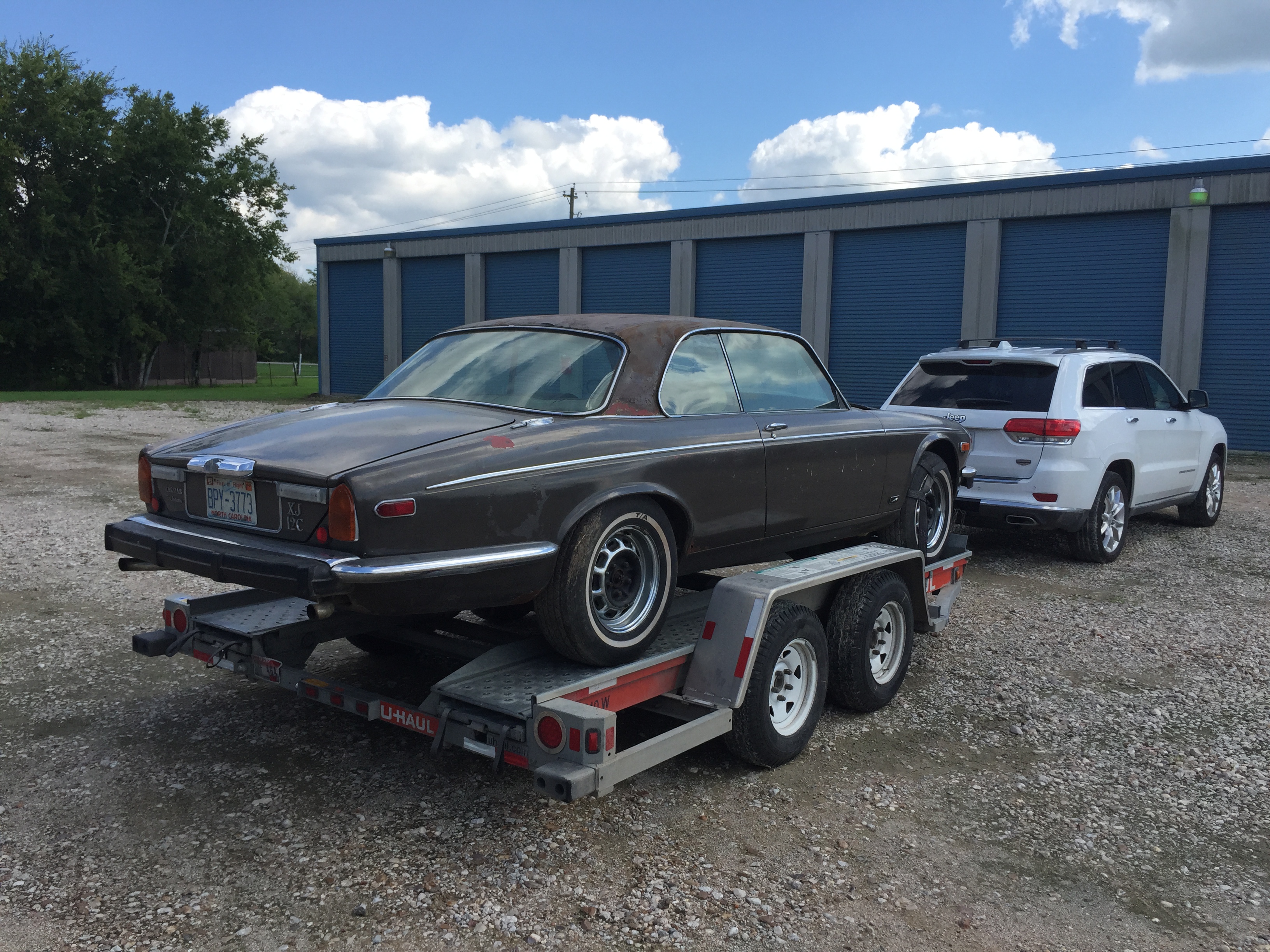

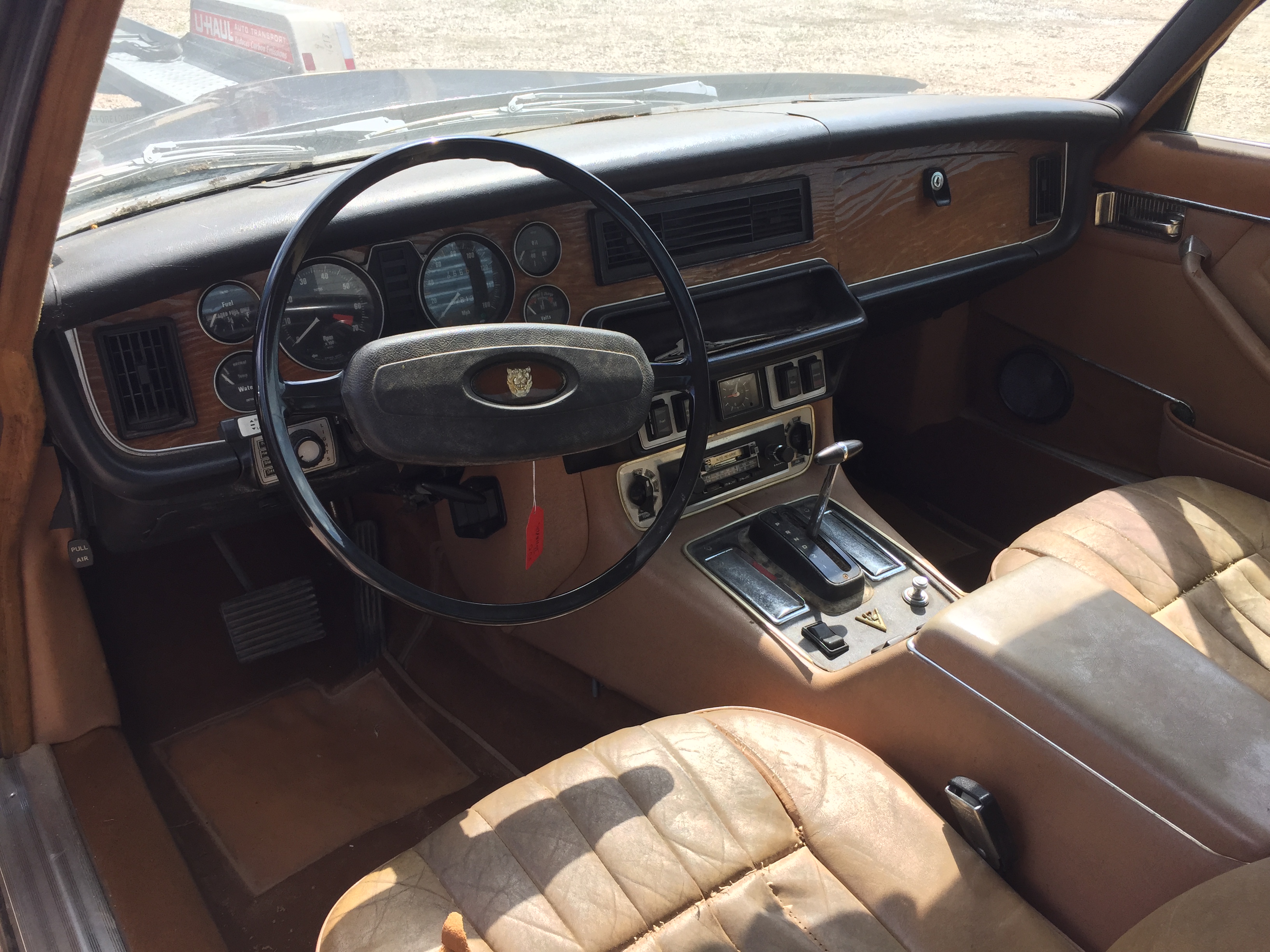

My name is Veso, I picked up a '76 XJ12c yesterday. Cam across the car locally, aways been a fan of 70's coupes so couldn't pass up the opportunity on this beautiful V12! Its gonna need quite a bit of work but I'm excited a
bout it. The owner recently purchased it from North Carolina but the mechanic he had lined up to work on it no longer could do the job so we wanted to pass on it. There seems to be very little rust, but of course I'm sure more will be discovered. The previous guy said there were only 2 other owners previously but with no documents really or books can't verify that.
We ended up taking it to our shop and the engine cranks and most lights & windows are working. Its a beautiful car, looking forward to restoring it fully! My father is a mechanic so it will be nice to learn about it from him. I'm sure I'll be frequently asking you guys for help & advice & looking forward to being part of the community!

Thanks Elinor, yes it had a vinyl roof and the guy I bought it from asked the last seller to remove it prior to buying it to make sure there's no rust under and its good. Haven't decided yet if vinyl will go back on or not

Coupes tend to rust from the inside out. The rear quarter windows leak because of a poor design, water collects inside a lip, rust holes form and eventually water makes it's way to the void right above the trailing arm causing structural weakness. The rust spot on the rear, top of the rocker panel suggests this may have occurred in your car. It's not that hard to repair and reinforce but the rocker does have to be cut open or replaced so welding, metal working and body refinishing skills will be required.
Take off the rear quarter interior panels and have a look from the inside and that will tell part of the story. One correlation I've noticed over the years is that the rust problem is usually proportionate to how well the rear windows function. If they are slow or not working you can bet you have serious rust problems in this area, if they are fast and smooth chances are the rust is minimal. Also check the rear seat pan for softness. I have done the rocker repair/reinforce process 3 times so I speak from experience. After personally examining 12 coups here in the north east I've only come across one garage queen that wasn't rusted significantly in this area.

Currently we are trying to see how bad the engine is and what all we need to do then I'm starting to strip everything off the car so it can head to a body shop, that's def not our cup of tea!
