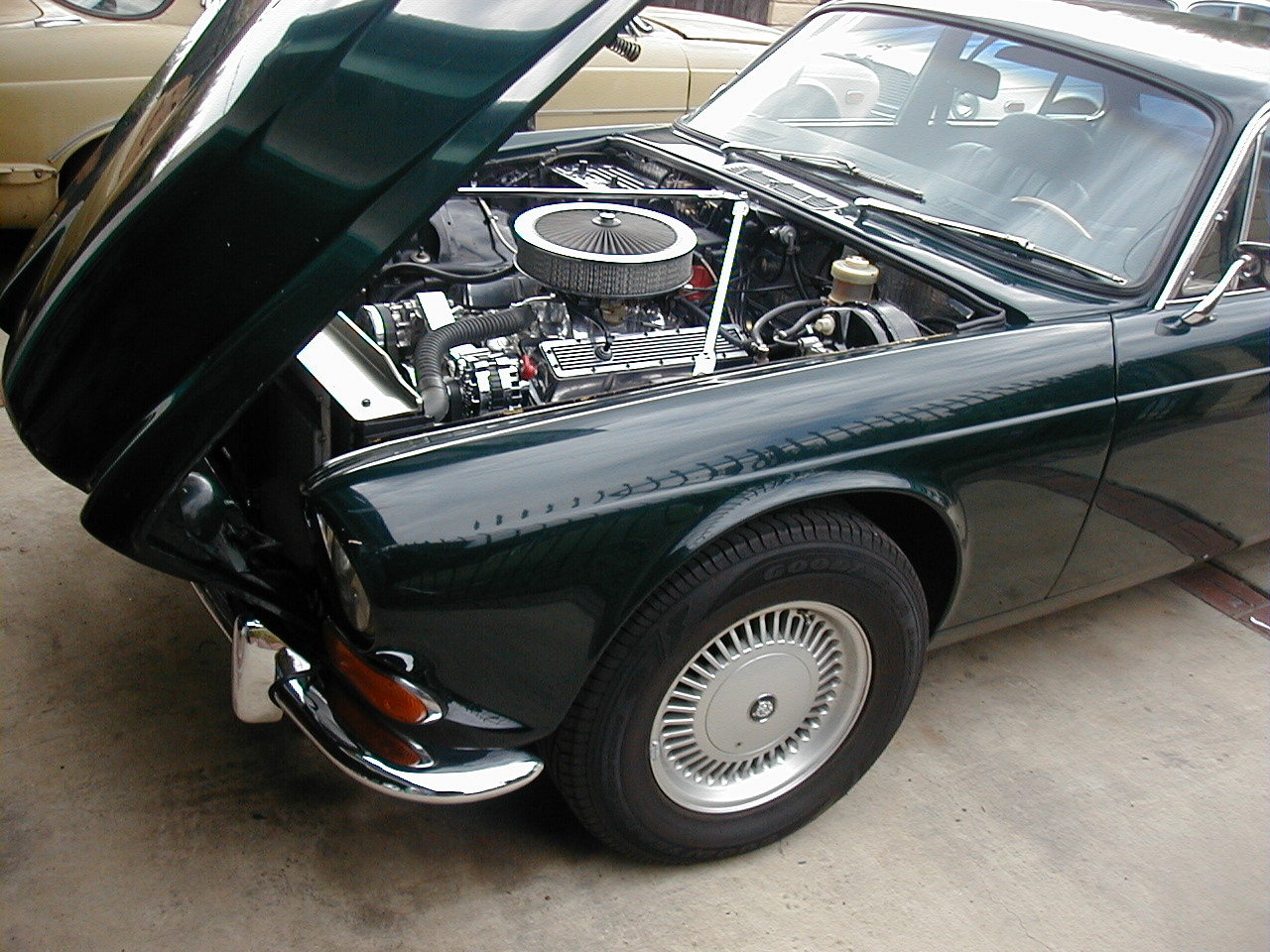

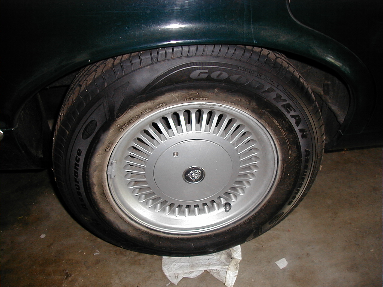

I have the same rims on my S1 but mine are the Premium version with more holes, due to the front hubs being different on S1 vs 2/3, you will need spacers on the front only. You will need longer lug nuts so that at least four-five threads are covered when installed. The size is 1/2X20. The front spacers I used were 7/16 thick.
The center caps might not fit the front until you "massage" the front grease hub caps in so you have enough clearance.
The rears will fit perfectly. You will not be able to fit a spare in your original well...the rims are seven inches wide and with appropriate tires it will not fit. Use your stock spare and lug nuts.
