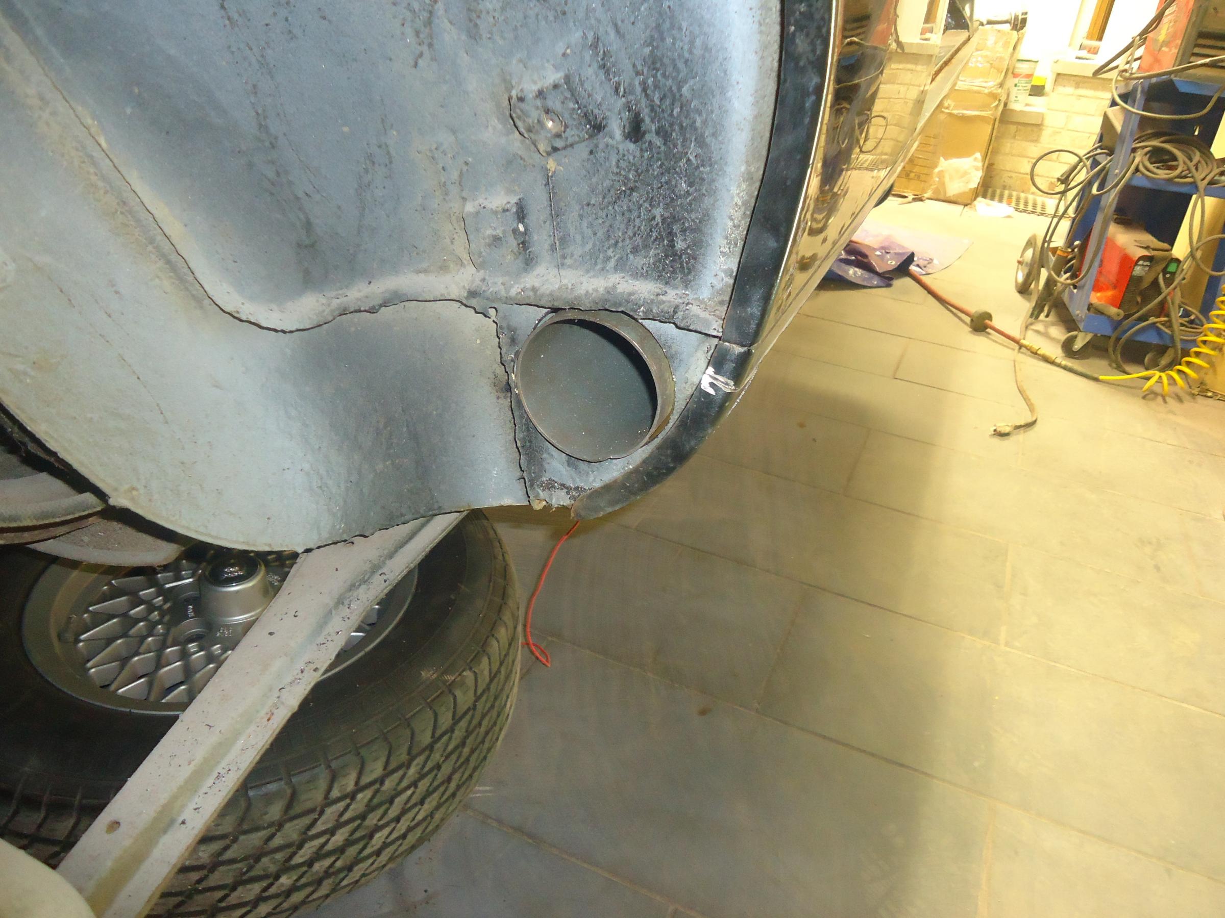

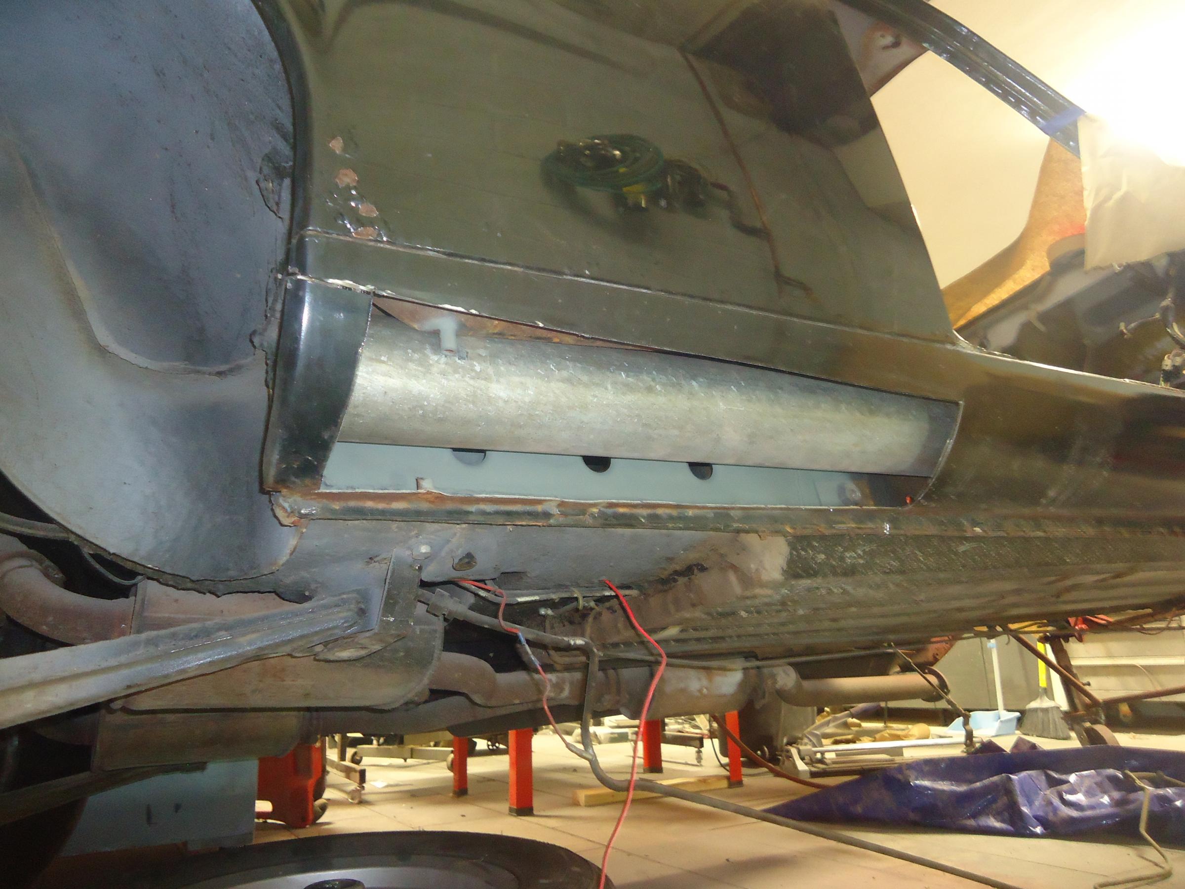

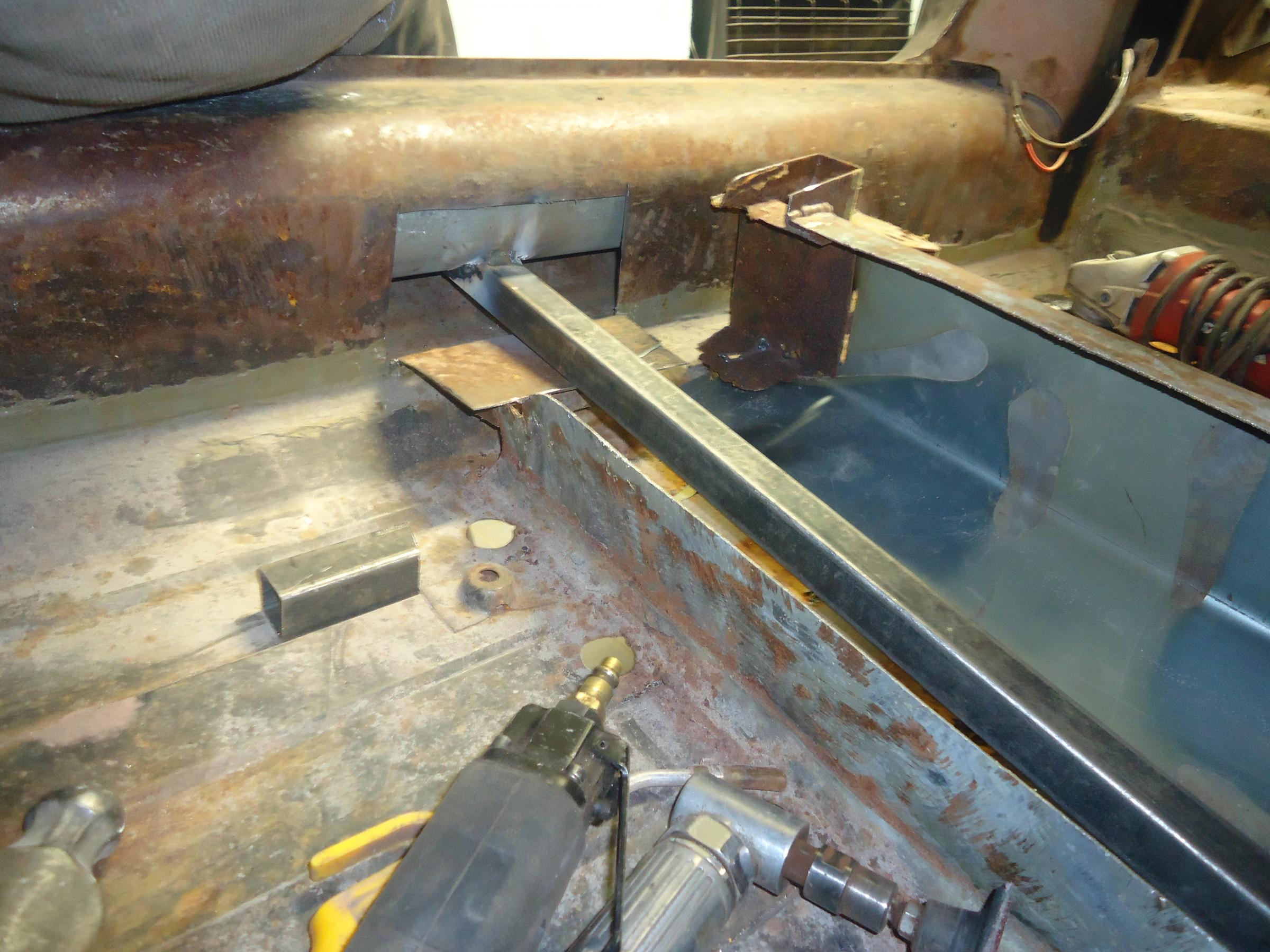

Sill augmentation started.... 3.5 inch holes were drilled in both front and rear sill end plates so the tube could be inserted the full length. The rear part of sill was opened and the inner sill was reinforced in the rear quarter area with 16 guage metal that was dimpled. I expected to see soft metal from thrust stresses and rust but the metal was solid. Both the other coupes I've done this to were Swiss cheese in this area and I expected the same. I reinforced it any way with T shape metal so now it's triangulated and is much more solid than original. The sill, rear quarter post and front door pillar will tied in to the tube for solidity along the length of it. Once the welding is complete the tube will be welded shut at one end and filled with catalyzed rigid foam so it will be rock solid.

I thought about it but I dont see the point. The tube is round and rolls away from the sill so there is no way to do it well with out adding a significant amount of metal and weight. The rear of the door opening vertical member was welded to the tube with some plate and the front upright was also weled to the tube. I also braced the body to the tube in a few spots by cutting access points in the inner sill. The sills are structurally insignificant with tube in place. In any case, I plan on bonding the top of the inner sill to the tube with spot rigid from ever 6 inches or so by dilling a 3/8 hole and using 2lb catalyzed expanding foam. I'm being very judicious with the amount of metal added, weight for this project is a serious consideration. I'm trying to add the maximum amount of rigidity with the least amount of additional weight. For example the dimpled 16ga plate added to the rearward inner sill is far more rigid and weighs slightly more than the 20 gauge undimpled metal that was replaced.
