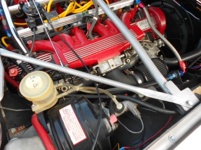

my cross brace from body support side to side and angled back to the cowl itself , it did help with cowl shake quite a bit !

I like that. Does it fit under a stock hood? I'd like to know so perhaps I can fab one up the the 6.0 T56 Xjs.

it does fit under the early XJS hood/bonnet, nothing touches!

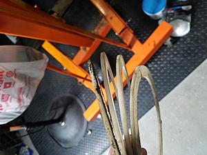

I Just completely disassembled my front end and found 4 of these in with each spring. I am thinking of deleting 2 from each side any thoughts?

I saved this from a prior Forum article:
"There are nylon (I think that's what they are made of) spacer rings between the spring and upper and/or lower spring seats. Supposedly the number of
them vary, depending on the spring color code, anywhere from a minimum of two and a max of four. For example, my cat has four on each side, two above
and two below the spring.
Depending on whom you believe, each spacer (1/8" thick) changes ride height at a 2.5 or 5.0 to 1 ratio. I think it is closer to 5:1 than 2.5:1, because
my ride height increased over an inch when we reinstalled all four spacers (had just two on each side when we changed springs during conversion)."
I wish I had spacers to remove... I cannot see any on top or on the bottom on either side....

I think Ill delete 2 on each side. I need to look up the weight difference between an xk engine and a AJ16s!
