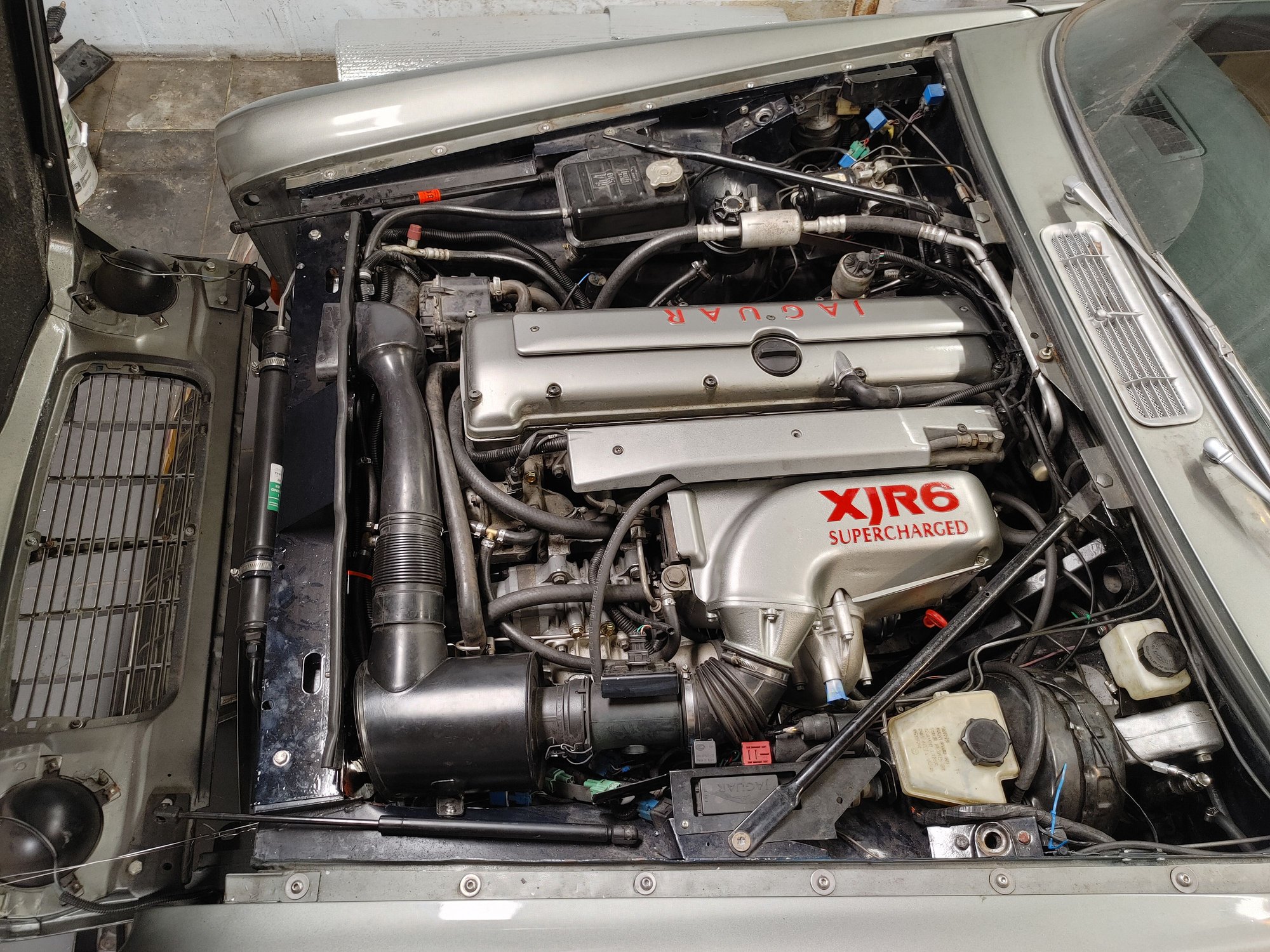

The 2017 Coupe is back in my possession temporarily for a AJ16R and 5 speed conversion.
A few notable features are a dedicated and separate high capacity cooling loop for the intercooler
Upgraded A/C system
Extensive suspension upgrades, It's going from Cruiser to Miata fighter.
Rear IRS bracing
Engine retiming to extend the useable RPM range.
Aj16 with new Tremec TKX
In and out from the bottom.

Just an Update, . I neglected to post some picts of this car finished. It's extremely fast and sedate. The dedicated coolant loop and much larger intercooler really help it make power all the time. It doesn't get heat soaked. It's back with its new owner now it drives amazing. What I loved was the drama free torque and how ot gathered speed at any RPM.

What bell housing is that? Car looks great!

Fantastic work ICSA, that's a truly impressive swap and an awful lot of intense work. The new owner got a good deal on an excellent coupe!
