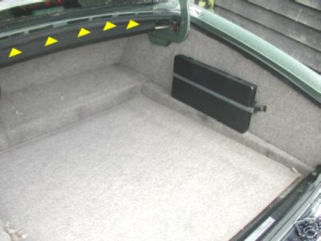

I'm not sure about the Series 1, but when fumes get sucked into the cabin in a Series 3, it's usually through the hidden cabin vents at the top of the rear cowl channel, behind the boot lid seal; The "S" muffler tips help divert exhaust away from the car but not during idling.
look at the top of the rear windscreen cowl with the boot lid open, are there openings or vents behind the rubber seal? If yes, there are flaps behind them that lose their gaskets and they allow fumes inside.
then if you look under the cowl inside the boot, on your back, there is a "tray" that is removable and the flaps are mounted to it. you'll have to remove the entire tray assembly to clean it (it becomes clogged with debris), and correct the flap gaskets if missing. The gaskets were usually squares of headliner fabric material glued to the metal flaps, so this would also stop any rattles.
A good sign that the flap gaskets are missing is a metallic "goatbell" sound when opening or closing doors.
congrats on your find.

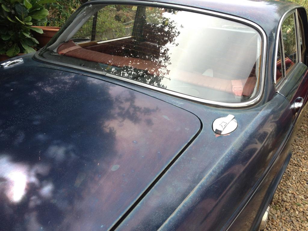

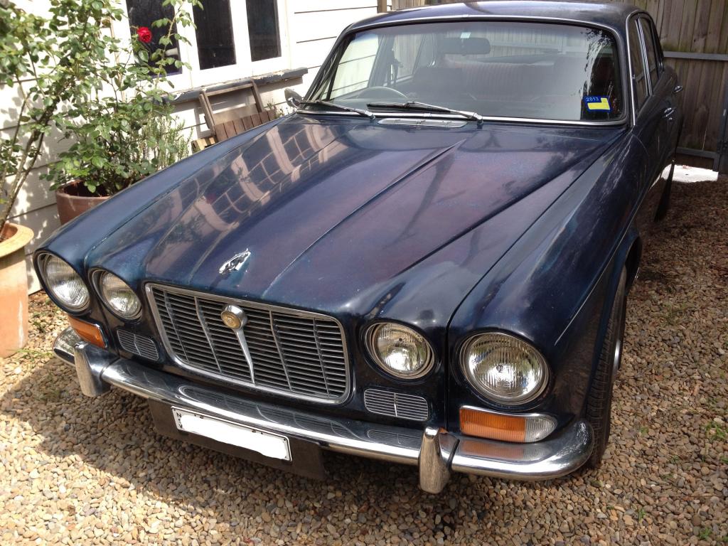

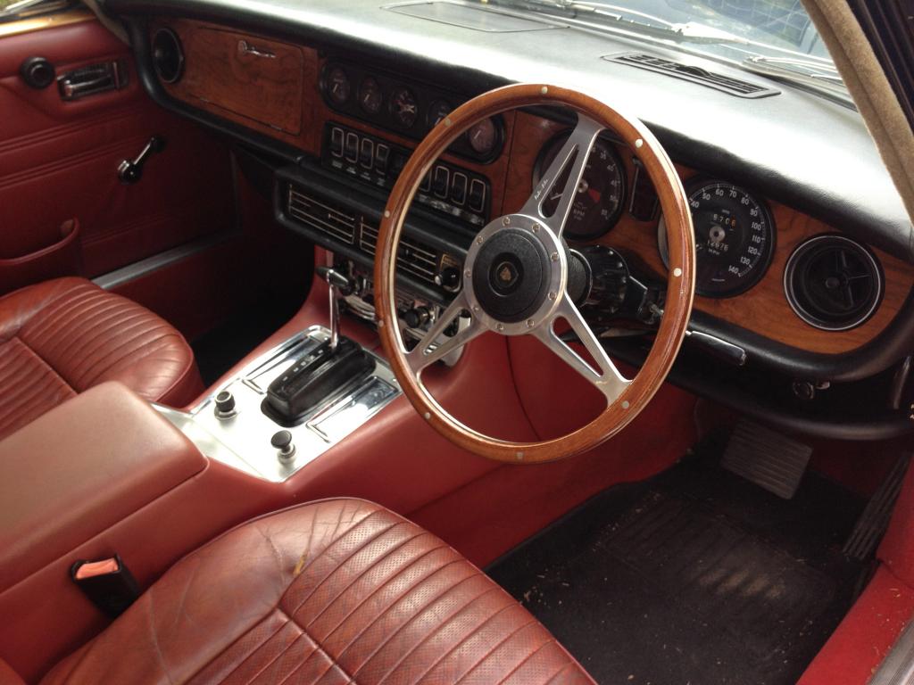

Guys, here's a few pics to give you an idea of the overall condition.

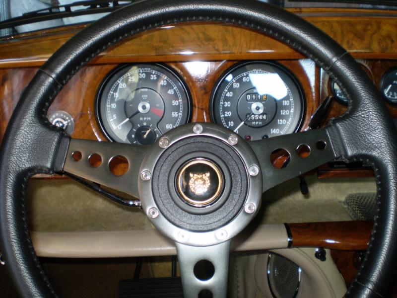

Has a nice MotoLita wheel fitted

if you ask me, that looks like the original exterior paint and the interior looks also original. I bet you can bring it back to Driver condition with a lot of hand detailing and the right chemicals. Looks very good.
curiously I have the same horn-push assembly you have, in my '65 S type except I fitted a Momo Growler emblem I had from years ago.
Attached Thumbnails OK so I've got this series 1 XJ6...-s-type-steering-wheel.jpg

Default Steering wheel with rivets
I sold my wheel with rivets, gets too hot to touch in the summer. Bought
a full wood wheel rim one from Grant Signature line.
Has been on for 4-5 years now and works great...
yes, and the lacquer starts to peel off after a while. I went with leather.
Yeah they do get hot in the summer. I've got the original factory leather trimmed wheel with metal horn rim, thinking of maybe putting that back on, keep it stock looking.

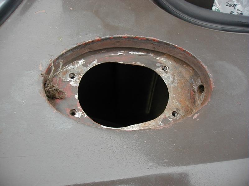

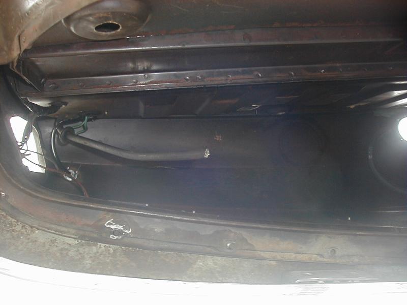

Default Fuel smell from top of filler cap

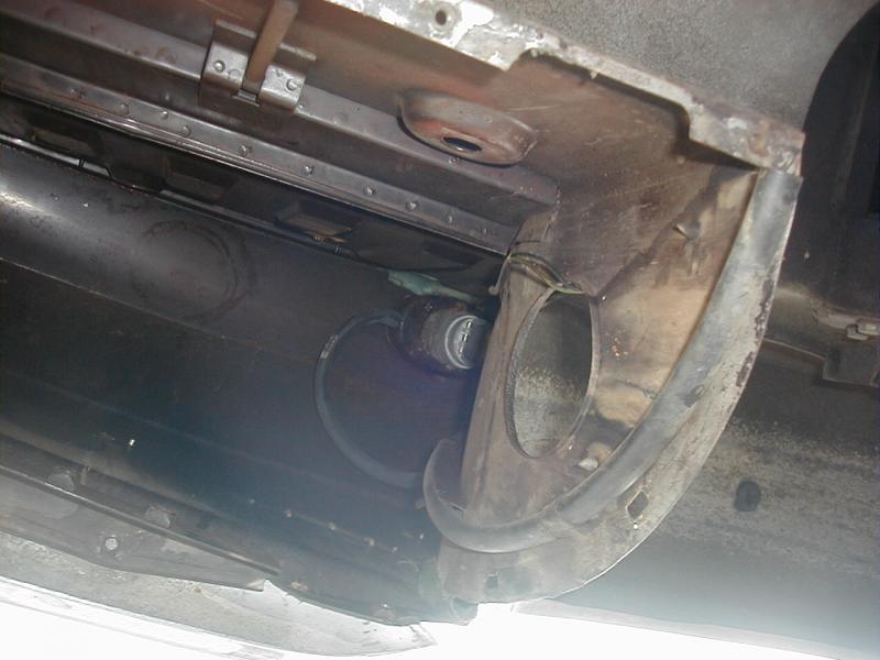

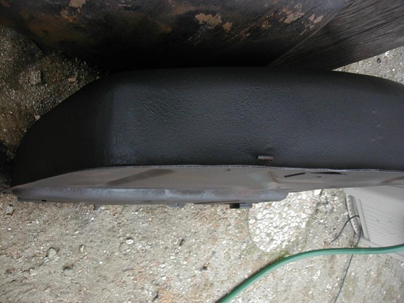

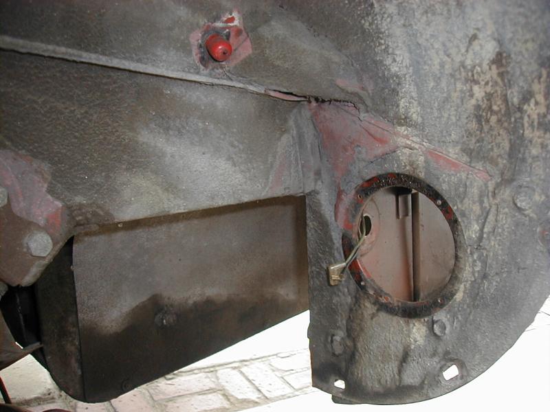

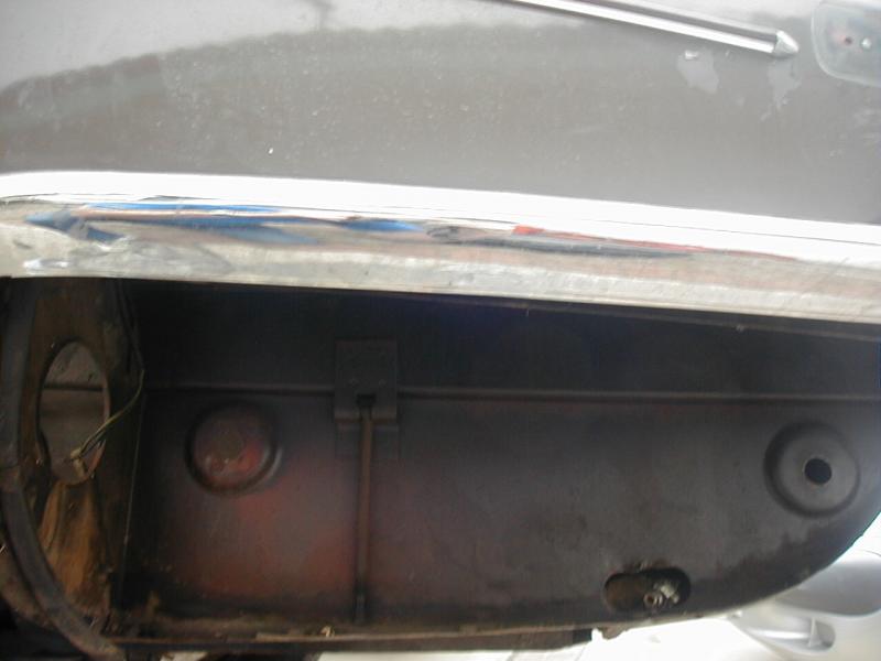

The actual rubber seal on the outside of the car can be replaced easily.
Under the filler cap there is a hose that goes into the rear pillar and another
from the tank to vents.
I have added photos from the recent removal of my S1 tanks to replace
with S2 tanks that had FI. The LT1 SBC engine in my car needed a proper return line for the fuel due to the fuel injection.
Also changed out all the Jag changeover stuff and used a Pollak valve
and external fuel pump.
Attached Thumbnails OK so I've got this series 1 XJ6...-rear-vent-tube-goes-into-boot.jpg   OK so I've got this series 1 XJ6...-vent-hose-broken-off-attaches-fuel-filler-cap.jpg   OK so I've got this series 1 XJ6...-vent-hose-view-goes-filler-cap.jpg   OK so I've got this series 1 XJ6...-view-gas-tank-valley.jpg   OK so I've got this series 1 XJ6...-view-upward-valance-removed.jpg
OK so I've got this series 1 XJ6...-old-new-gas-tanks.jpg   OK so I've got this series 1 XJ6...-fuell-sender-hole.jpg

I am not sure I'd want to remove the patina from either the interior or exterior of that car. It just looks right. A veteran still doing what it was intended to do and looking the part.
At about age 17 or 18 and beyond, I worked while going to school at a full service gas station I sure learned a lot there. Washing cars was one of my duties. Plain water and atwo or three chamois was all we used. An old timer brought in his older black Mercury sedan. The paint wa very similar to this car. He instructed me to use a bucket of water with bout half a quart of kerpsense in it after the wash as a rinse. Well, that black really cleared up and took on a shine it didn't have. Probably short lived in the west Texas sun.
But, easy to renew!!

Yeah I want to preserve the patina. Just going to treat the surface rust so it doesn't get worse. Don't mind the rat rod look. Might try that Kerosene rinse trick. Thanks for sharing.

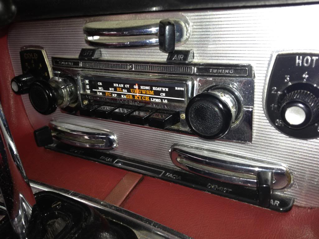

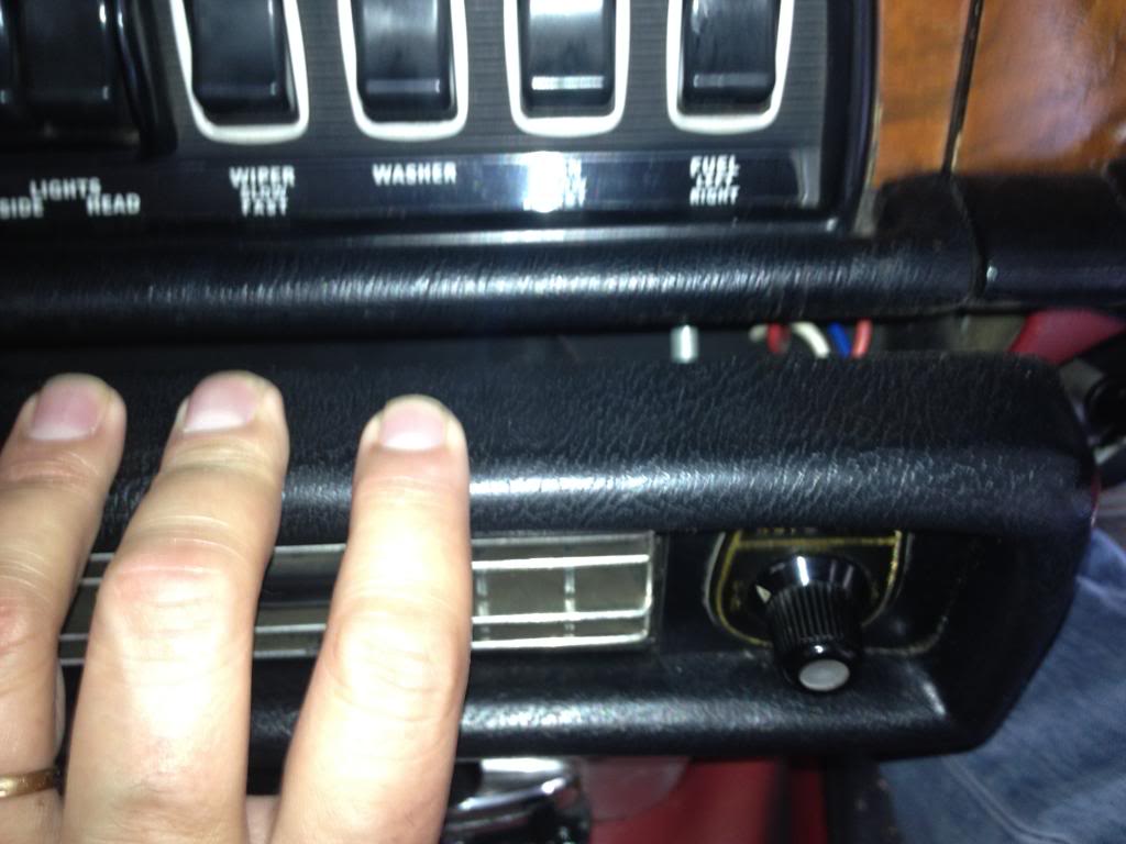

Here's some pics of the air con unit. Looks to be specifically made to fit the XJ. Plastic suround matches the dash material. Only blowing hot air at the moment.
It's aftermarket. I have the original warranty card. Installed in 1974. Made in Australia!
Unit hinges forward to allow for fuse and gauages section to drop down.
Also has original Aus made AM Ferris push button radio with New South Wales dial. Has the centre speaker in dash plus another speaker on rear parcel shelf with a fader knob on the centre console.

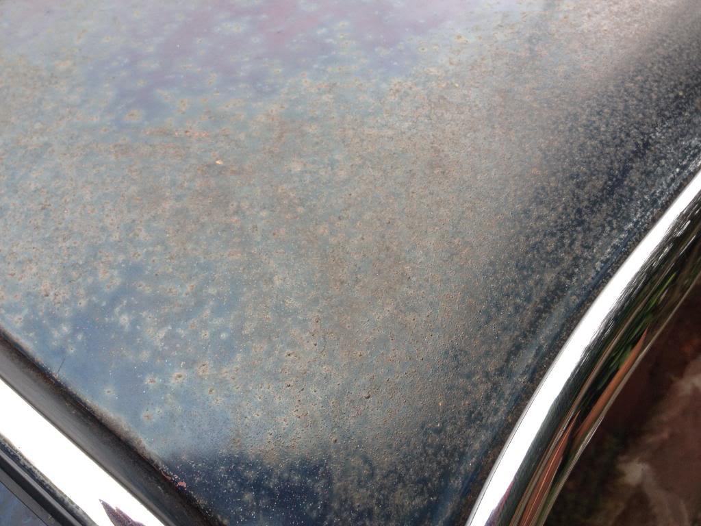

This is the worst of the surface rust. (on the roof). Really need to sort this before it gets out of hand. I got hold of some decent rust converter type chemical from a panel beater going to give it a go and see if it cleans up a bit.
Thanks for the images Davo... Wow! Never seen anything like that custom fit A/C unit before. Very cool (no pun intended). Also LOVE that NSW radio. I lived in Australia for a while - fantastic country. I was planning to move permanently to Melbourne actually but it didn't work out. Granted, I never got close to many classic cars while I was there but I've never seen a radio like that.
Why was there a NSW specific radio? ...And if you ever see another one in a flea market or something let me know because I WANT IT Great stuff... nothing better than interesting, period-correct accessories!
I bet you could definitely get that rust looking a little better with a converter of some kind... let us know how it works out.
