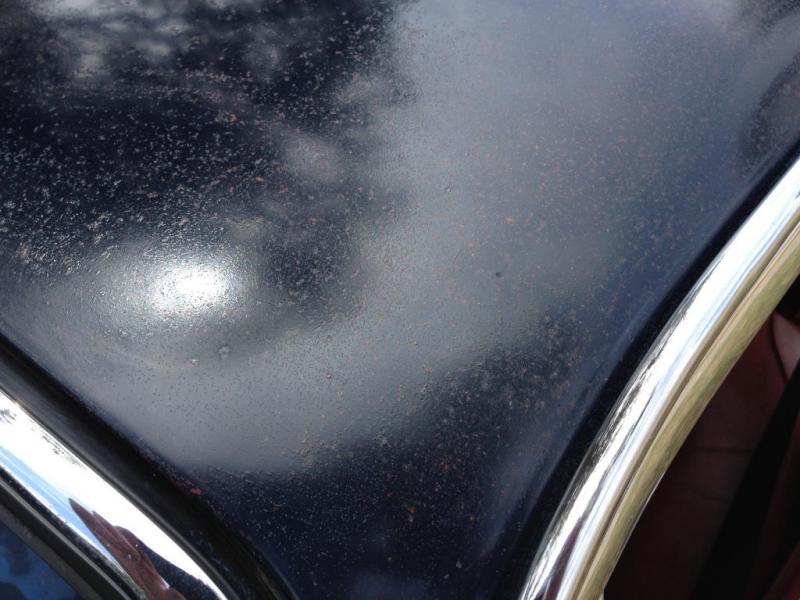

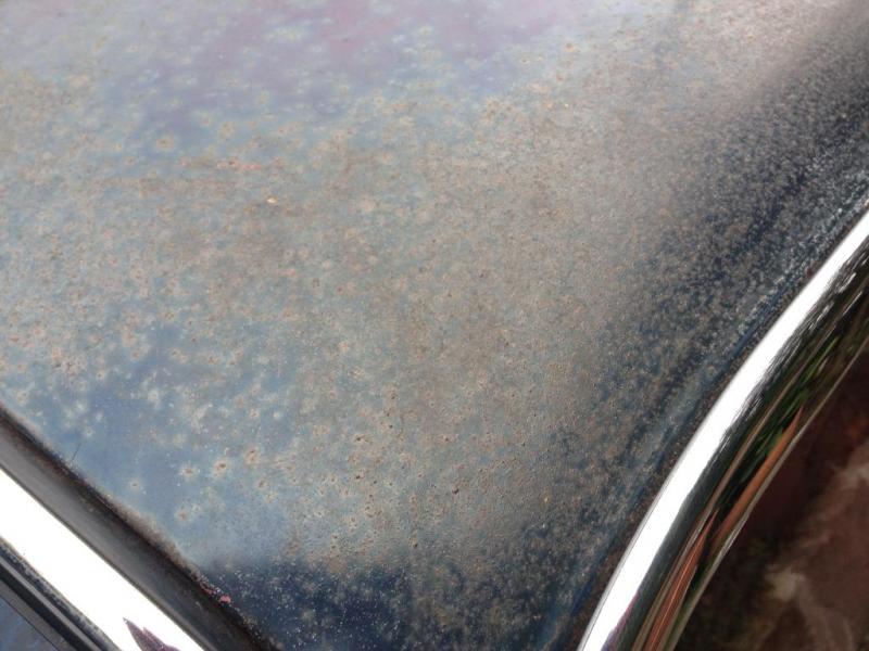

Bit of an update. Think I deleted my previous post by mistake after a few cold beverages. I've had a local Jag mechanic replace both fuel pumps and sender units so now have working fuel gauge on both tanks plus the raw fuel smell seems to be gone from the boot area. I still want to replace the boot seal and rehang the boot lid as it's sitting skew and I think is letting in exhaust fumes. I'll check those boot vents under the parcel shelf at the same time.
Had a reasonable result fixing the surface rust on the paint. Got some decent rust converter anti oxidant from a panel shop. Cleaned the whole car with it then rubbed back the surface rust with 600 wet and dry. Used Kitten No.2 cut and polish to buff it up. Came up pretty well.

Here's a pic of the whole car after polish.
Attached Thumbnails OK so I've got this series 1 XJ6...-2012-11-27102541.jpg   OK so I've got this series 1 XJ6...-2012-12-08113515.jpg   OK so I've got this series 1 XJ6...-2012-12-08113421.jpg
