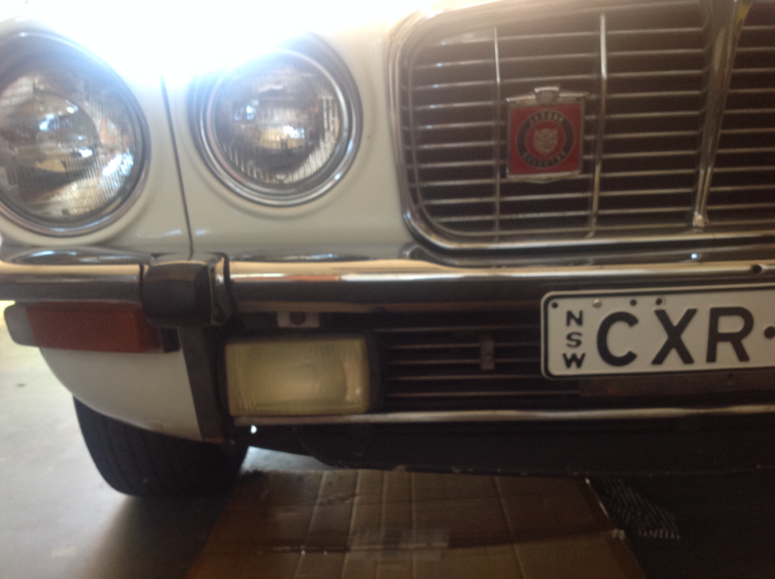

Having sorted out the failed main beam, I now have the extra front lights installed. The wiring is definitely in place from factory as Richard and Doug confirmed. Once the main light switch inhibitor was released, the last switch position now functions to operate the lights by pushing and turning the knob.
This switch position is intended for retro fitting front fogs, not driving lights, so technically I should fit coloured fog light lens. I'll will probably never use them, but they look good IMO!

Tony mine are original s 2 fog/driving light and not coloured.

I like the profile of yours Jim, would be nice to find originals. Do yours function driving or as fog? i.e. the rear fogs come on simultaneously and the headlights go out?

They come on withe the headlights on...didn't know about rear?
Edit..I just checked and they do come on on their own.....just learned something.
