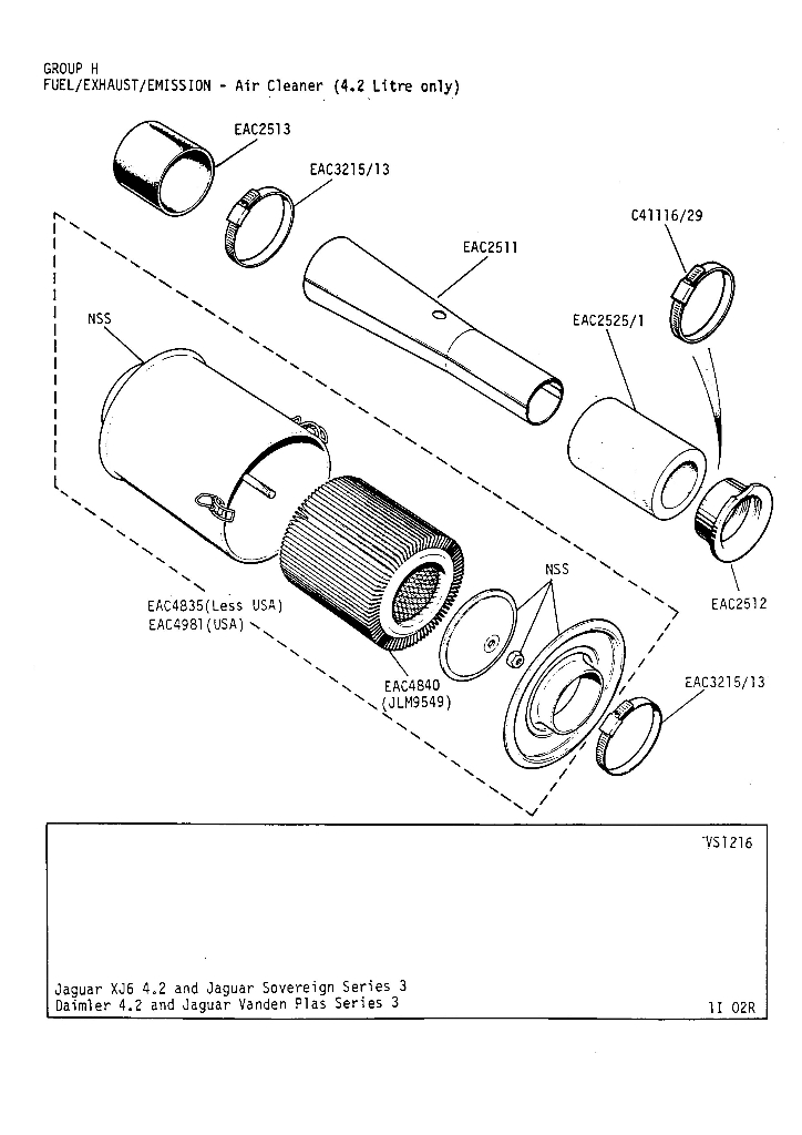

Few more long shots that you can check:
Plugged air intake filter,
Missing air horn P/N EAC2512
Plugged Catalytic converter (other will have to describe how, I can't find my notes. I put a pressure gauge on exhaust manifold and checked pressure at several RPMs)
If you look on under hood you will have Decal for CA approved timing (17* at 800 RPM, vacuum removed and plugged): this should give you 33* at 3000 RPM with vacuum line hooked up.
