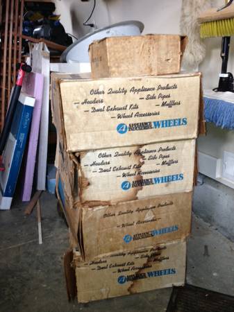

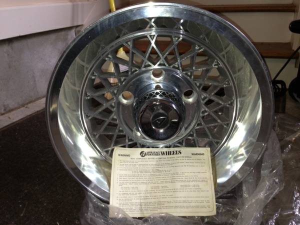

I found four brand new 1976 mag wheels that look like Kelsey Hayes but I have no clue if they will fit my XJ-6.
the only info I have is from the wheels, per the picture below, no clue about offset etc. Any opinions?

I can't read the printing on the documents or the boxes. Manufacturer? Google, still around. Call for ID?
Well, you can measure the bolt hoe spacing and ID. Most common are the Ford spacings and the Chevrolet meaurements. JAG and chevvy are alike, I think.
The wheels are marked as 15 x 7's. Nice size, except for limited 15" tire choices nowadays.
Measure the bore. Very important as the cars are designed with center load, not merely the lugs.
You can measure the offset wit a couple of straight edges. A framing square does nicely.
They do resemble the lattice wheels on my car. Mine came from an XJS.
Lincolns and Ford town cars sed a similar lattice wheel.
these seem to be after market and may fit a lot of cars, our Jaguars included. Probably not for you as you like things original.

they are 7" deep, won't fit.

7" will fit but the pos/ offset looks too deep, compare the #'s with your xjs rims, i have xjs S2 on my xj6 S2,

thanks, yes that is what I meant, the offset. Looks too deep.

Those wheels look like Appliance wire mags circa mid 1970s.
Appliance also made bolt on wire wheels, sidepipes, chrome dress up kits etc.

Originally Posted by andrew lowe
Those wheels look like Appliance wire mags circa mid 1970s. Appliance also made bolt on wire wheels, sidepipes, chrome dress up kits etc.
yes they are Appliance wheels.
