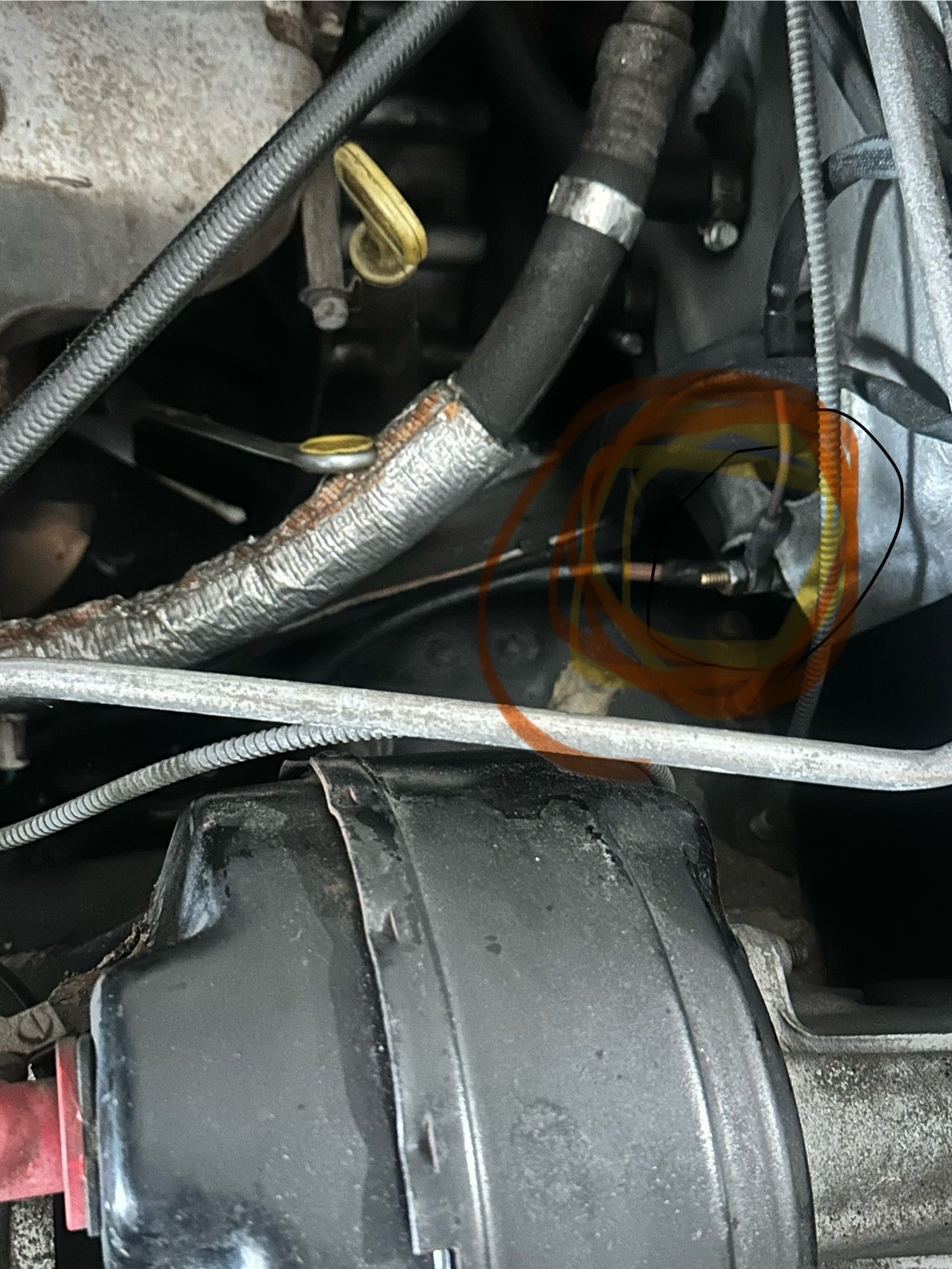

Default Photo attached
Ok. So what I thought was a ground is not. It is positive matching the positive terminal of the battery. What the heck’s is this and why is it uncovered on the firewall near the brake booster. Photo attached
Old Aug 28, 2024 | 06:08 PM
Jose's Avatar
Posts: 9,140
Likes: 2,662
oh my, that is NOT the oxygen sensor, The oxygen sensor is at the "Y" junction of the exhaust manifold where it meets the catalytic converter or "Y" pipe.
What is shown in your picture is the Always Hot power distribution from Alternator, NOT a Ground.
Old Aug 28, 2024 | 06:40 PM
Doug's Avatar
Posts: 25,538
Likes: 11,735
From: Pacific Northwest USA
There's another junction post just like it on the opposite side of the car. Originally they're covered by rubber boots.....which break apart and fall away over the decades

Old Aug 28, 2024 | 07:38 PM
dk65's Avatar
Joined: Jun 2022
Posts: 118
Likes: 24
From: San Francisco, CA
Yeah -- I know where the O2 sensor is. I was trying to ground the sensor with an extra wire. Is that supposed to be exposed like that though? Seems dangerous
Old Aug 28, 2024 | 10:56 PM
Doug's Avatar
Posts: 25,538
Likes: 11,735
As I said above they originally came with rubber protective boots .....that rot away. You can find equivalents with some Googling under "battery cable boots" or similar. Like this
