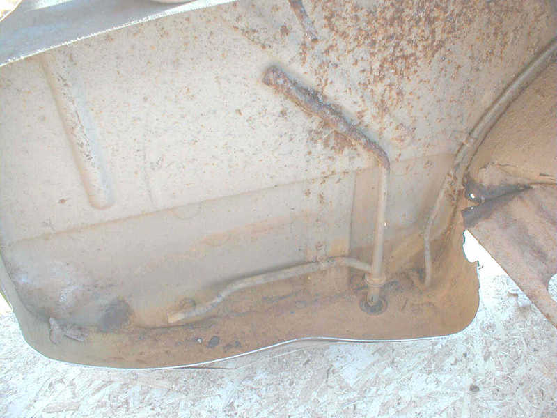

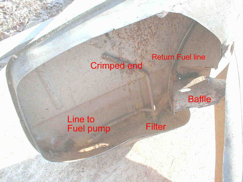

Hello again, further to my previous post I have since received the attached from another forum. Most useful I think.
Attached Thumbnails Petrol Tank 1980 XJ6-snaps_resize_1f1146ad9e4e10a097d1b5b4aaee1472.jpg   Petrol Tank 1980 XJ6-snaps_resize_2a57b2f57930ebc1324e9e6d54b41f78.jpg   Petrol Tank 1980 XJ6-snaps_resize_2a893decf2b30ed912845c93922ef9c2.jpg

I'm planning on doing both tanks on my S2 XJ6 and was thinking I'd use the POR15 version - though I think it's dearer!
I'm worried about what the sealant does with all those pipes we can see in those cutaway photos. What are your thoughts?
