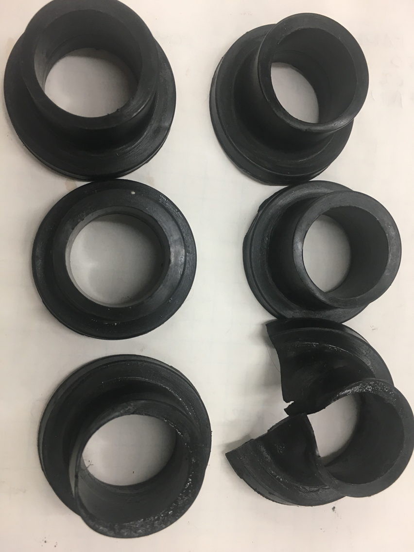

Installing my second set of urethane bushings in the lower control arms of my XJ12L. The first set went four summers, barely. mileage guess would be less than 5000 miles. Short life contributors, IMHO, larger than stock tires, and three hours of track time at Mid-Ohio.
Trying Energy Suspension bushings this time. We, the neighbor with a lathe, and myself, will have to modify theirs to fit.
