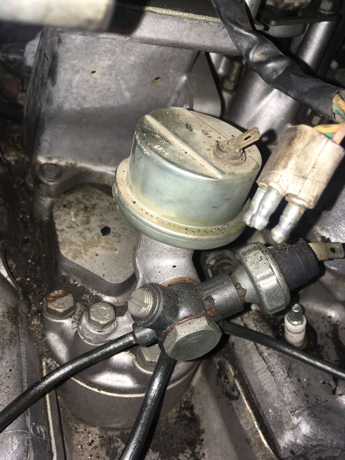

If I have one that has sat for a year or so, I remove the Idiot light sender, and using a spigot fitting and a syringe, prime the system that way. It will take whiles, and you will :feel" the thing get harder to push as the system fills up.
