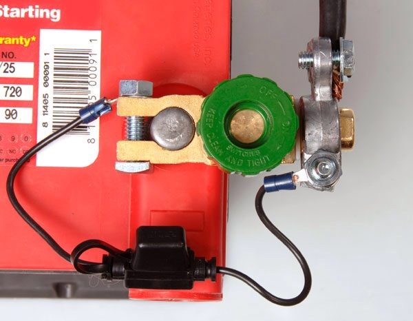

It is wise to install a battery cable disconnect.
Good for ending battery drain, theft and preventing fires.

Giovanni:
With all due respect, tat switch gives me a couple of concerns and a question. An answer might resolve at least one concern.
1. That frayed cable clamped in to the switch. One of those "bodges" caused me a lot of issues with a flat spot in a past turbo'd Corvair, sorta Corsa project.
2. Is the knob robust enough to handle large current draw as in starting?
3. What is the black box.
4. How about memory storage as in ECU's and radios?
Perhaps the answer to 3 resolves four.
Bur, in turn raise the issue that the battery isn't disconnected in total at all?
Carl
