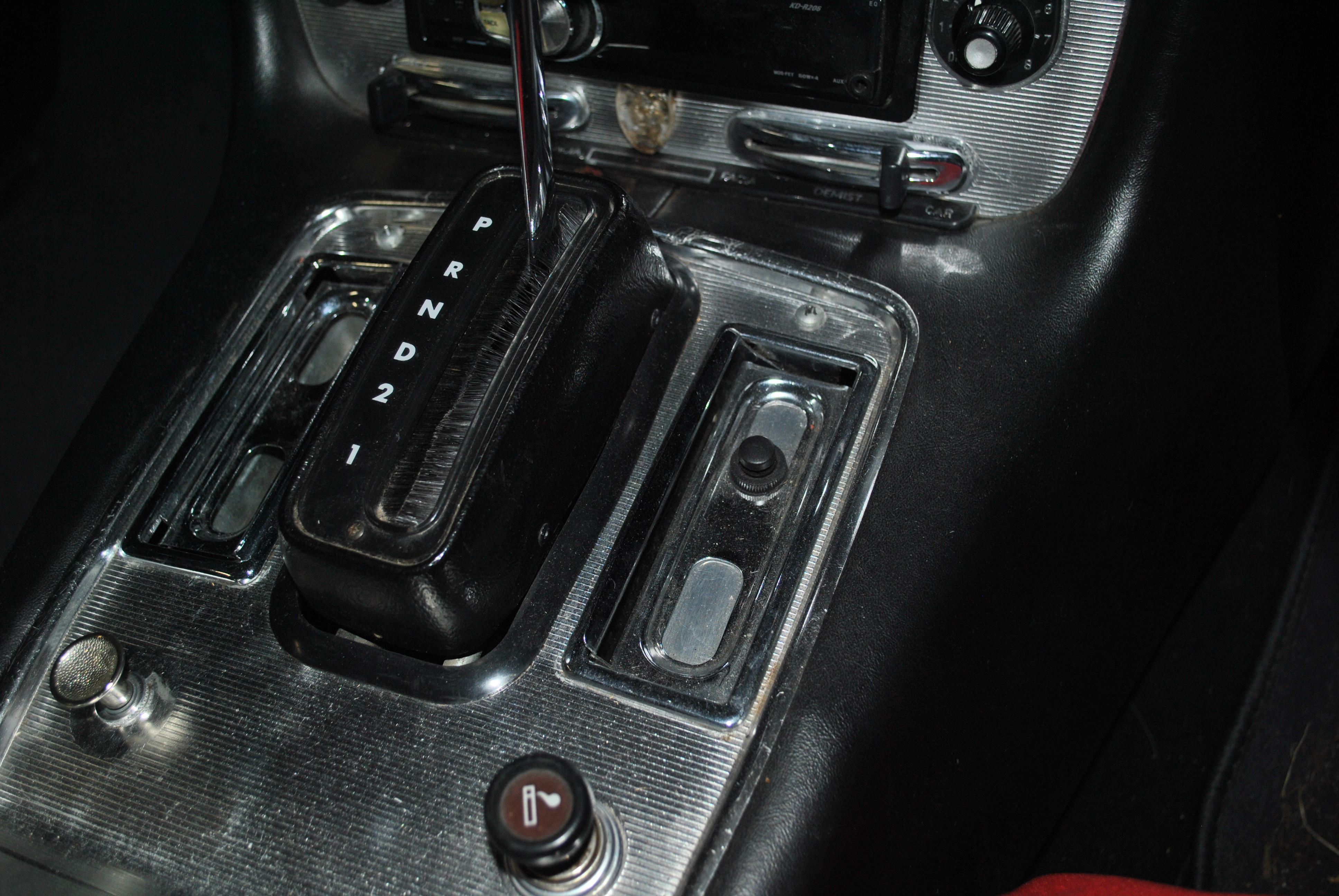

The first mod I made to my car when I got it was adding a simple push/pull switch to the console so I could turn off my Navman when getting out of the car. As for the windows, powered or unpowered makes no difference.

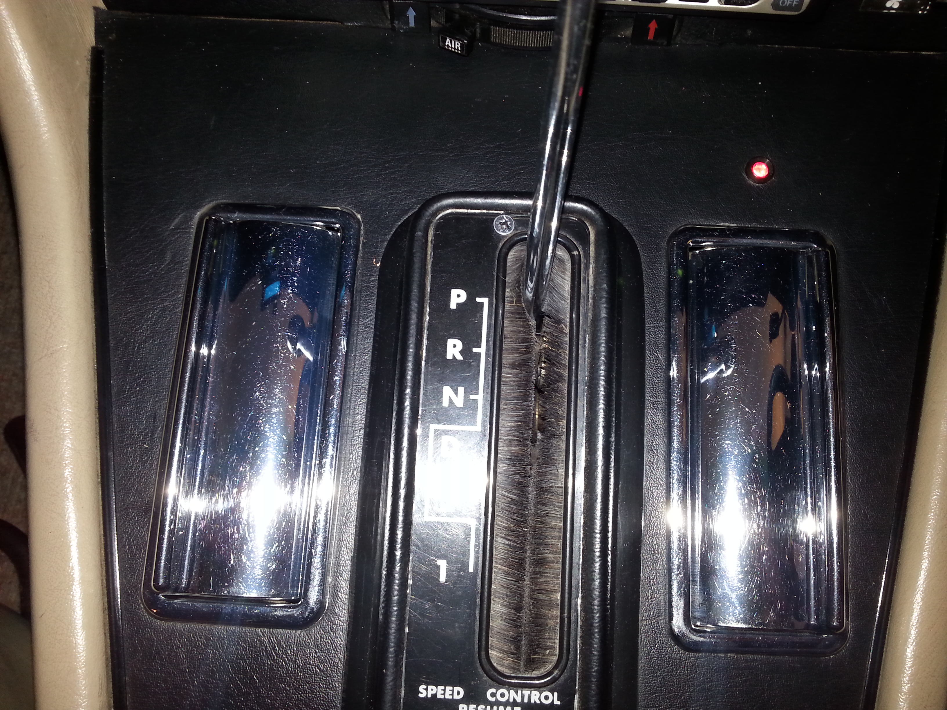

That's exactly what I ended up doing today, Clarke. Extended the cig. lighter live feed wire, spliced in a small rocker switch and mounted it inside the passenger side ash tray. When I thought more about it as the second option, it became the preference since I can now switch off whatever is connected to the cig lighter at will. E.g. I can switch off the mp3 and still listen to the radio. I'm not really bothered about changing the windows, but I'm a bit envious of yours operating without ign on!!
This has also re-commissioned the otherwise redundant ash tray to serve a useful purpose. Since my reversing lights had not been connected when the T700 was installed I created a similar set up by mounting a switch in the driver's ash tray for a simple manual operation (I think that was a tip from Elinor if memory serves).

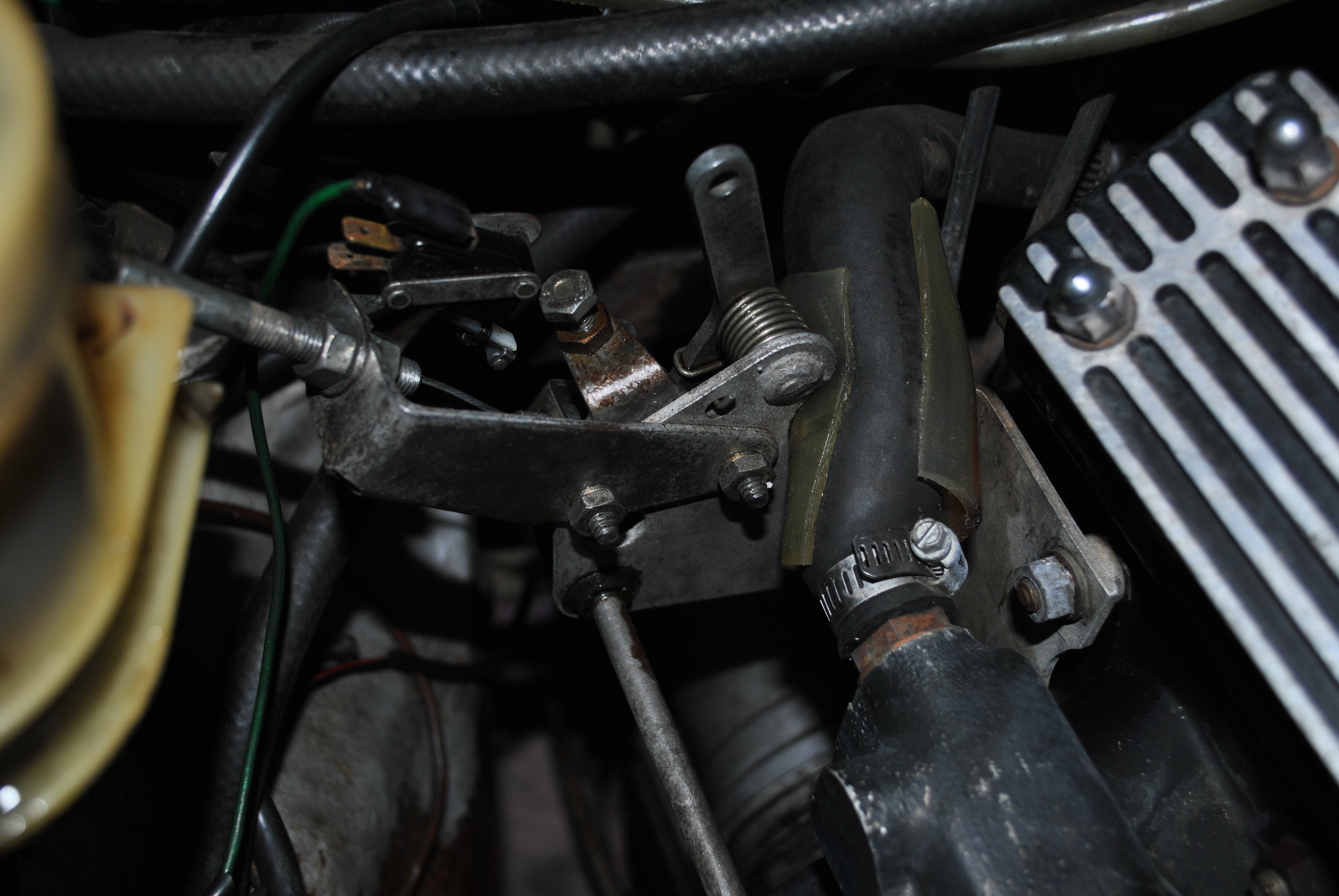

Haha Tony, the second mod I made was putting a momentary push button switch in the ashtray. When I got the car the kick down micro switch on the throttle bracket was squashed and didn't work, after a bit of playing with it( a few days) I ran a wire loop into the cabin and mounted the switch. If I need it to kick down I put my foot down and touch the button, it is great for track days because I can choose when it is going to kick down to second. I wouldn't go back to the micro switch now.
I found the cause of the damaged switch after a few weeks. When I first got the car it had a sticking throttle issue, but only under acceleration up hill when you had to give it a bit from the take off. Really handy when you have a steep drive and enter the garage with stuck accelerator(not). I learnt really fast exactly when to turn the key off.
It turned out to be a broken left engine mount, so when I put my foot down the engine jumped to the right it slammed the throttle linkages into the master cylinder bracket and the cable was getting stuck.
