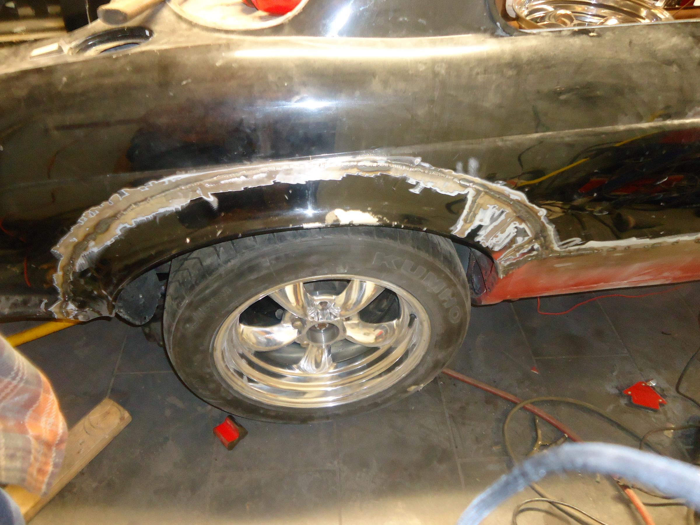

For me...255/50/r17 would not clear stock sheet metal even with tucked in wheels. So out came the metal working tools. The wheel arch was raised 15/16's, flared and extended then blended in to the body so it appears OE. You cant tell from the pictures but the whole rear 1/4 panel has been "fattened" 1 inch. I like the subtle curvaceous look of the **** end even more now.
This is a 27 inch setup, OE is 26. The 255's were the largest size that ticked all the boxes for this build. I wanted to run 275's but the 255/50/r17 has the same contact patch as a 275/40/r18 because of the larger diameter.
The last pict shows the suspension compressed and at the bump stop.
