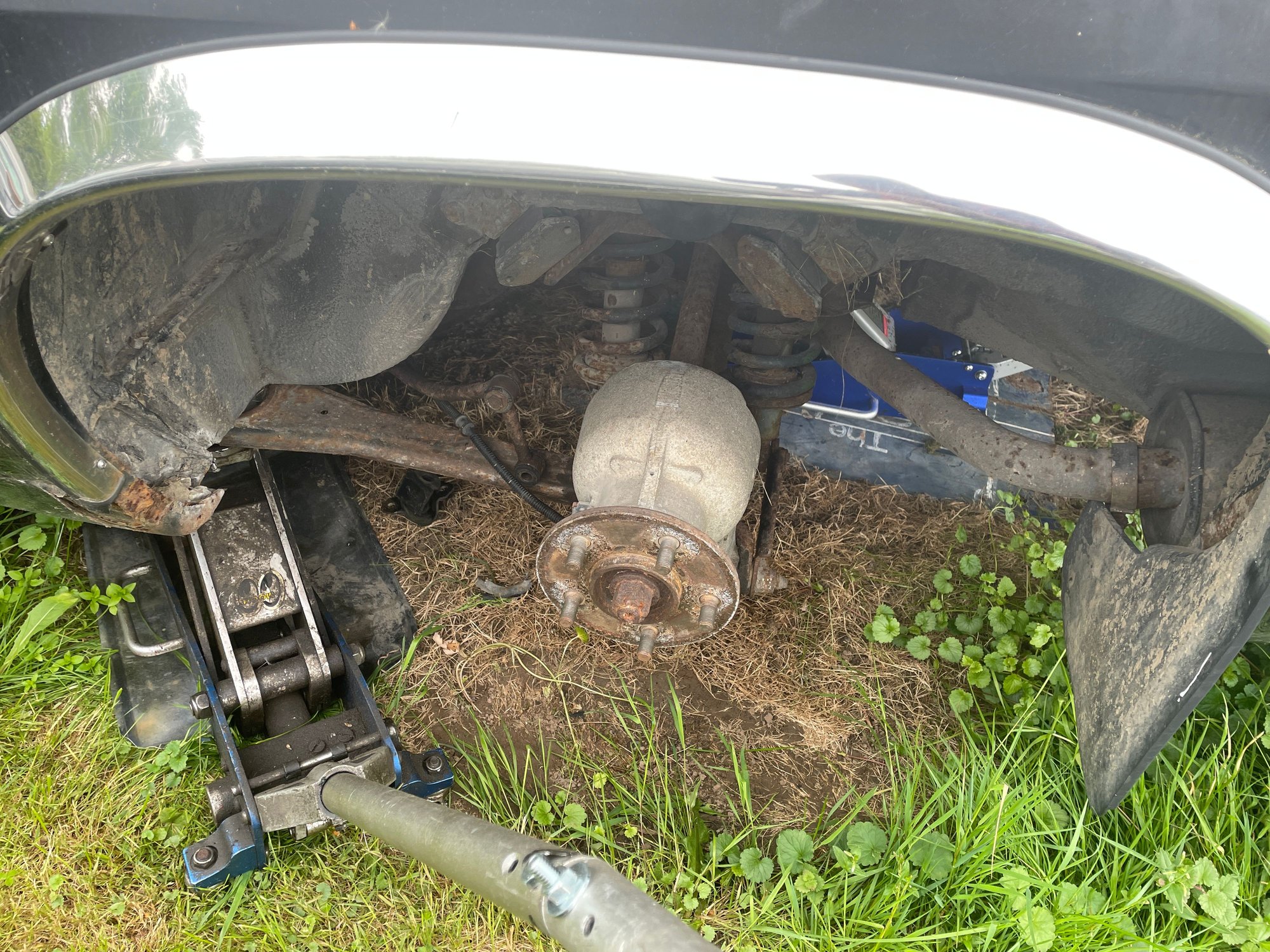

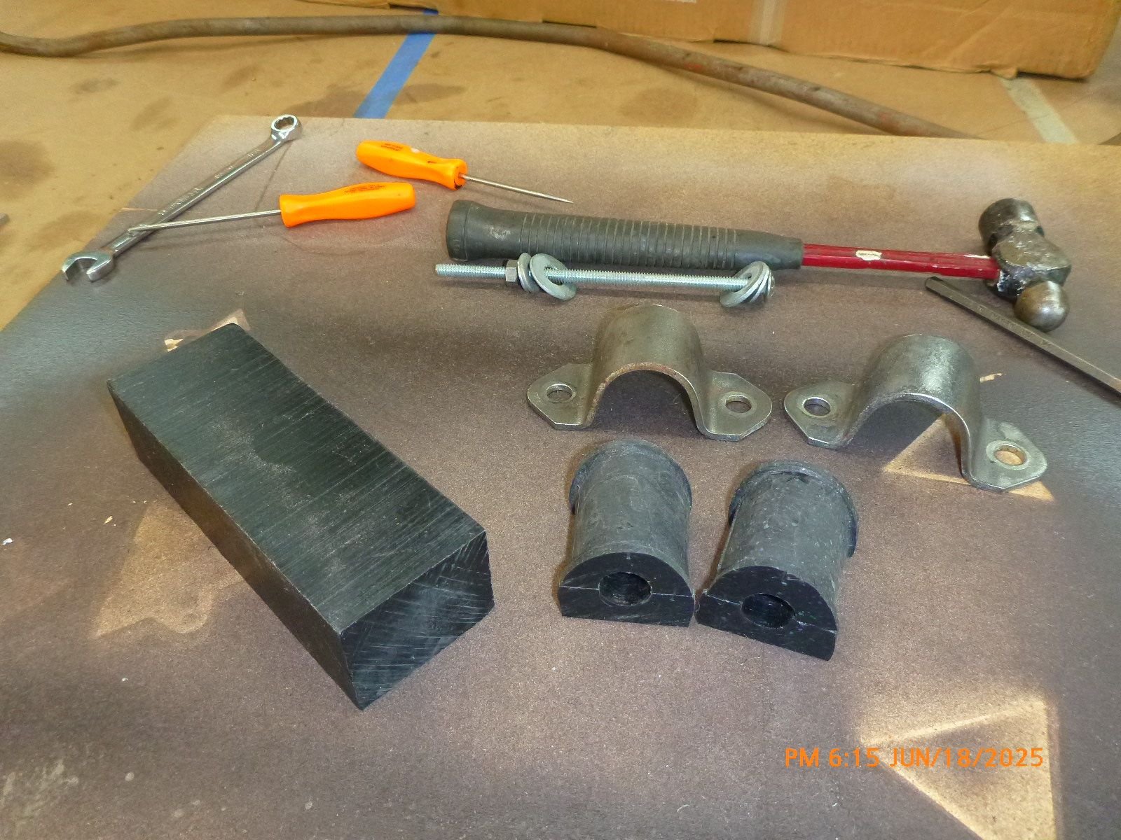

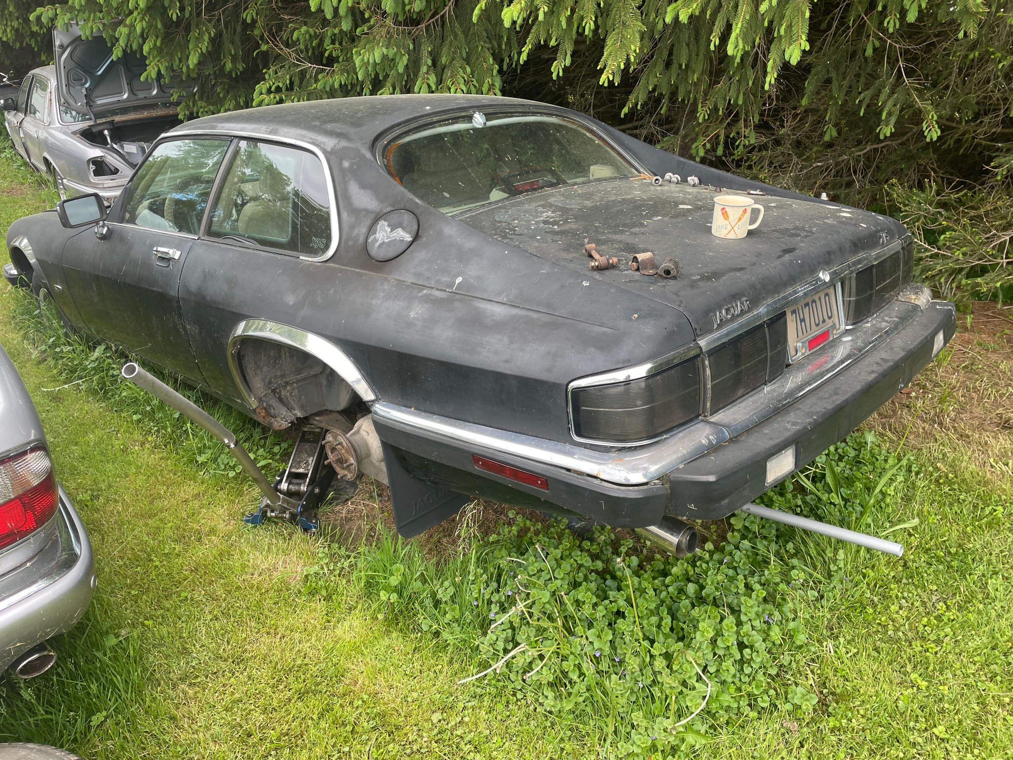

Sway bar showed up a couple days ago, thanks again Rob. Have not been able to find bushings for a 9/16" bar, so I made them. My version of poly units. Drop links are easier, except they all reside on the UK side of the pond. Links are about $18ea and shipping is $45+. I wonder if the lone "tariff deal" our President has managed is in there somewhere. Anyway, here is what I came up with using nothing more than a few odd tools that were laying around the shop. Installation this winter.
Dave

Sway bar rehab complete. End links rebuilt, the astute may recognize where the new bushings came from. Hint: it would be very hot.
Dave
