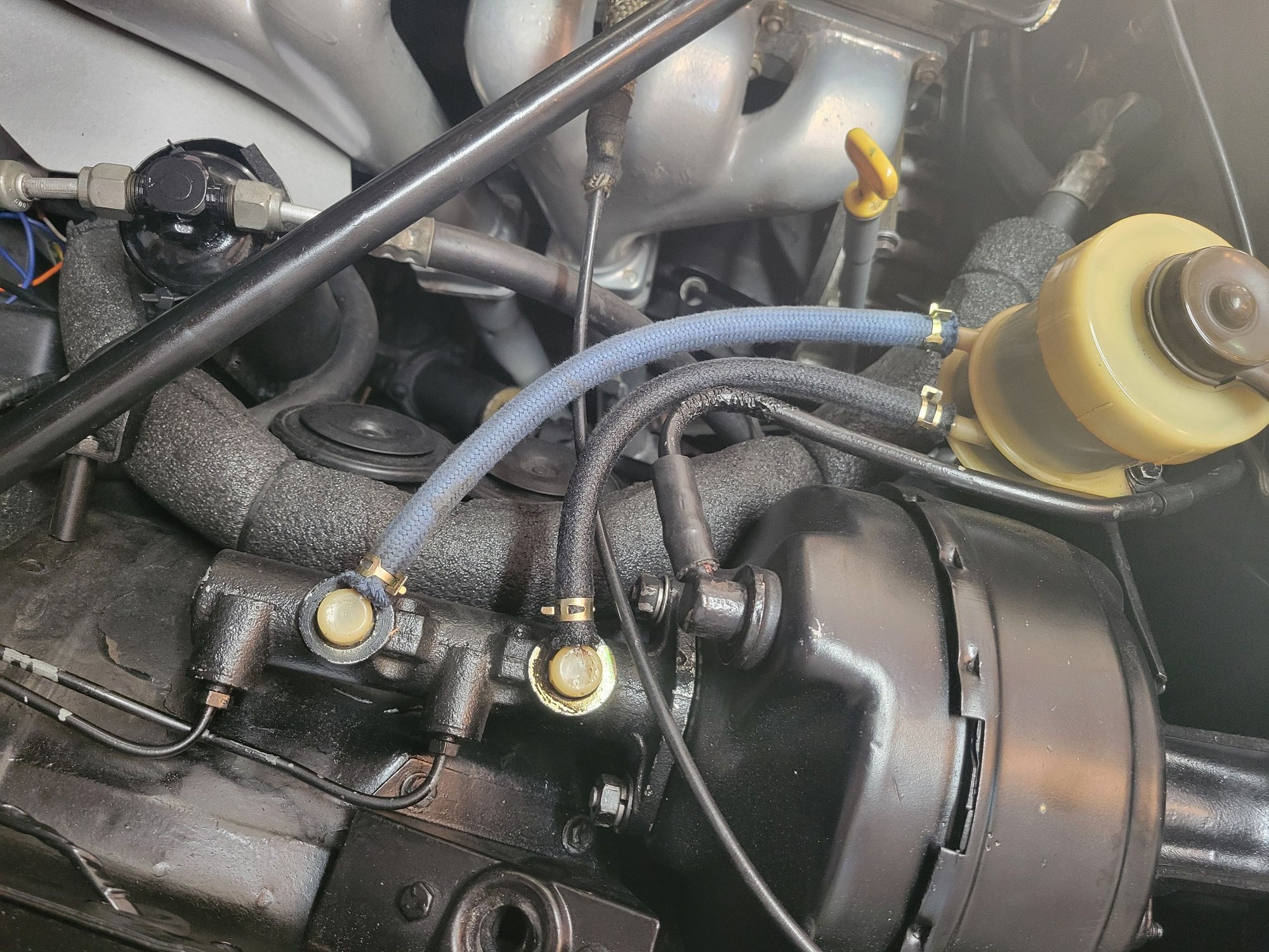

I have to replace my brake hoses attaching from the master brake cylinder and the remote reservoir. Anybody know what size ID these brake hoses are? Mine are weeping.
Many thanks, Bill

Jeff - Good suggestion and I tried David at EverydayXJ and he does not have a used one. And I'm not about to spend over $100 for a new one CAC3217 when I can get brake hose for about $10. I'm just looking for someone who might be able to tell me what the ID is if they know.
Bill

It is 1/4 inch ID.
I used Gates Plant Master 200 hose, compatible with brake fluid.
Rob
