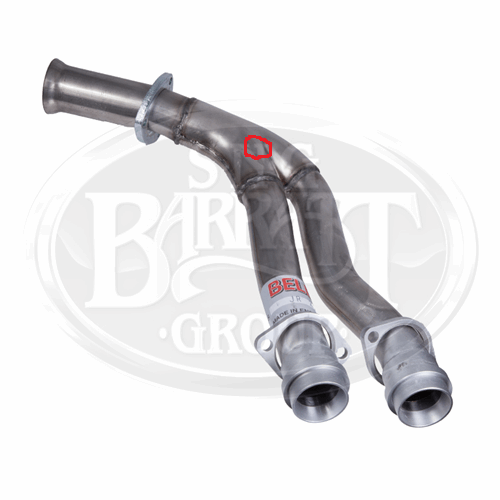

Any recommendations on where to source the downpipes from the manifolds to the "Y" pipe under the car?
Aye,
Chuck
Old Jan 27, 2024 | 07:04 PM
David84XJ6's Avatar
Posts: 782
Likes: 459
From: Central California
Chuck,
There may be cheaper units that are OEM as UK cars didn't have the Cats.
https://www.sngbarratt.com/English(U...OMPONENTS(3265)
Rgds

Hello Doug. Ref. your comment re the Ignition/fuel systems not caring if the cat is there or not, but what about the O2 sensor? Do you just unplug it, or ground the O2 lead? I believe it was Jose that had a mod to add a ground strap to correct a rough idle - I have that strap but have yet to install it. If it does make a difference, then the O2 sensor must be doing something. I'm looking at that SNG Bell non-cat downpipe but have not yet bitten the bullet! Your thoughts?

Any good muffler shop can weld in O2 sensor bung. Make sure to trial fit and mark the spot so the O2 sensor has side clearance. Jose has ground wire mod that will add extra insurance of a good operation.

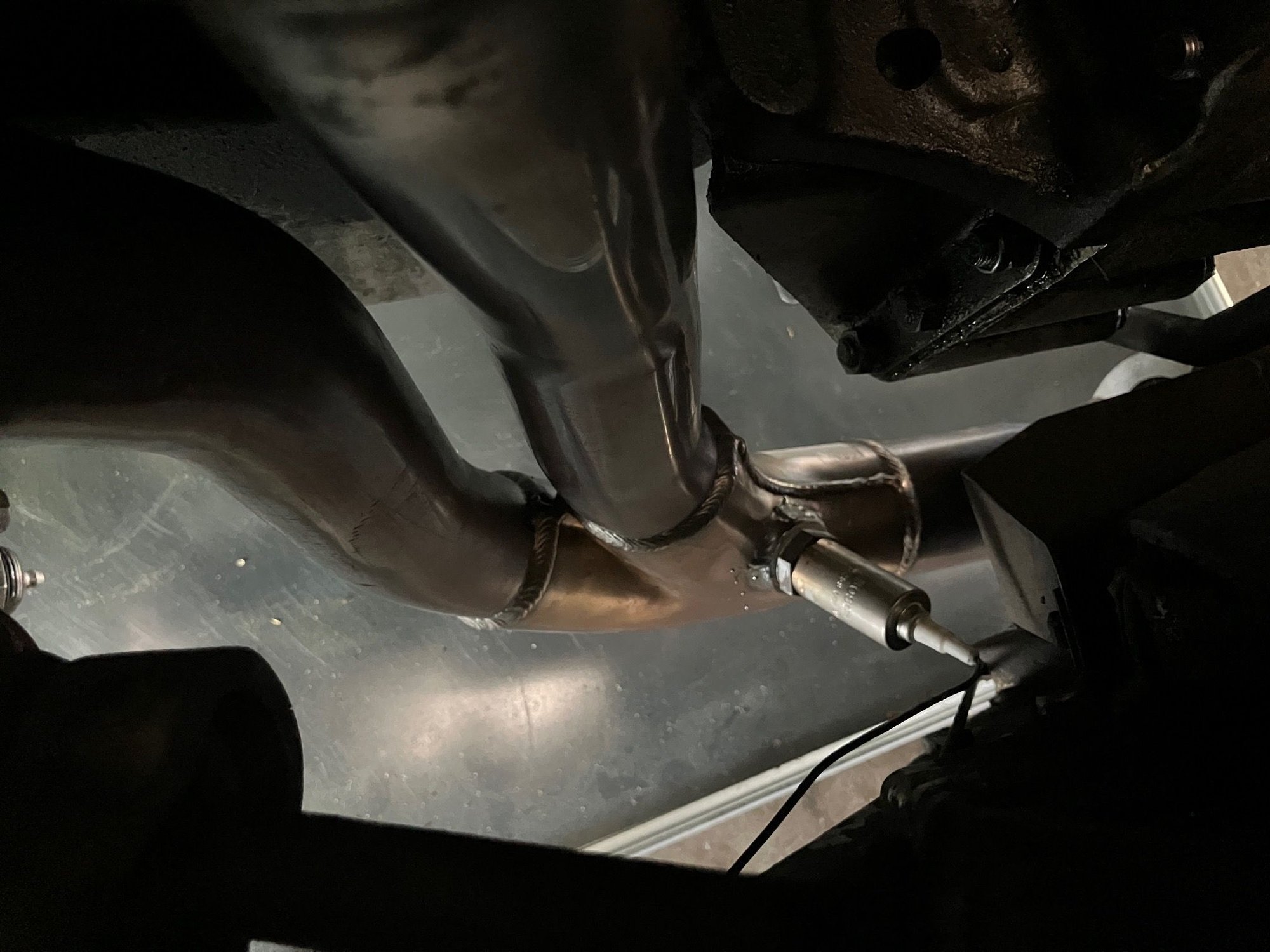

Update - Just got the XJ6 back from having the Cat taken off and the New Downpipe & O2 sensor installed, much improved!
The Cat was very choaked, and now the old car runs much better!
See atached pic.
Cheers to all!

I too have just recieved my Bell Stainless downpipe identical to yours and will have to - as you have done, weld in a boss for the O2 sensor. Are you happy with the sensor location? If you are, I will instruct the welder to install the boss in the position exactly where you have yours. Can the sensor be removed for future replacement without fouling anything? Does the "new" sensor have any drivability/running issues at all, or is it all as usual? Is there a "noticable improvement at all? I have the ground strap mod that I intend ti install also.

Yes I am satisfied with the set-up, I left it to my longtime trusted Jag Mechanic to locate the O2 sensor on the downpipe, the car certainly runs much better because the CatCoverter was mostly clogged!

yes you.must be able to thread and remove the O2 sensor, they don't last forever. The bung must be threaded in my opinion, just like in the factory catalytic.
