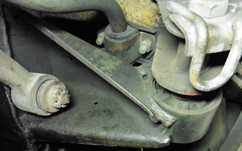

Finally after several days of stressing how I was going to suspend the engine in order to drop the front suspension ( it's being Levitated) parts started coming off today! Everything that comes off requires 4 other things to come off first and they must come off in the correct order so there was a lot of backing up.
But the bushings I can reach don't look all that bad! They're a Tiny bit checked but soft enough I can poke a fingernail in and they give way, but not to the point of being gushy.
The Rack however, is a Complete Mess! It's oily Everywhere; fittings, ends, joints. It will Definitely go to the recyclers. We got another one off the SIII we stripped in the Fall of 2013; husband looked at it today after seeing the one on the car and announced, "That rack is Going to be changed!"
I think I can get to the back side of the pump OK to get the high pressure fitting off. The low side hose is being held on with a fuel line hose clamp. None of those fittings are leaking either, only the ones on the rack itself.
I suppose I should get new hoses too, I can have those made up by the Hydraulic shop in town. All I need to do is take my old hoses and they replicate them.
About the pictures as things are on the car at this moment:
First, outer left side front bushings
Second, inner left side front bushings
Third, outer right side front bushings
Fourth, inner right side front bushings
Fifth picture,left end of the rack
Sixth, Very leaky connections
Seventh, right end of rack

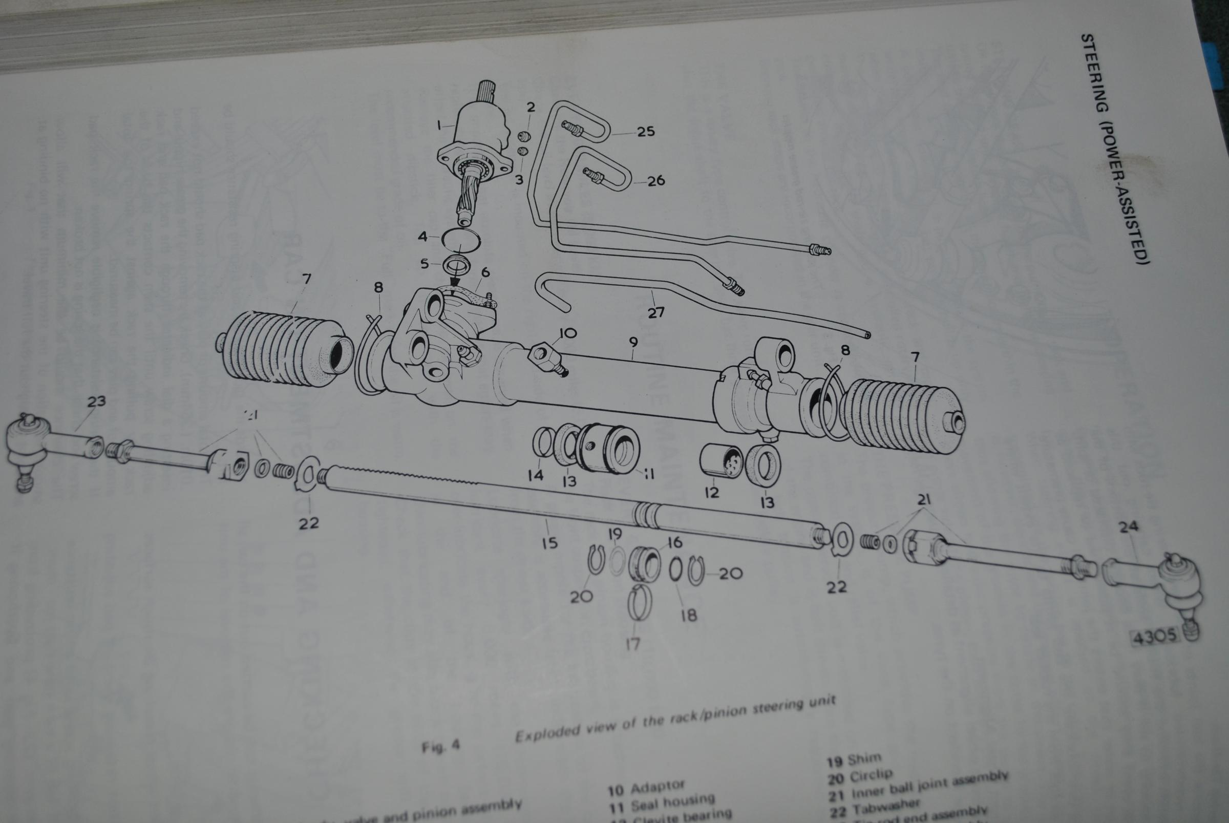

You may need the lower/ bottom series 3 steering column to fit the series 3 rack in.
I'm fairly certain I will need a series 3 lower column for mine when I try to fit my XJS rack.
Thank you, anjum,
We have the Whole Entire steering mechanism from that SIII so that shouldn't be a problem.

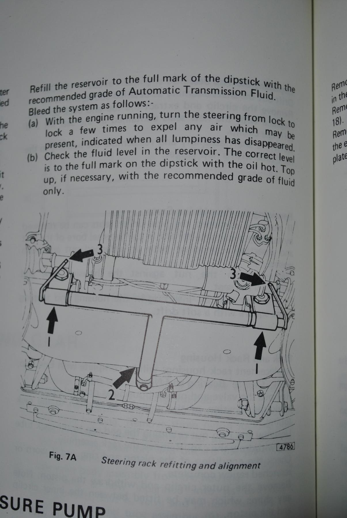

The rack is about 1/4 inch from dropping out on the floor but seems to be stuck on something. Frustration Reigns!
The Book says, "Remove the steering column, upper and lower parts..." first.
I remember what that required last time, while we were stripping the junker; basically take the whole entire dash/instrument panel apart and pull firmly from both ends at once. I *Really* don't want to do that.
Is there some easier way to drop the rack without taking the inside of the car apart again? Because it looks like that has to be done even to change suspension bushings!
And what's this about a Rack Alignment Tool???

Just guessing, as I've not tried that one.
1. The rack is hung up on the sway bar.
2. The upper steering column must come out when replacing an early rack with a later one. Early to early, late to late. A mix is a mismatch.
3. Alignment of the rack is a way of saying that it must be "centered" . I've a vague recollection of removing a nipple and using a pin to find an indentation to align with the hole the nipple was removed from. To assure equal right and left movement
Off to the garage. If it isn't a h.. of a lot warmer than yesterday, back in I come!!!
Carl

I am guessing as well.
The following link says that the lower column needs to be replaced.
RackPinionHeads
It probably doesn't make much difference if you've got the entire column but for me it would help as a lower column is going to be cheaper.
What's the difference in the fitting of the newer column to the newer lower column and the old lower column please?

Carl: Thank you. Husband found instructions somewhere for adjusting the rack position. I haven't read them yet, I have too many other irons in the fire.

The (old) lower column is too short if one changes to a newer rack (SII rack to SIII rack) like we're doing. Everything I've read so far indicates one only needs to have the longer lower column (which is available at Everyday XJ for example and probably other places too) and they bolt right up.
In summery; SIII rack requires SIII lower column. Connections to the upper column and Both versions of lower column appear to be identical. I'll certainly know when I try to connect them.
