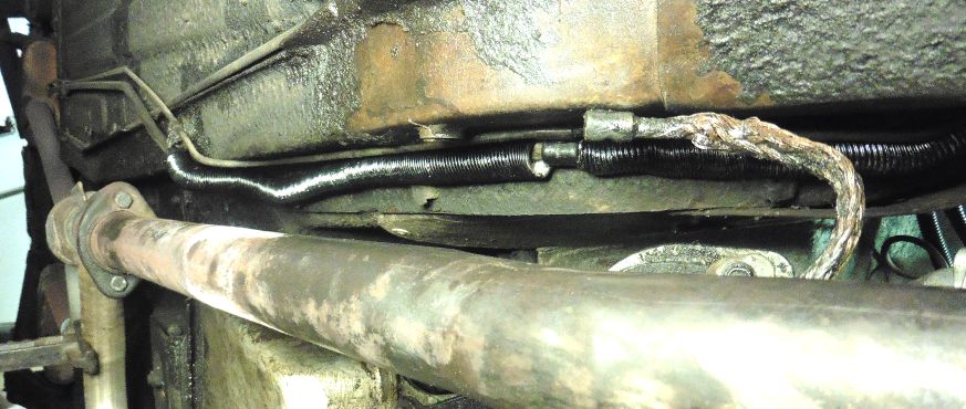

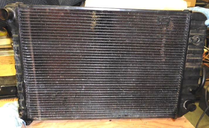

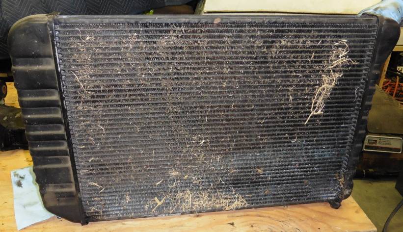

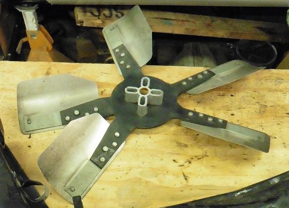

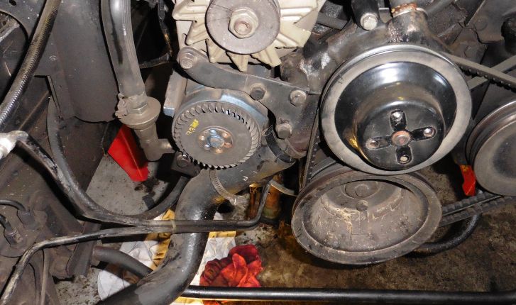

My work is seriously interfering with my car time but this afternoon after I got home I was determined to get the radiator out of Nix.
Under "normal circumstances" (whatever those are) I wouldn't have bothered except that on our last club drive in October we got behind a truck load of rice straw bales which were shedding badly. I stayed a few hundred feet behind and thought I was OK (I had put a screen over the condenser/radiator as there was nothing to keep the bugs and bees out when we go the car), until I checked when we got to our destination and saw that a Lot of straw went Around the condenser and clogged the front of the radiator as you can see in the picture below. I also attached a picture of the back of the rad.
I thought about just blowing all that out, but the shroud made that hard and I would be blowing it into the back of the condenser which seemed kinda dumb, and since Nix was going under for major reconstructive surgery over the Winter anyway I added the radiator to the list.
The ROM says the first thing to do is get an AC specialist to empty the system. No need for that with this V8 conversion because the engine is Several Inches shorter, sits quite farther back and allows the condenser to merely fall forward away from the radiator, and once the custom shroud is loosened, the radiator can then be lifted right out. There was not even the need to remove the fan! However, you DO need to drain the coolant out before loosening any hoses or you'll have One Sweet Mess!

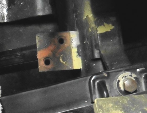

After lifting the radiator out I noticed the fan had only 3 bolts! Really! Not only that, those 3 bolts were holding the fan with only about 4 threads on the very end!! They had Loctite but still...! You can be Sure 4 bolts will go back in, and they'll have more than 4 measly threads into the water pump!

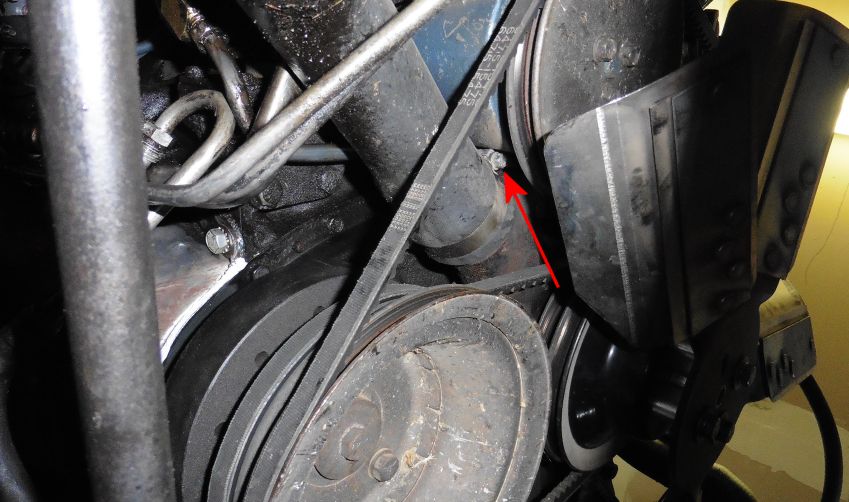

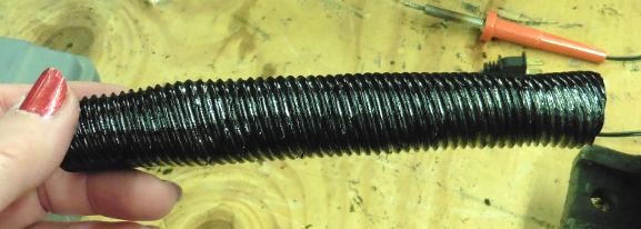

The hoses though, were a Lot of fun! The trans cooler hose had been leaking for a looooooong time and was oozing with a mere touch because the clamp was so tight it had actually cut the hose against the barb in the rad! In fact, had it been under any real pressure the transmission would have run out of oil. (don't ask how I know that) I'm thinking this is a Real Good time to put in a trans cooler (and steering oil cooler) because there's an extra body mount forward of the condenser on each side. (I think they call this Project Creep.)
Soon after she came to live with us Nix blew a heater hose one night in November so we changed all the hoses Except for the bottom radiator hose; Because it was gonna be a Real Dog to get the end off the water pump. We knew it was a time bomb, all the hoses doubtless being the same age, but it was just Too hard to access.
Having the radiator and the front suspension out it was Still a Real Dog to get off, because some IDIOT put the clamp in a place totally Impossible to get to without taking off the air pump pulley (which would be Really difficult with the radiator in place) because the clamp screw was squarely Behind It!!
I could see the screw head, I could touch it, and it seemed like if I just had the right combination of sockets, extensions and swivels I could get it off. Didn't happen.
It was like Absolutely No Thought was given to Ever having to change that hose! I'm wondering how they got it in there in the first place! It Had to have been done at the time of conversion, and they put the hose on the water pump AND THEN put the air pump on! (So that bottom radiator hose Has been on there since 1986!!)
OK, so it came off after a while, with a well placed razor knife to help it along. That clamp situation will be changed when it goes back together, because I fully intend keeping this car long enough to have to change that hose again!
The radiator has 4 rows and is the biggest the JTR manual says can be installed without modifying either the tank or the body. I have No desire to do either of those so I'll have it boiled out and cleaned and put it back in. I'll also change all the belts now that I have such easy access to them, because at the moment, I can almost crawl into the space between the condenser and the front of the engine!
When I put this all back together, I will have a screen across the Entire width of the radiator opening and from bottom to top, so there will be Little chance of straw, bees, flies, mosquitoes, or grass seeds finding their way into the fins of the condenser, the oil coolers of the future or the radiator.

Likes: 2,403
Apologies for the messed up post effort. Al factors lined up against me. I share some guilt, I am sure.
Mission creep can be divided as to voluntary and involuntary. My latest thrash included elements of each But, yahoo, mostly just fine.
I've never thought much of the flex fan thing. Better than pure static. A time to upgrade. Thermo couple fan clutch? or better yet, Efans. My car has the latter. I am very pleased with them.
Yup, my car has a four row brass radiator. Some say the alloys are better and some the opposite. No need to change.
Yup, I've cut more than one hose to get it off. In that spot, I might have gone to a Dremel to cut the clamp's band. But, my "knock off" Dremels are dead. a huge assortment of tools for them. shopping to do?
I like the screen idea. When I lived and worked in the Imperial Valley, many cars used them. Lots of crops, lots of bugs!! Not to mention the chaffe.

Thank you, Carl, (and Clarke and Steve),
I sort of like this flex fan, it seems to be a little stouter than what I grew up with, so to speak, which fans amounted to fiber glass blades and 1/8 inch rods for reinforcement. I heard tales of them letting go at inopportune times and leaving bullet holes in the hood. I think this one is stainless though, so it probably won't come flying apart so easily.
I am thinking of a pusher fan to help out my cooling, which I might need when (not if) I add trans and rack coolers. I've had more than one thermo fan fail on me so I'm a bit bummed on those. It was expensive too! Fortunately it wasn't beastly hot and I was on the open road most of the time.
Where I grew up Everyone has a screen over their radiator and not those rinky dink plastic things you find around here! They were Metal with mounting eyelets in all 4 corners. They were intended to Stop Stuff! At some times of the year grasshoppers are so thick you can't see the road and the windshield is smeared beyond any safe visibility. At night it's moths clogging things up.

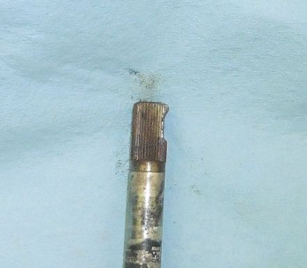

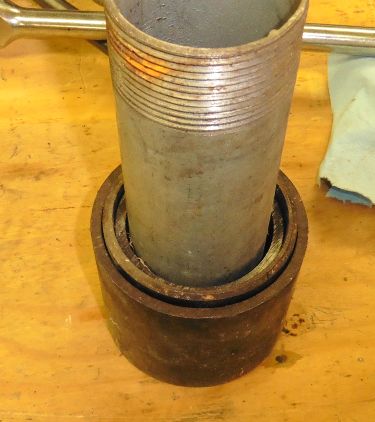

Husband is feeling quite energetic today and wanted to press out the one stub axle before we take the radiator for cleaning.
He found a pipe Just the right size in his collection, which he says I Must show you one day. Had the axle assembly been a mere 2mm longer it wouldn't have fit in the press.

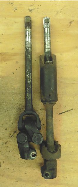

He was pumping about to his limit, probably only 30,000 pounds on the press, when it let go with a Heck of a bang! The press was under so much pressure that when the stub came loose everything he had stacked on the top was unsettled and he spent time picking up stuff that was shaken off.
I wasn't ready for the axle to let go with such a bang or I would have put in my ear plugs. As it is my ears hurt at the moment and ring a bit; probably damaged my hearing which I try to be Very careful about that.
There's quite a difference with the two stubs lying together. The old one is cast iron!! See the casting numbers and the seam!
XAW2748
DDF 10163
No wonder they're so soft! How incredibly inconceivable!! It's quite evident by the colors that the new stubs are steel.

Very interesting. I'd never dream of cast iron as a suitable material for such a critical load bearing piece like a spindle. Usually, the parting line is a clue as to whether it is a forged piece or a cast piece. Thin vs thicker. Trouble is, I forgot which is which.
But, crankshafts come in either cast iron or forged. the former OK for ordinary use, the latter for high performance engines.
And, cast iron in most uses pure iron. Pure ore kinda rare nowadays. A lot of scrap used. This invites impurities. Over come, somewhat by heftiness of the part. But, other materials added. Henry was known for his use of vanadium to make his iron stronger.
Now, any machinist will tell you that automobile blocks are vastly different. And machine easy or hard. Old Hudson and GMC blocks were hard!!!
Son tells me that the few flat head Ford blocks he machined were poor in iron quality.

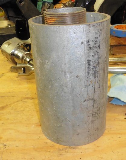

While he was pressing out of the spindle husband said I Must show you his collection of pipes which he uses not only as mandrels but also for bending things into curves.
For bending he usually selects one of a smaller diameter than the curve he wants to compensate for the spring-back.
Those shown below range from 5-1/2 inches diameter down to 1-1/4 inches. The lineup is arranged by descending diameter.
As you can also see they nest very neatly for compact storage.

Neat idea, though. Goes with having a big sturdy press. My son got one from HF.
But, he found it not sturdy enough. cut out some iron and fired up the TIG, and added the bracing it should have had in the first place!!!
Caveat: Should there not be a screen to catch stuff when it lets go?

Default "New" Lower Steering Column
This evening we changed the lower steering column. It sounds Way more frightening than it really is.
First the old short column had to come out. This required removing what are called Pinch Bolts from both upper and lower U-joint, A & B in the picture below.
Mine were not "Pinch" anything because they had Nylocks which I highly recommend there, and so were not excessively tight. It's only necessary that the shafts don't fall apart, although they need to be tight enough so the splines don't slip.
The shaft is held in place by these bolts passing through a groove in the splined part of the shaft as seen below. Upon removal of the bolts the old shaft came right out with a minimum of effort and left its little white collar behind just as it should. However, a little penetrant applied to the splines while still in the U-joint probably didn't hurt anything.
The lower bolts holding the upper column (C & D) also required loosening but not removal. This allowed some 'wiggle room' to get the shafts out and in. The bolts seem to be quite long, I turned them out 1/4 inch with no difficulty.
You can plainly see the difference in length between the old short lower column and the new longer column.
It takes 2 people to put in the new part, obviously, (be sure you don't forget the plastic collar [red arrow] between the boot/gator and U-joint!) and we 'lucked out' because it took only about 10 minutes to get all the parts aligned and they simply slipped together - and the first time was correct and the bolt simply fell into place!
We've been agonizing over this little task since it all came apart. Now I can reassemble the underskuttle and finish up the rest of the interior!!
Attached Thumbnails Rolling Stock:  Safety At Speed-uppercolumnloosened.jpg   Rolling Stock:  Safety At Speed-lowersteeringcolumns-compacted.jpg   Rolling Stock:  Safety At Speed-boltgroove-shaft.jpg   Rolling Stock:  Safety At Speed-newlowercolumninstalled.jpg

Default Thermo Flex Insulating Tubing
That stuff is Awesome!!
I "wrapped" the fuel line with it from the clip at the back clear up to the fuel pump, the entire length that was near the exhaust pipe.
Thermo Flex comes in several diameters in 36 inch lengths. Husband got me 5/8 and 3/4 inch diameter from Summit Racing.
http://www.summitracing.com/search?S...=thermo%20flex
I discovered also, if you absolutely positively can't loosen the gas line to put it through the tubing, Thermo Flex can be sliced along its length, opened up, slid onto the gas line and closed again.
It comes a bit compacted and can be stretched or worked around curves with ease. It cuts easily with a razor knife or shop scissors; I wouldn't advise wife's sewing scissors.
Attached Thumbnails Rolling Stock:  Safety At Speed-pastexhaustpipe.jpg   Rolling Stock:  Safety At Speed-thermoflex-pump.jpg   Rolling Stock:  Safety At Speed-compacted.jpg   Rolling Stock:  Safety At Speed-extended.jpg   Rolling Stock:  Safety At Speed-curved.jpg
Rolling Stock:  Safety At Speed-split.jpg
