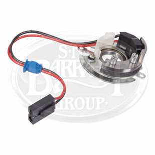

If you are planning to work on distributor yourself, there is another possibility Inside the distributor; there is ground wire or a spring wiper that makes the ground between the moving advance mechanisms. If you have the spring wiper it may be having poor contact at end of its movement, a good cleaning of wiper tack with electrical spray cleaner and application of dielectric grease, may solve the problem. If you decide to change the base plate, SNG Barret has the pickup and base plate as an assembly. Pick-Up and Base Plate Assembly Fits XJ6 S3 and 1 more Original Equipment Supplier Product Code: AEU1500 $190.
