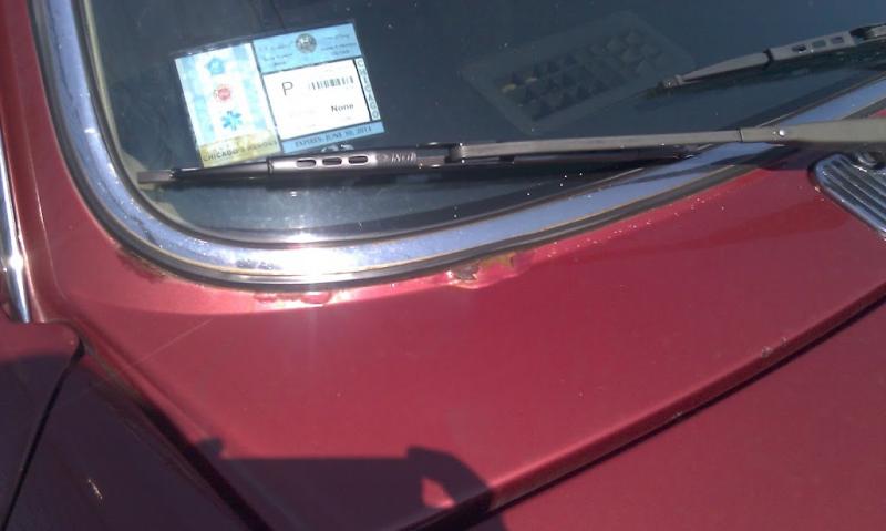

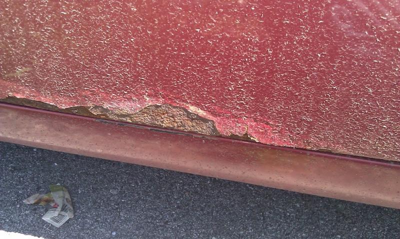

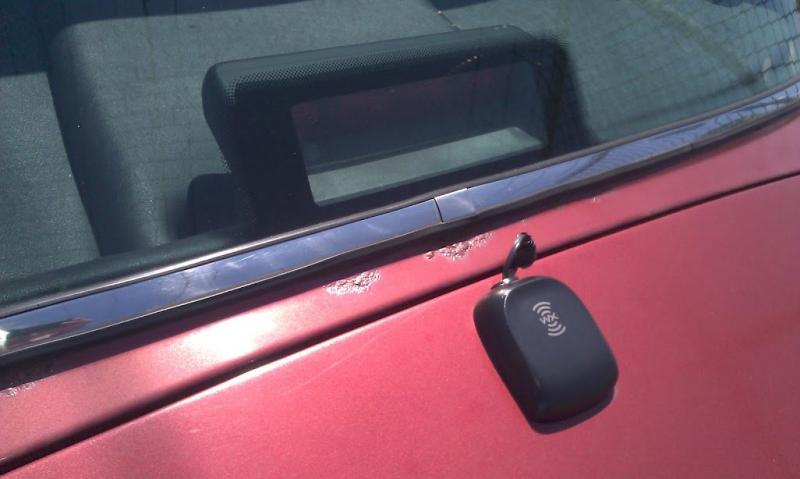

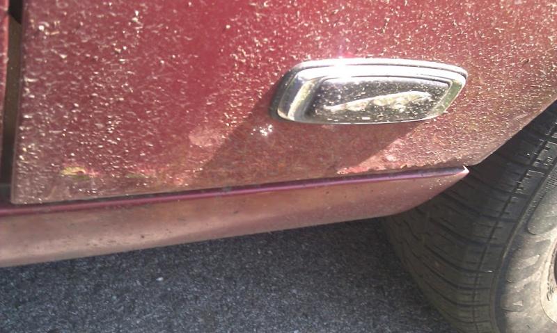

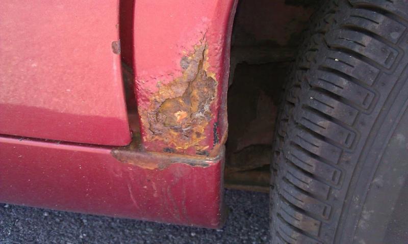

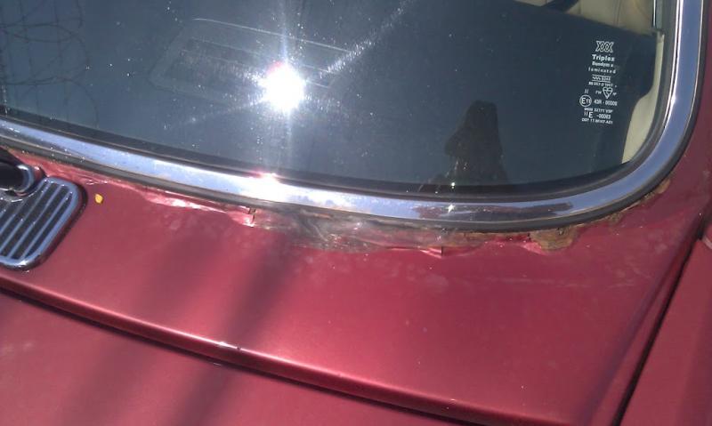

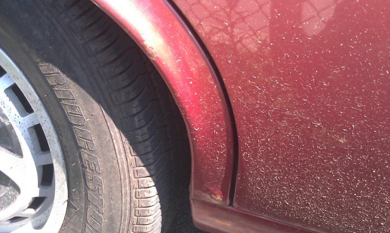

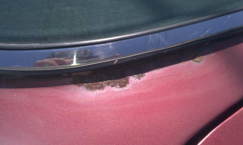

Hey guys, I was wondering if any one has any tips for taking care of us rust. When I bought the car I didn't mind the rust so much because I was really looking for a cheap car and rust is common on cars around here.
However now that I've fallen in love with the car I'd like to do something to stop what I can, and try and at least clean up some of these rust spots.
I've attached some pictures of the problem. It has problems basically in these spots: front and rear windshields, front passenger side door, and right behind the drivers side rear door.
I know the windshield problems are common on these cars; and one of the spots I was hoping I'd be able to grind away/sand/primer, bondo, and repaint. However the the passenger side door really concerns me the most. I know cutting it out and welding it is probably the best option, however I don't know how to weld or have a welder. I've also thought about searching the junk yards and looking for another door, however I think that if I'm going to do that then I better take care of the rest of it too.
I was just wondering if anyone has had any success removing rust on their own cars or any suggestions. Thank you.

you,ve got some serious work ahead of you. <br />
1. grind metal back with an 80 grit disc until rust free, replace metal as needed. welding up holes wont last.<br />
2. treat new and old metal to rust converter, the type that takes 24 hours and turns the bare metal blackish.<br />
3. prime with epoxy primer and repaint<br />
4. solve water issues with new glass seals and undercoatin inside wheelwells

Your car looks seriously rusty. The rear wheel arch area in front of the wheel is a very common area, and you really need to check the condition of the sill below it as this is where the rear radius arm mounts up. The front screen aperture is very bad and will need the screen removing and welding new metal into the aperture, and same for rear screen.
A rusty door is not too serious, as it doesn't affect roadworthiness. Try to find a good used one if you can. Door skins may be available, but the main pressing will also need repair.

you need to think hard and consider that you can get a non-rusted southern or western car for less money than it will cost you to fix that one right.
keep that one for spare parts, buy one that is not rusted, you'll fall in love the same way.

Thanks for all the suggestions guys, I think I might try and tackle the rocker panel myself, and I'm going to get estimates on the windshields (maybe see if I can find someone on craigslist) and then I'll probably have to just ignore the problem for a while.
I would get another car but I don't even have a garage for this one and like I said I only bought it because it was cheap.
If I ever get the windshield problem taken care of then I'll look at the door. Maybe if I get a garage I can try tackle the other problems myself too, I've wanted to learn how to weld, it'll just be a while.
