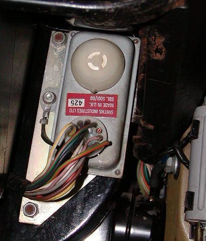

I can't speak for '77 but '76 has a Very annoying buzzer that made itself known soon after I got the car.
I found the component over above the Passenger's knee, very near the glove box up under the dash. Has about 30 wires going to it.
No one could tell me how to fix it at the time so I unplugged the lot.
Oil warning, High beam still work on the panel as if nothing else changed.

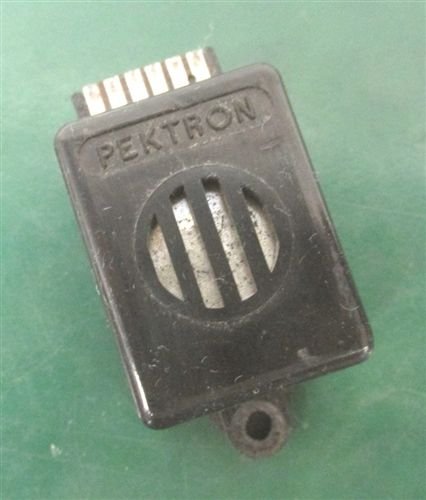

‘For the curious in the US this is it.

FTR, Series III owners similarly annoyed will find the same Pektron buzzer on their cars as well....'cept it'll be on the LH component panel.

1. Did not know the cars had a belt warning light!!! PO must have silenced it at the time he disconnected the ignition buzzer!!! I will leave that as it is silent
2., I did reconnect the igntion buzzer. Somehow, i don't mind it!!! Did not like the dangling wire!!
