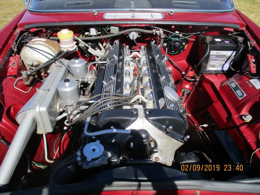

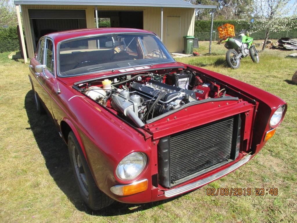

My series 1 is almost ready for the road. Suspension, brake system, top end of engine, etc., all re-built. I can drive it around my son's yard - he has an acre of grassed paddock. The main fault at present which makes me reluctant to put it on road is with the BW12 transmission. The car was last on the road in 2001, and it was Ok then. 5 years ago it moved 15 miles under its own power to the present location. Transmission takes a long time (5 seconds or so) to build up drive. Very clunky on the shift from 1st to 2nd. Oil level seems high in the pan yet I have not even put back as much oil as I drained out! I think the pump must not be charging the torque converter properly. Can this happen?
Any ideas on this fault?

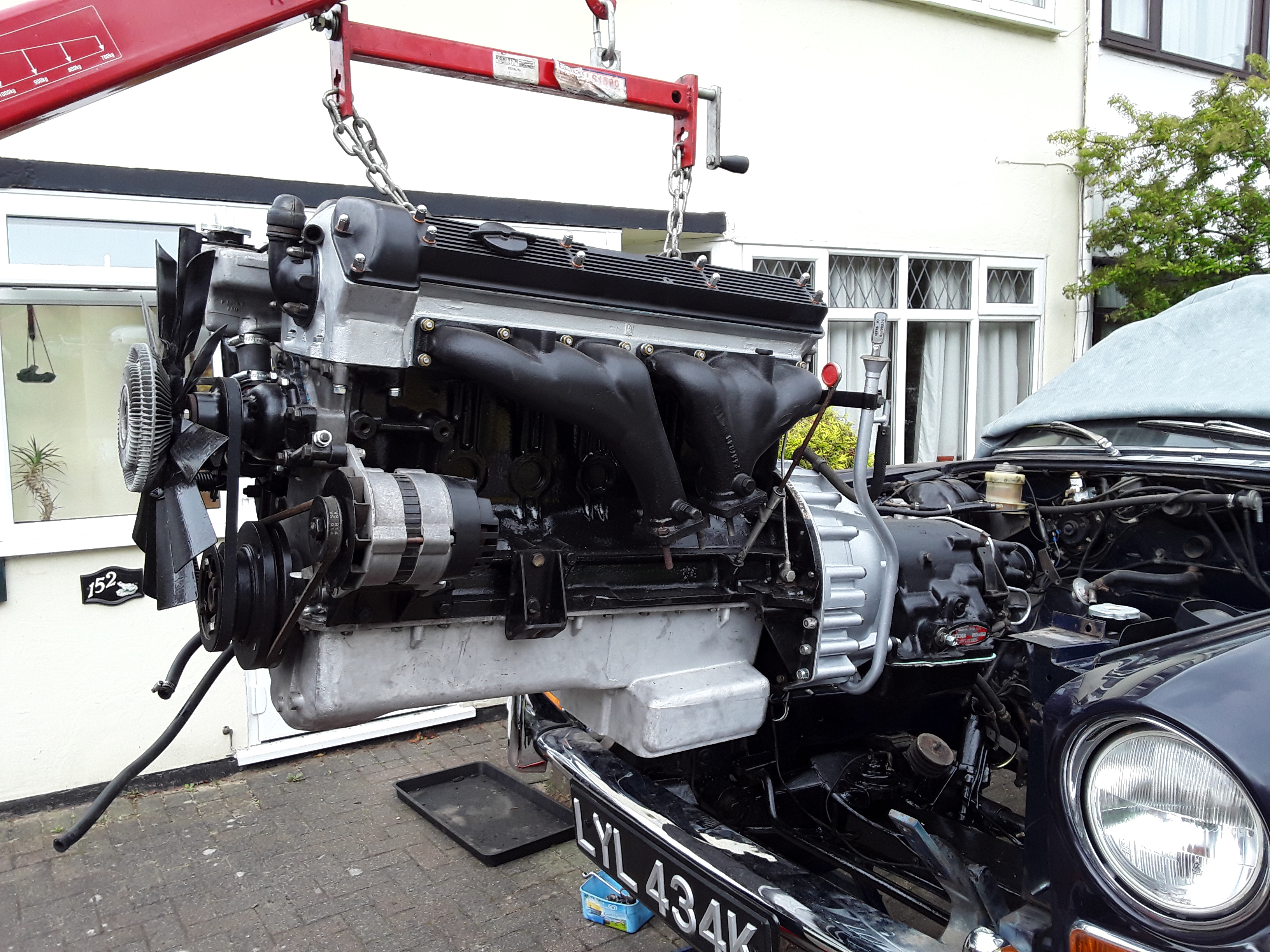

I had to carry out some engine work on my XJ this summer so decided to get the Model 12 box looked at by a local auto specialist. It had been very sloppy in operation and leaked badly.They replaced all the brake bands, clutches and seals, the torque converter was cut open, cleaned and rewelded and balanced. Total cost for reference was £1200 including VAT. I didn't think that was too bad as I've had thirty three years out of it with only the odd oil change.

That engine transmission unit looks really neat Nigel. That price seems good for all the transmission work. I am surprised they could not just source a new torque converter - have these also become an rare spare?
I drove my car 15 miles today to move it into my garage at home. Once warm it ran very nicely - up to 80mph on the highway. No leaks from cooling system, transmission, perhaps a small weep around the oil filter. Fixing the handbrake and bonnet latches is next on the agenda.
