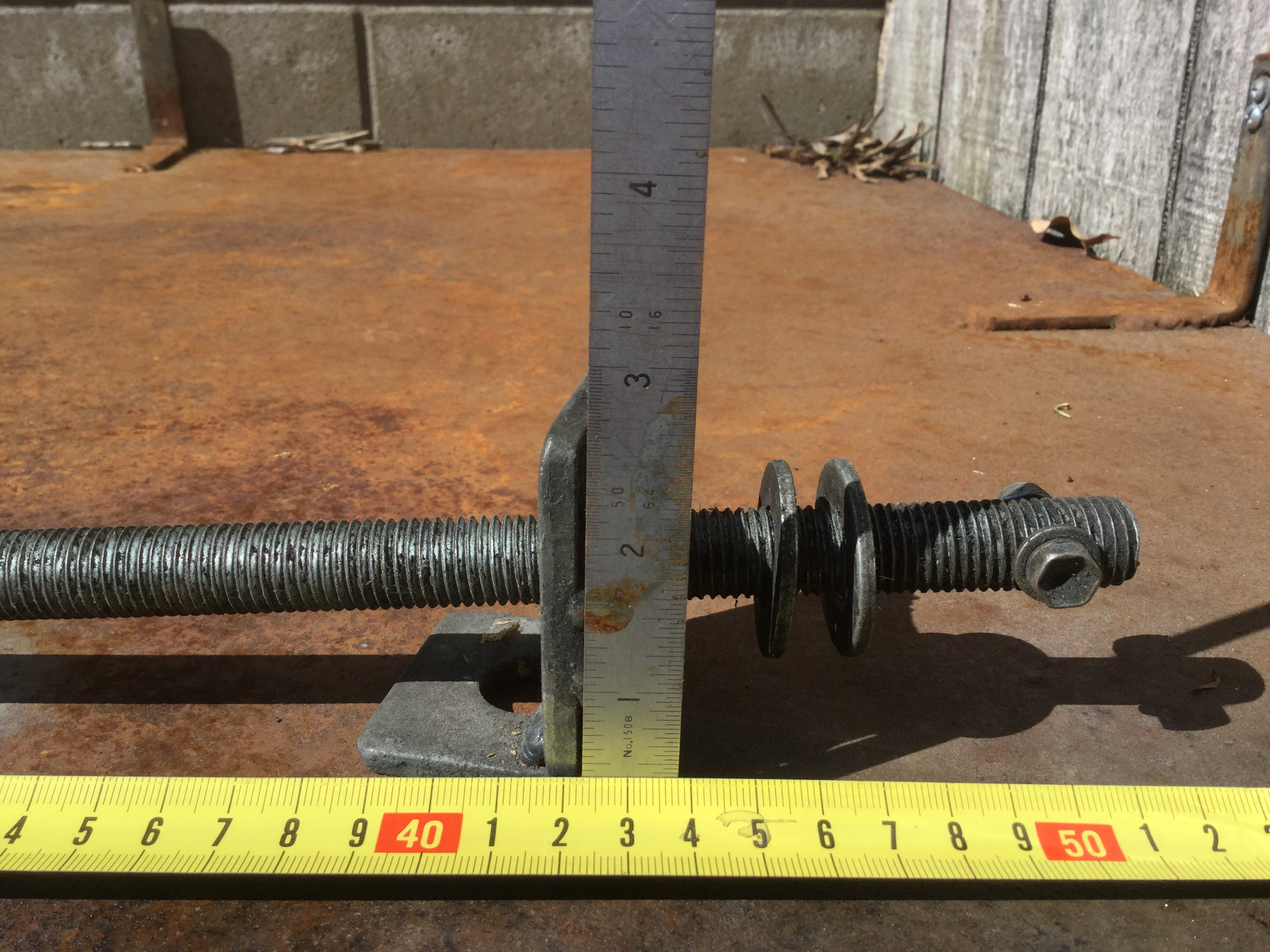

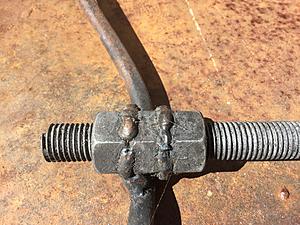

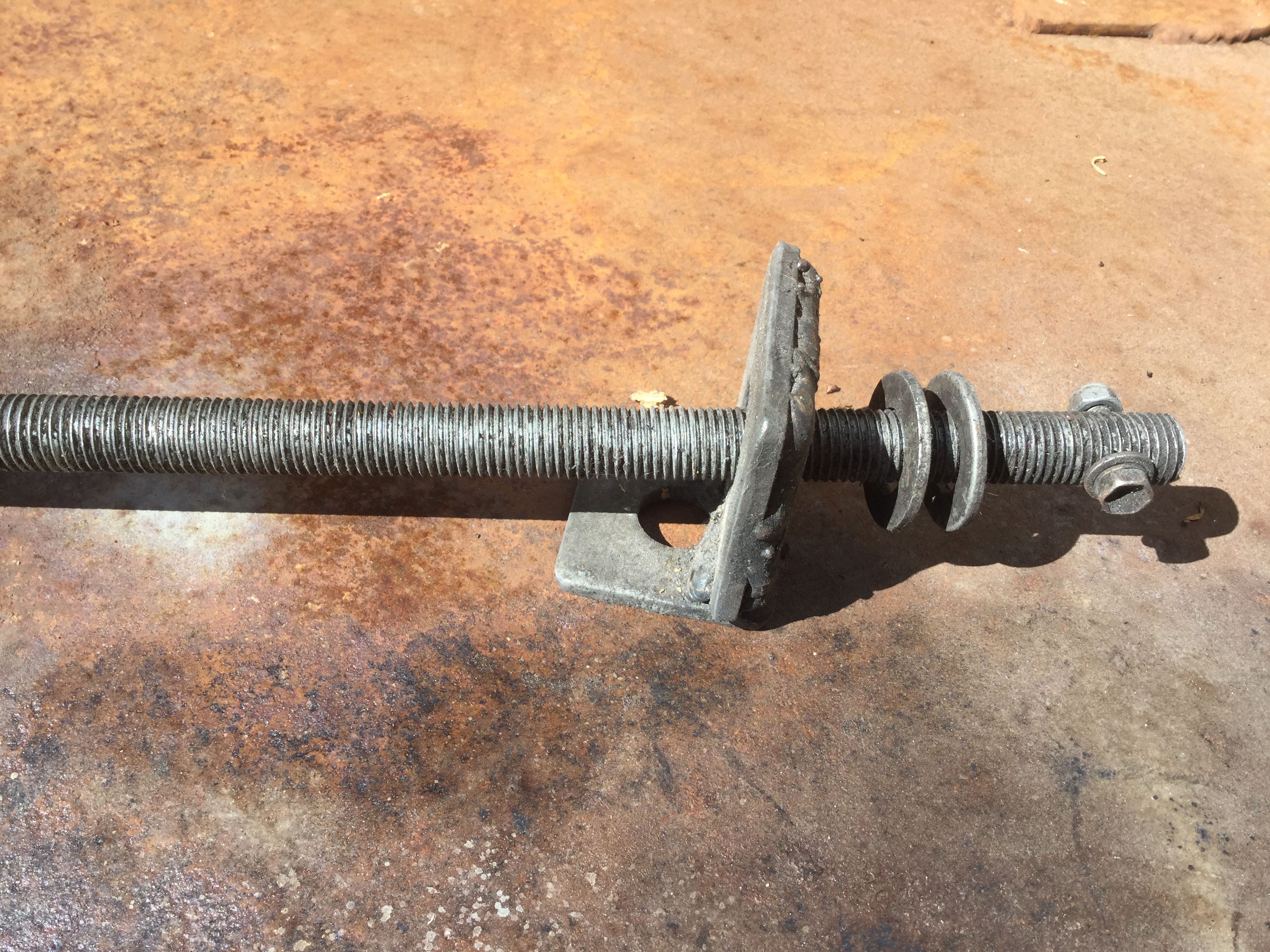

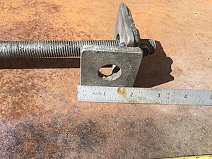

The XJ40 ball joint is a bolt on and forget it item, no more shimming one poster suggested prying back the boot to inject a little bit more grease in but I never bothered when I replaced mine.
Here are photos of my home made spring compressor;
Series 1 - front ball joints & suspension-5e3d4a13-e52b-432a-9c4c-4e021f782878.jpeg
Series 1 - front ball joints & suspension-6df46c3e-95b5-4497-8dad-b6962f51cb84.jpeg
Series 1 - front ball joints & suspension-7b8b38c7-e11e-4193-8d4e-0fb4740f36c5.jpeg
Series 1 - front ball joints & suspension-32191d6b-47f1-4dc6-aa82-57099fc100b1.jpeg
Series 1 - front ball joints & suspension-8b7745d4-87f9-467f-8025-66e224545106.jpeg
Series 1 - front ball joints & suspension-96ada15e-9e3a-4c1a-9fef-2eb74296df2c.jpeg
