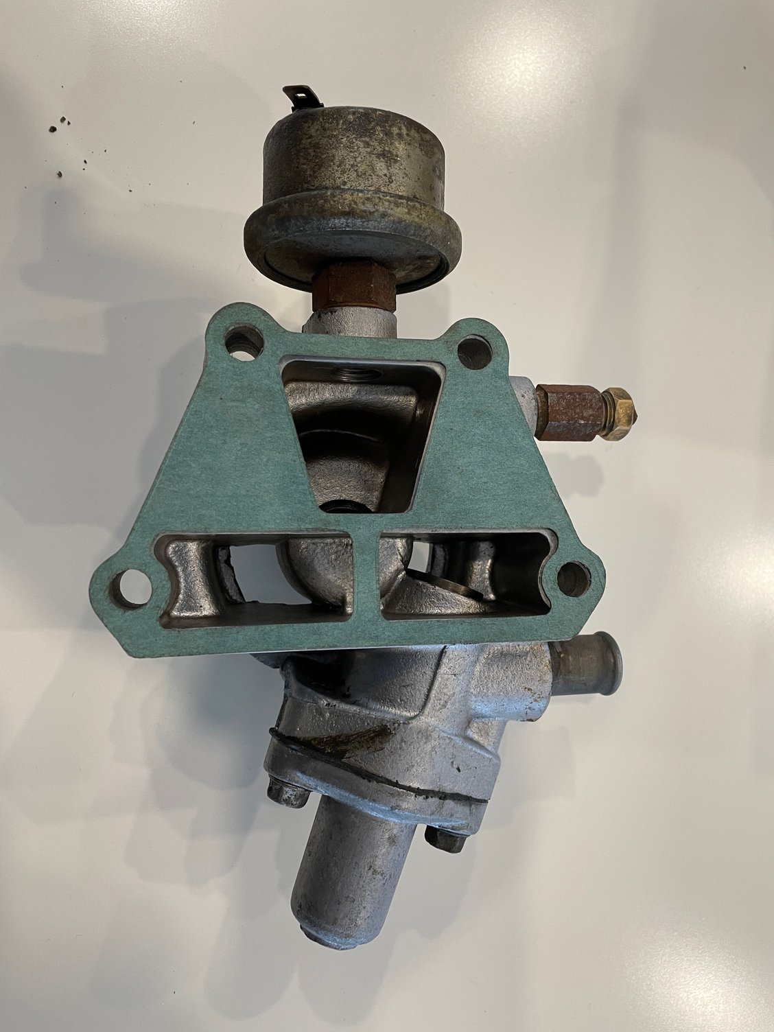

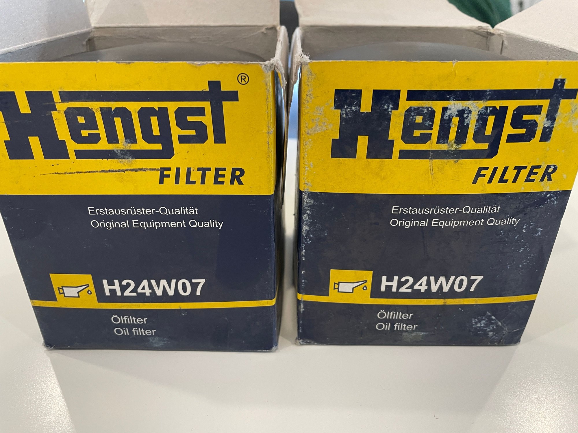

Hello,
I have this left from my 38 years of driving S1's.
This is all you need for the spin on conversion.
The small outlet would have to be blocked. It is for the later
style oil to cam feed line, but yours has this line off the block on the exhaust side, so the feed is not required.
New gasket, and 2 new filters.
$125 US plus post.
I can get a postal quote if I have a zip.
Thanks,
Rob
