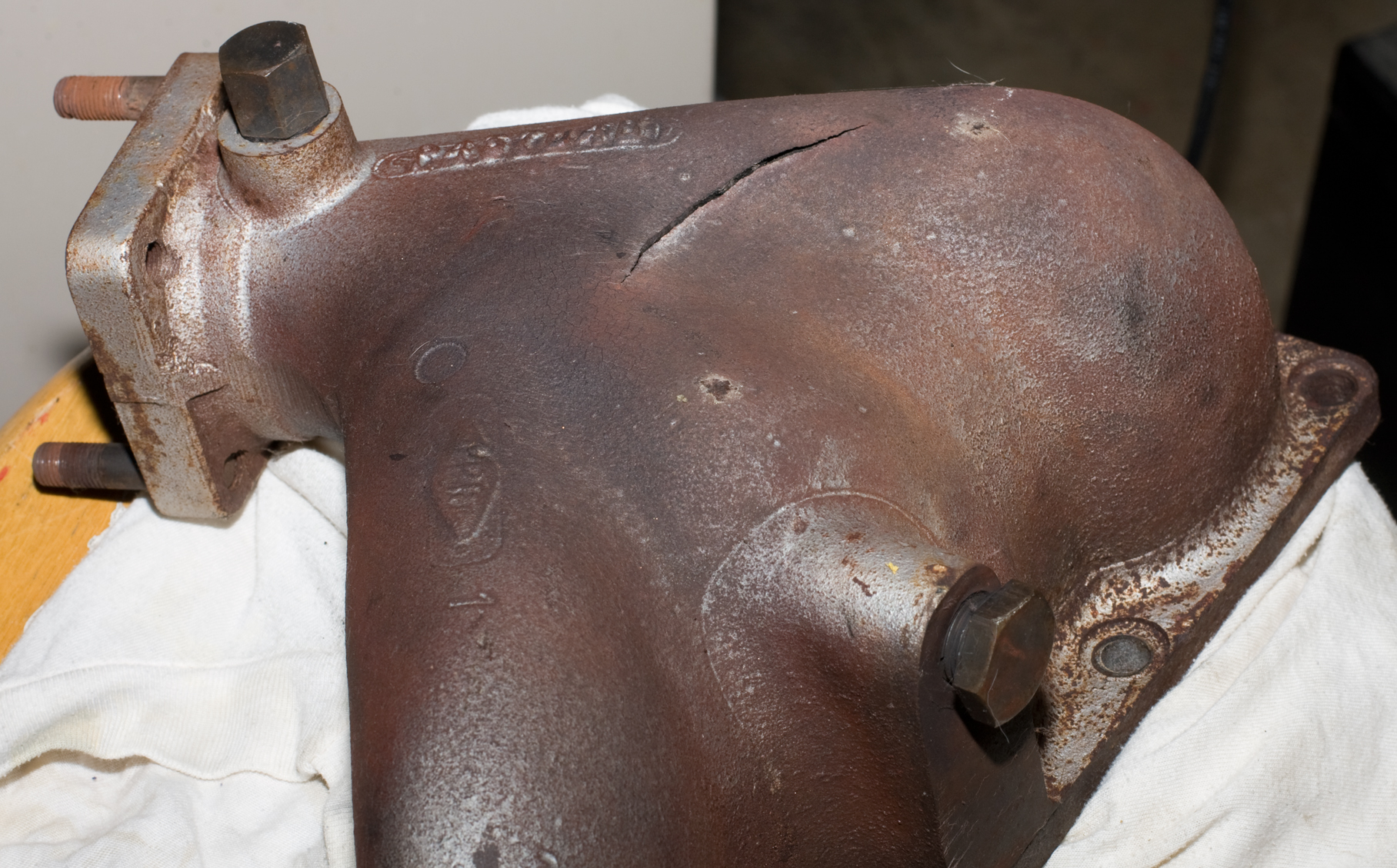

I have a nice crack in mine, too. Some day I'm going to borrow one of those cameras on a stick and see if it really goes all the way through--maybe it's just a surface crack.
