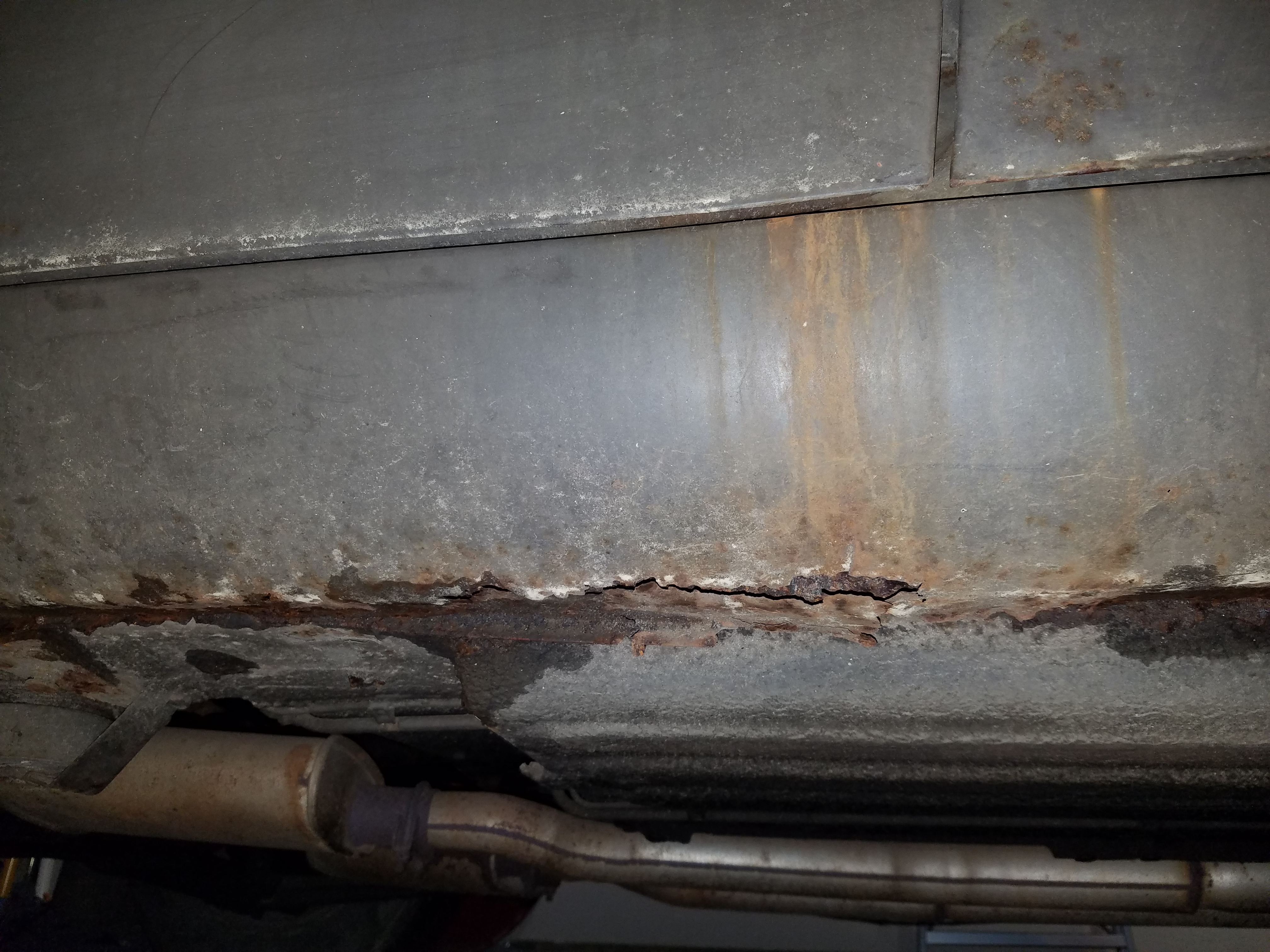

Did the series 1 jag ever have a luggage rack. I didn't think so but my uncle found one with the jaguar stuff and thought it went with it. See pics.
Also attached is the worst rust spots pics, hand brake cable, and seat pics.

From here, your worst problem looks like all that rust in the rocker panels. Those are structural, and sort of keep the car from folding in half. Pull up the driver's carpet and have a look at the floor pan.

Before you dump a load of time and money into that car, take all the seats and carpet out and take a good honest look at the floors and rockers. It's neither easy nor cheap to replace all of that, and every inch of it is critical to body integrity. I replaced a LOT of metal under my '74 and don't even want to think of what it cost. Be honest with yourself about your goals and abilities working with these cars.

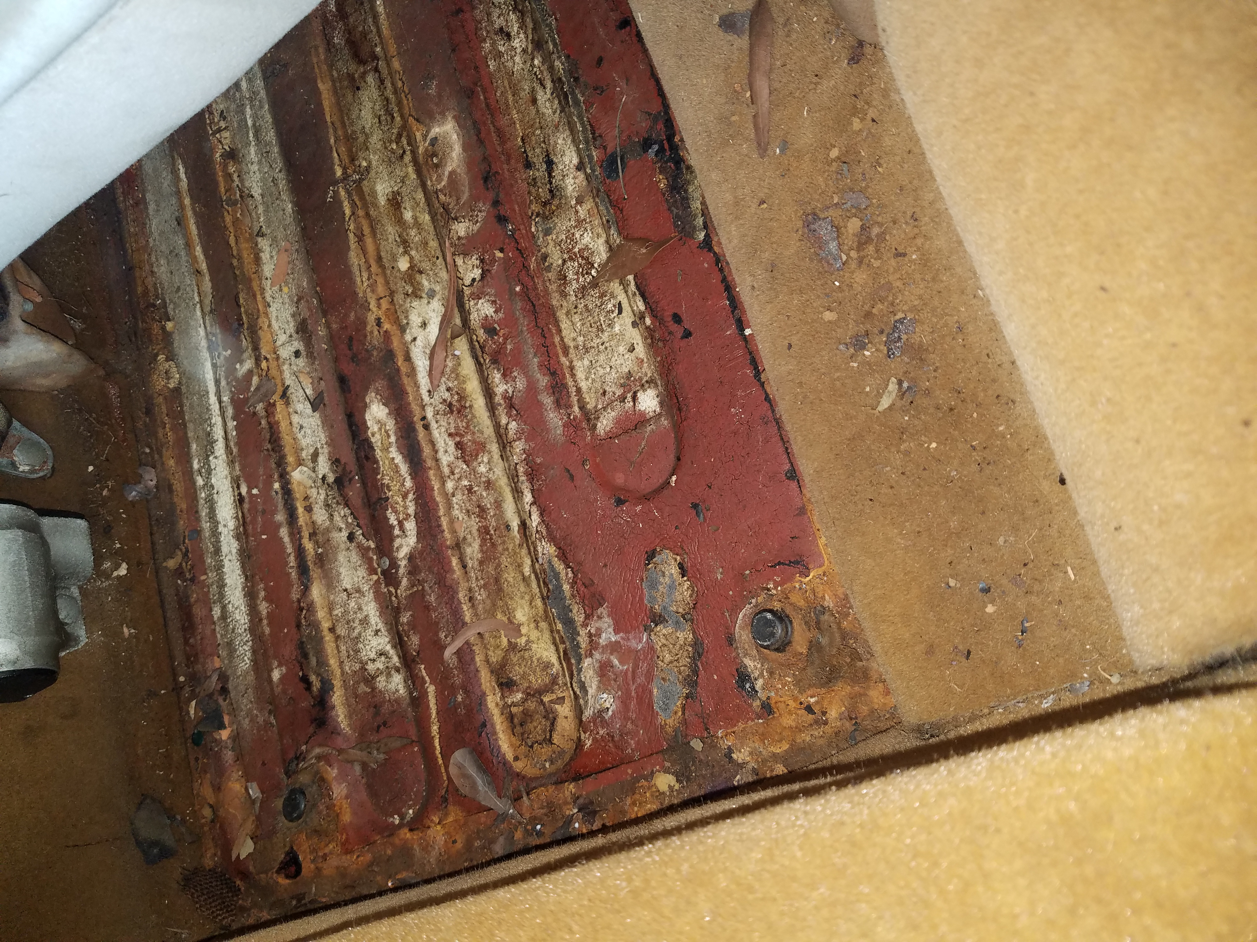

I took the rear seat and carpets out this morning to take a better look at the floor. There is rust but it looks but it doesn't look bad besides at the pedals of both front seats and in the cavities of the rear seats. The rest of the floor looks OK at first glance. I'm going to try and get someone else to look at this with me that has more experience to tell me an honest opinion.
