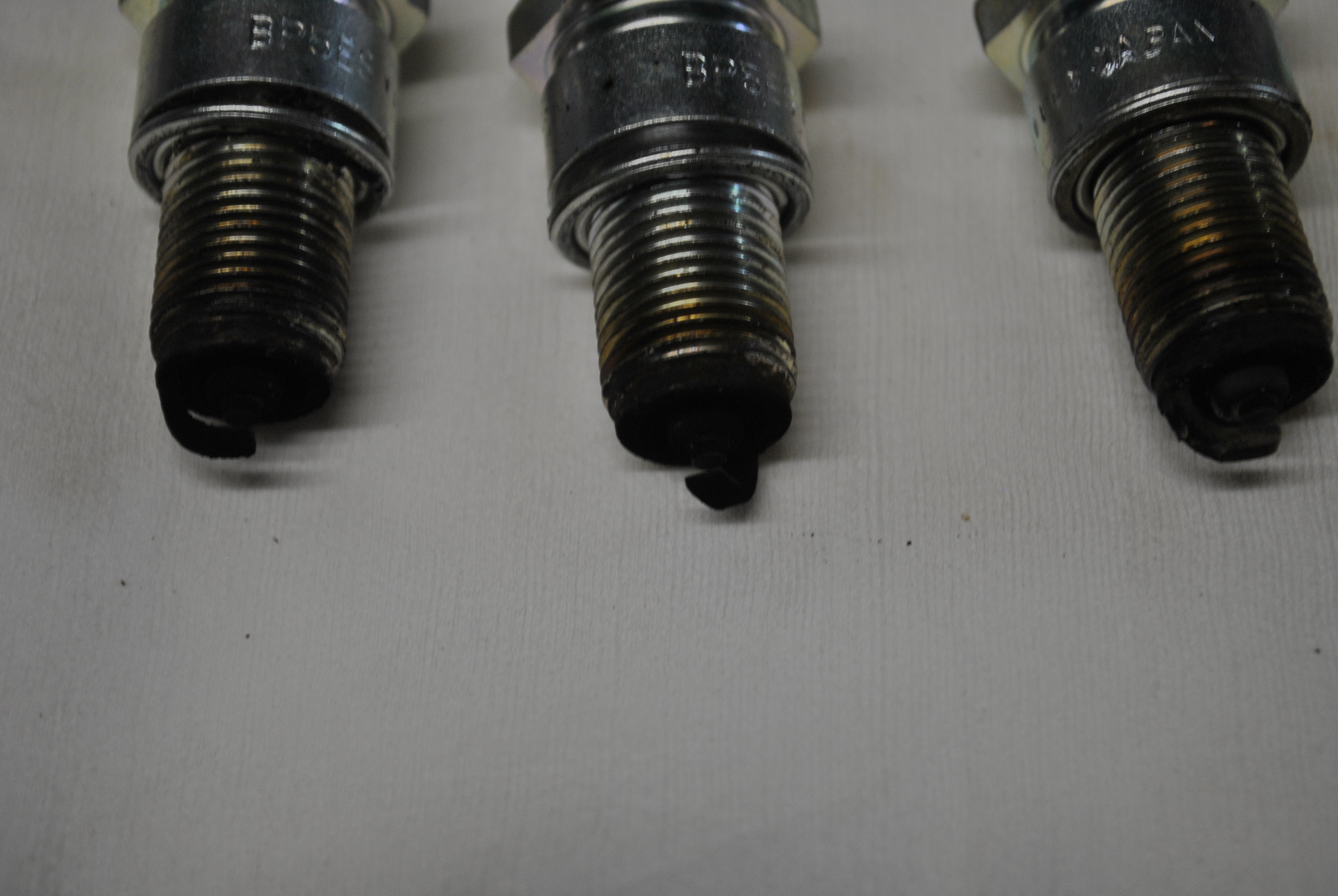

This issue keeps coming and going, runs good for a few days then has a couple of bad days then runs well again. Last few days have been bad. Usually at it's worst when the engine isn't up to running temp
Today I decided I would go back to base settings on the carby's and give them a tune again. All seemed good for a bit. I left it to cool down then it started stalling again on the next try, and idle was up and down again.
Pulled the plugs and found this.
Rear 3
Front 3
Going by that it tells me the rear carby is rich, but just being tuned today it shouldn't be. The only thing we haven't played with is the chokes so had a bit of a poke around there and found the the fast idle cam on the rear carby was sticking sometimes leaving the jet pushed down to the full rich position.
After a bit of playing around I discovered the cam on both chokes are slightly different, the rear one has a sharper lobe on it, the front one is more curved. Causing the rear carby cam to get caught on the stop screw when the cable was fully extended. Therefore the rear carby was running on full choke.

I adjusted the stop screws further back so the cam isn't fouling, just means pulling choke further out to engage it.
I hope I'm onto something here, had a good test drive and will test again tomorrow.

A stuck jet in any position down when at operating temp, would blacken those plugs.
You have more than likely sorted it. Well done.

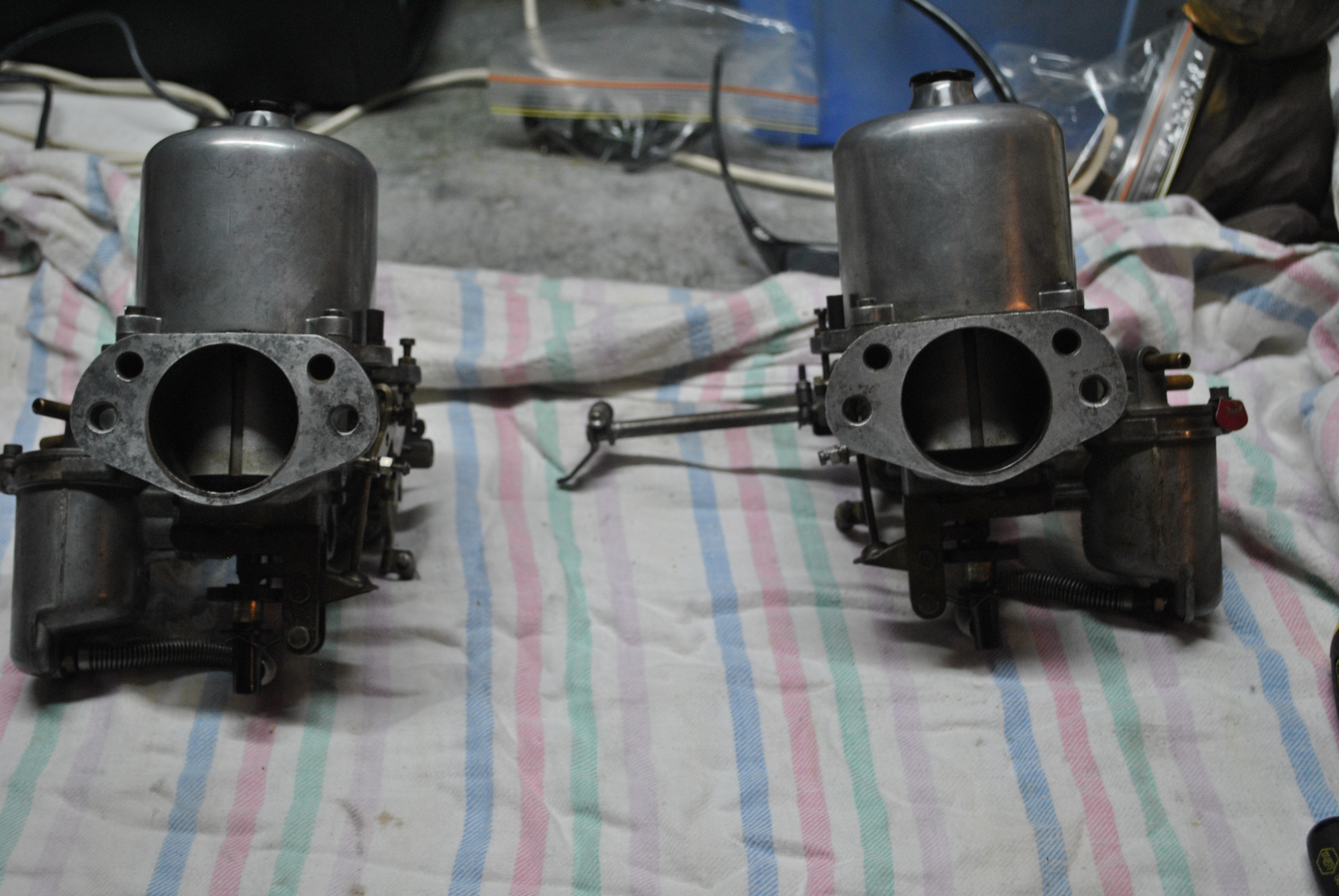

They are HS8's Steve, from what I read you are correct. The biggest problem is at idle and mostly when not up to running temp. Usually when coming to a near stop then accelerating off again, if you stop for long enough like a red light it splutters and recovers itself before driving off.
Needles, Jets, floats, (and needle & seat) were replaced about 20k ago as were all the o-rings and gaskets.

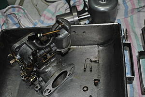

Still dramas the last couple of days, so today I pulled the carby's off and took everything apart for a clean and see if there was anything not quite right. Everything seemed ok but replaced the o-rings, split pins and washers while I was at it.
Put it all back together and reset, mixture, idle and chokes again. Ran sweet. (as it has the last few times everything has been set at running temp) I will see how a cold start goes tomorrow.

Ah, I misunderstood the problem. Thought you were chasing rich running rather than idle/stalling. The only other thought around idle maybe is wear in the butterfly valve shaft bushes, and sucking to much air at idle.
