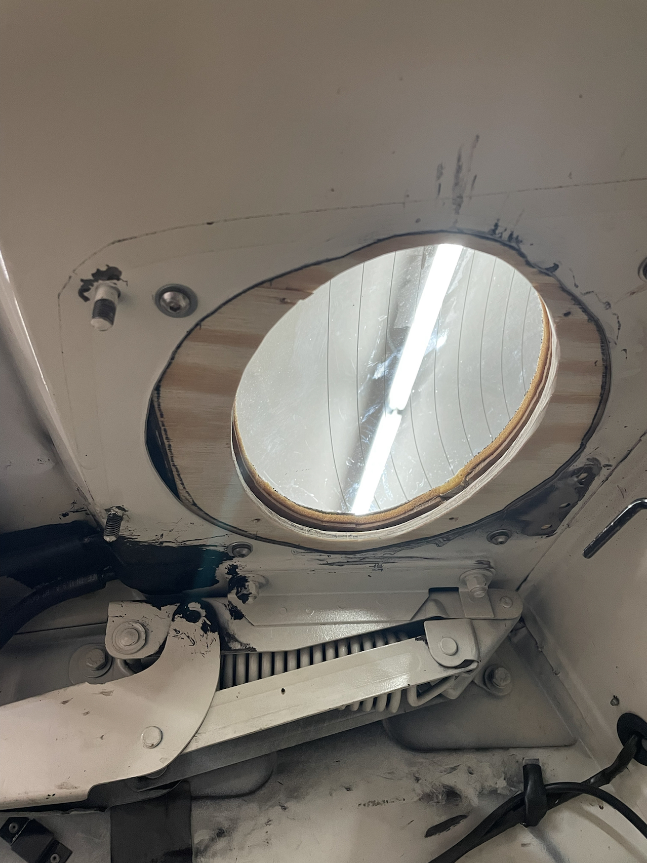

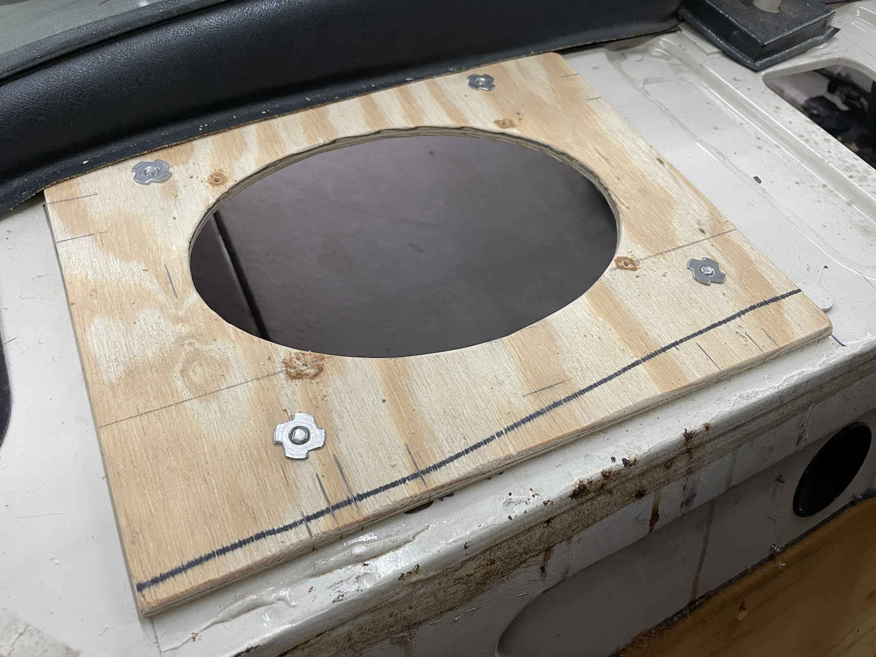

Water pan is still intact. If I did anything over I would make the speaker mounts out of thinner acrylic they had at the stereo shop. Speakers are 6x9. Air sawed out the round indents first, speakers fit between the pan & hinge .

Never sure if pictures attach
Attached Thumbnails Speakers in the back window-photo592.jpg   Speakers in the back window-photo821.jpg   Speakers in the back window-photo795.jpg   Speakers in the back window-photo679.jpg   Speakers in the back window-photo988.jpg
Speakers in the back window-photo989.jpg   Speakers in the back window-photo666.jpg   Speakers in the back window-photo763.jpg   Speakers in the back window-photo888.jpg

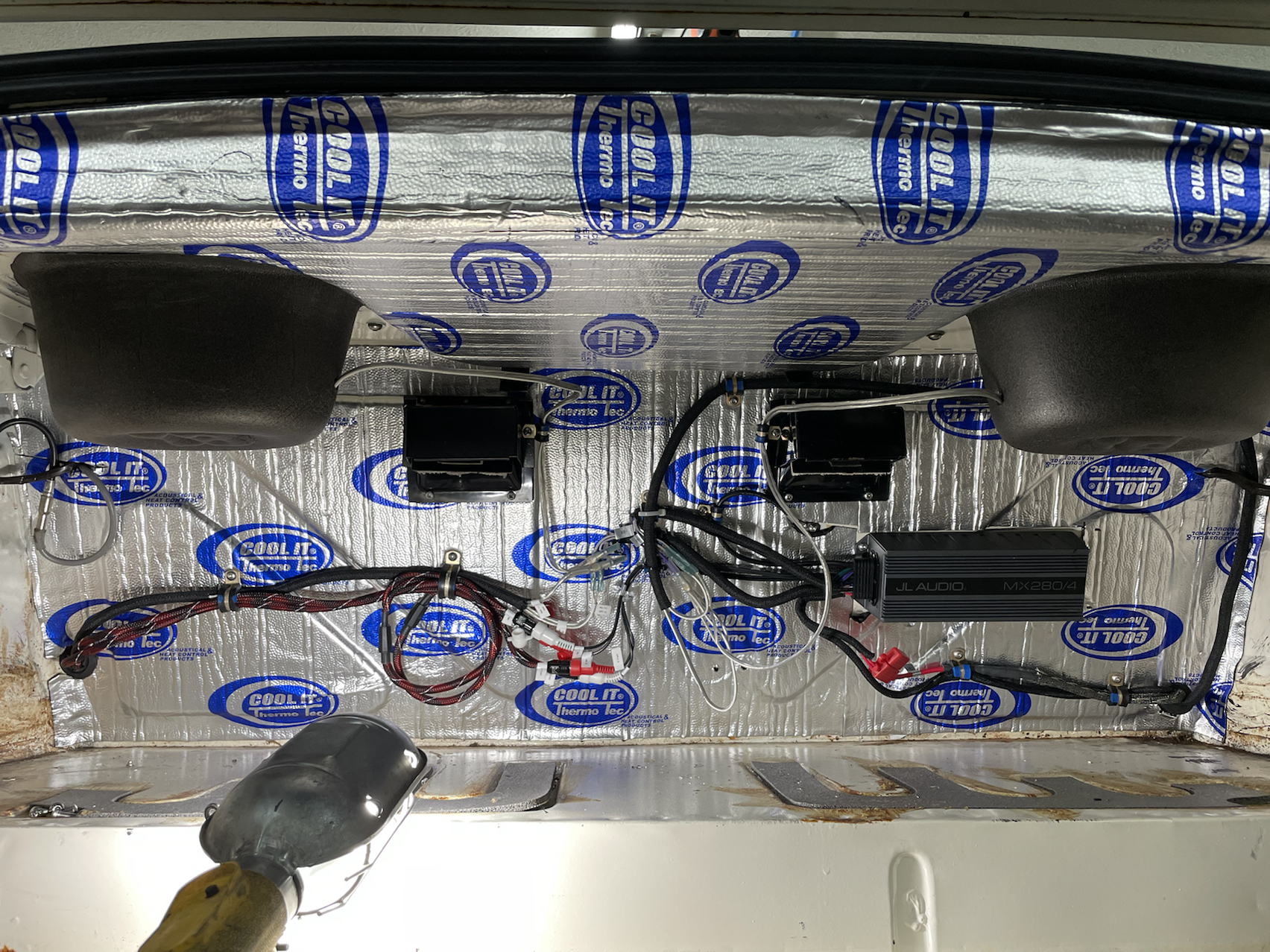

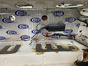

Working on phase 2. There is an amp on the rear bulkhead. I paralleled the rear doors & parcel shelf. Replace rear door & front door speakers with upgrades.
Can't hear the front speakers. Moving the front door speakers to the kick panels and putting 6.5 in the front doors. That set will be in parallel

Paralleling the rear reduced ohms to 2. Front is still 4 ohms. So it is easier for the amp to push the rear. Paralleling the front 4 will even out the load

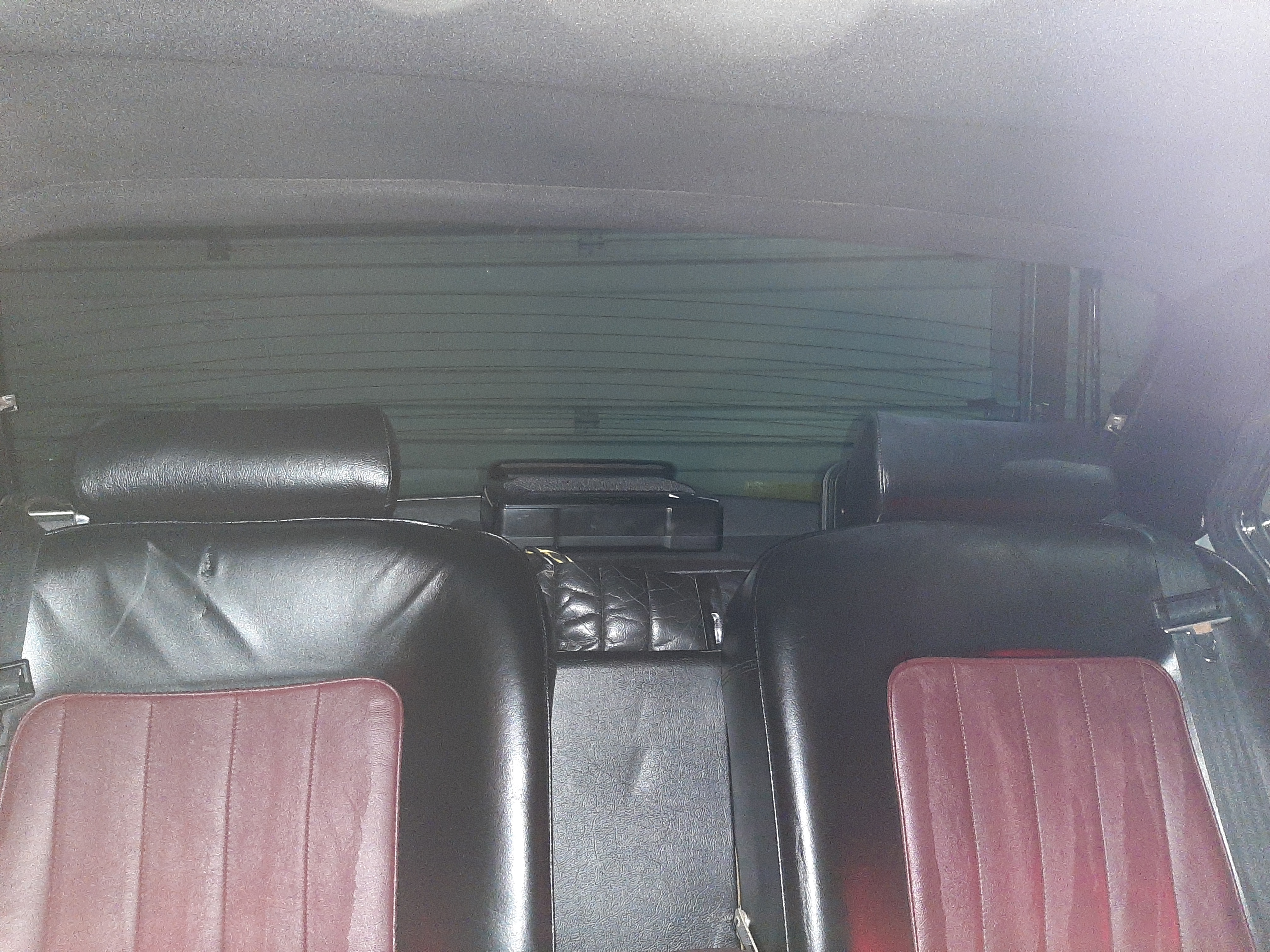

Has anyone removed the rear water catch pan, or redesigned to allow the rear audio speakers to be placed in the rear window parcel? I feel the stock location for the rear speakers doesn't allow for the best sound when there is a passenger in the back. Actually even when there isn't a passenger .
This was the approach I took being less capable in my abilities as most members on this forum but the end result sure sounds better than the four 4" door speakers.
I placed an 8" powered subwoofer and a pair of sealed 5x7 box speakers on the parcel shelf held in place by velcro.

Good job! I don't want to be a naysayer, but... if per bad luck chance you get into a front-end collision, those speaker boxes may become lethal weapons just held in with Velcro.
Good point, I hadn't thought about that. I'll have to figure out a better anchoring system.

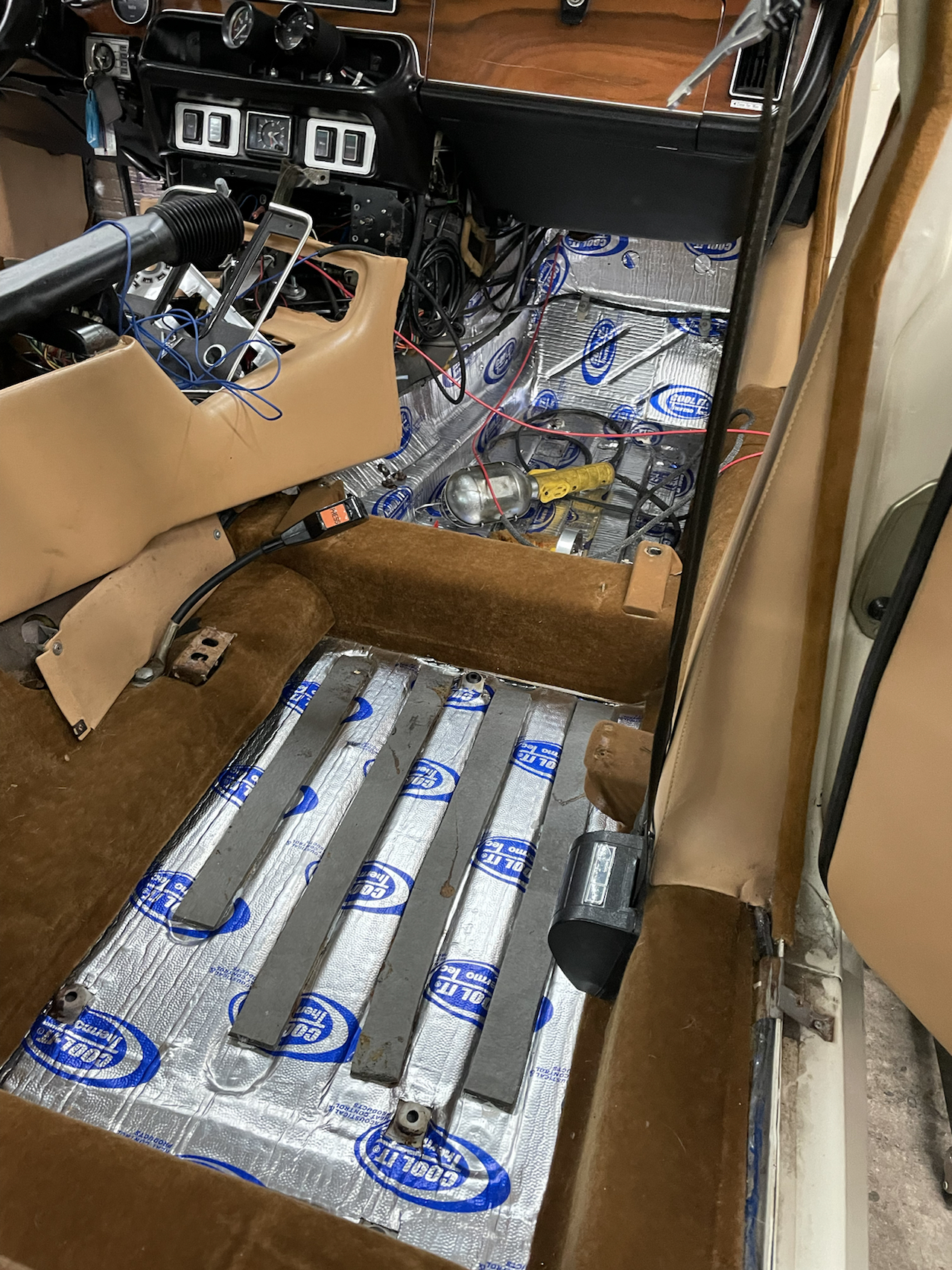

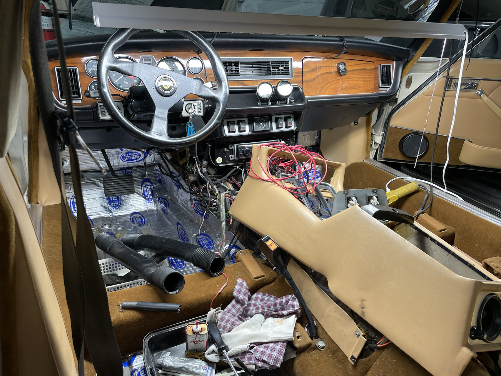

Removed all seats front & back. Amp power goes down the right side of the tunnel in an RFI shield. Amp RCA feeds go down the left side of the tunnel.

Can't get the hang of attachments on my phone.
Attached Thumbnails Speakers in the back window-photo172.jpg   Speakers in the back window-photo351.jpg   Speakers in the back window-photo715.jpg
