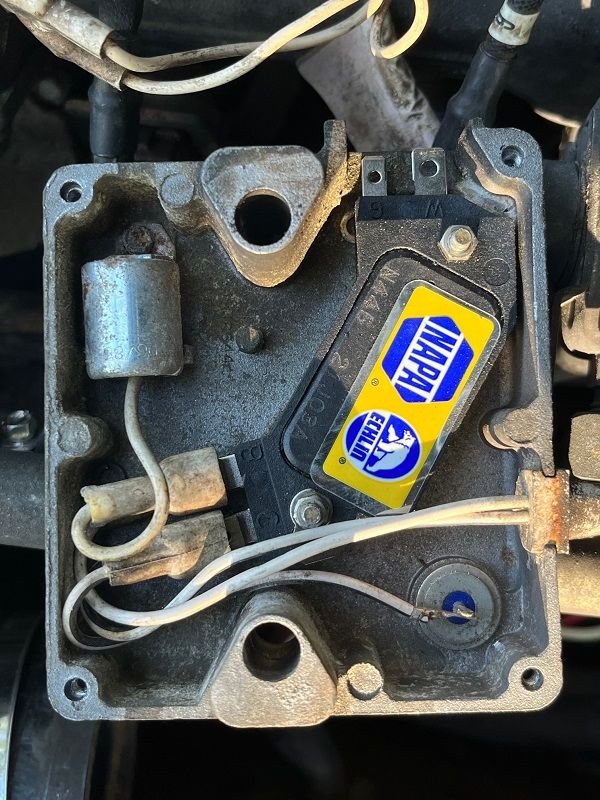

Looks like someone has been inside the ignition amplifier at some point.

Replace the NAPA module with an AC Delco D1906.
A few years ago I was in a pinch and used a NAPA module and had problems almost right off the bat. And I'm not alone. Over the decades others have reported problems with alternate brands.
No promises....but worth a try.

If you are replacing NAPA module, also disable the capacitor and the clamping diode from the circuit; Neither are not needed: capacitor is for radio noise and diode is to protect the weakness of the original module from over voltage. All current 4 pin modules have internal protection.
New coil that is a match for new Pertronix module should be installed. Lucas # DLB198 or Pertronix 45111 Ignition Coil.
Yes this is trouble shooting by parts replacement, but these parts are all suspect and have a history of intermittent operation.
