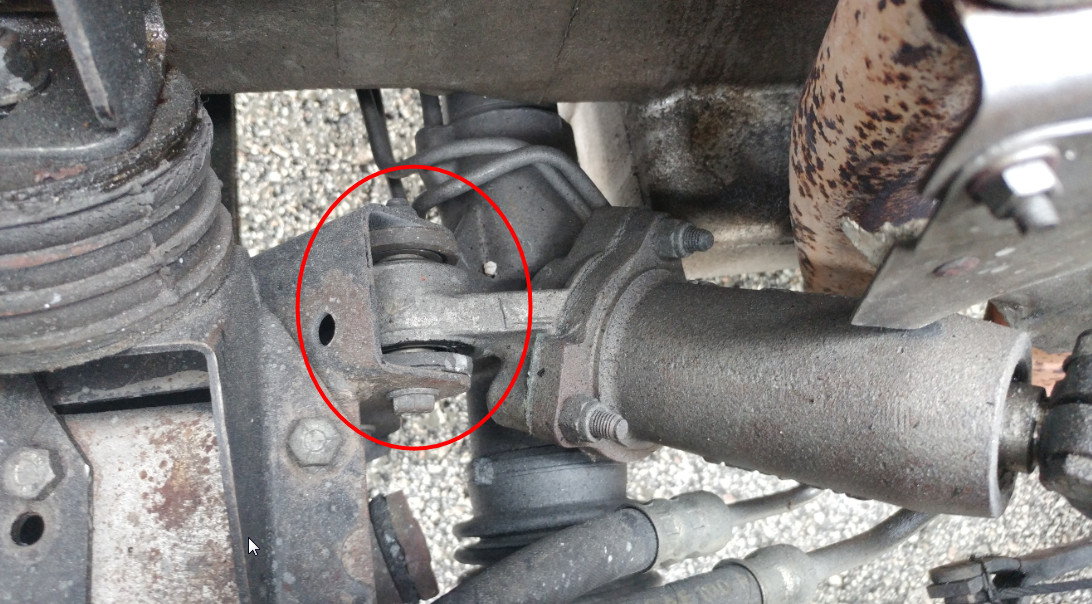

When I rock the steering wheel back and forth the entire unit (within the red circle) moves almost 1/2". I'll assume there should be some sort of bushing in that bracket but I can't find it in the parts manual. Can anyone help? It looks fairly easy to replace.

OH yes you need new bushings!
There are 3 to be changed, and you do NOT want PolyU bushings, and you really should remove the rack.
Take a look at this for bushing change procedure:
https://www.jaguarforums.com/forum/x...0/#post1226209

OMG! And at first glance it looked so simple to replace that bushing right in the car! After reading your thread, I think I'll postpone the job as long as I can. Where can these bushings be ordered so I can have them handy?

Admittedly, the hardest part was getting the first one out. All the others came out easily, but there was no "looseness" such as you have. Yours might simply fall right out.

The bushes are designed so the rack can move laterally and give that wonderful Jaguar refinement. As well as the bushes there are two snubbers that look like large washers with a layer of rubber on one side. These fit either side of one of the bushes to restrict the movement and prevent metal-metal contact.
Of course if you want to drive round race tracks you need the non-movement, bushes as supplied by Polybush. These make the steering more precise but give a rather harsh feel to the steering.

Having used the Red poly bushings, I would not use them again. I like the black ones from Jaguar Specialties... looks like your top bushing will come out easily.

Upon further investigation I now see that there is two sets of bushings on the driver's side. And one on the passenger side?? Left hand drive car. I have circled them in RED. The upper right hand parts list circled in BLUE. Is that all the stock bushings and washers, etc.?

Yes, you are correct about the quantity... the one in the middle is the one that controls rack movement the "most".

yes there are 4 bushings, 4 thin washers/spacers, 2 long bolts, and the bracket/shield on one side is to prevent heat and fluid from deteriorating the rubber.

After going to LnrB's threads and pictures on her replacement of the bushings, she scared the B'Jesus out of me regarding how big a job it is! I was hoping to accomplish the job with everything in place on the car, but how naive I was!
if you have a hydraulic jack, place it under the rack for support, after you have raised and supported the front enough for clearance;
remove the two long bolts and then lower the rack, you might have to smack it with rubber mallet from the top to release it from the front member brackets or "ears".
then the fun begins, inserting the bushings and washers and aligning the bolt with the rack holes, all that while pushing and holding the rack up,
If you have three or four hands, it's easier. using the hydraulic jack helps.
make sure you have properly supported the weight of the car, these cars weigh around 3,800 lbs., most of it in the front. Keep your cell phone near.

Do I have to disconnect any hydraulic lines?

no, you lower the rack just enough to clear the "ears" / brackets. You might have to punch or pry out the old rubber bushes, (do not score or scratch the inner bracket surfaces, use a tool from the opposite side).
