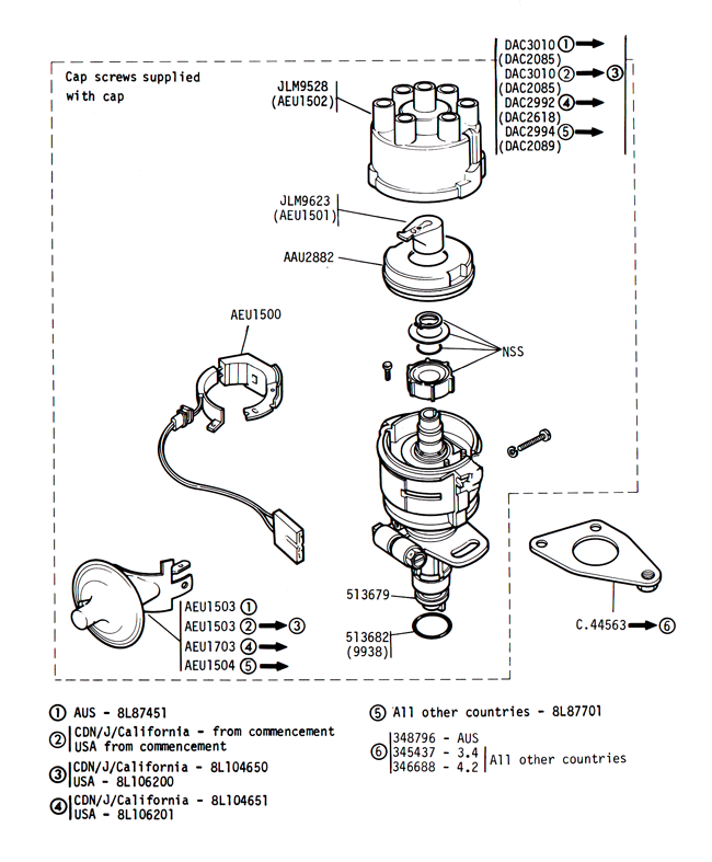

https://www.sngbarratt.com/English/#...EQUIPMENT(3148)
This new pickup includes an all new advance base for mechanical and vacuum advance
or, you could do the Pertonix D171618 with matching coil. The pre-curved 123 unit is not optimum for your EFI engine. curves are too retarded in the beginning and too advance at higher RPMs (there is a fully programmable 123 distributor, but you will have to manually enter the vacuum advance and mechanical advance curves.)

The SNG pickup assembly will cure most problems. **
To install you must remove the star rotor from the shaft. There is a cir-clip holding it on, but mostly it will be stuck from age. You must remove it very carefully or you will stretch the two mechanical advance springs; they are not available anywhere and I could not find any specification for them. One is slightly longer that the other.
you must pull the star wheel rotor up, while holding the center of the shaft from moving up from above the star rotor. Over-night liquid wrench may help before you begin. I am sure the distributor shops have a small puller for the job.
** Once the star rotor is removed you can remove the complete advance mechanism including the pickup. Then liquid wrench all around the mechanical advance sleeve and center shaft shaft. Once clean, you can lube everything with synthetic motor oil and put it back together. The few drops oil you put into the center of the shaft is for upper bearing, that rarely gets serviced.

AEU1500 from SNG has advance mechanism attached.
Rotor comes off advance mechanism sleeve, not the center shaft
Rgds

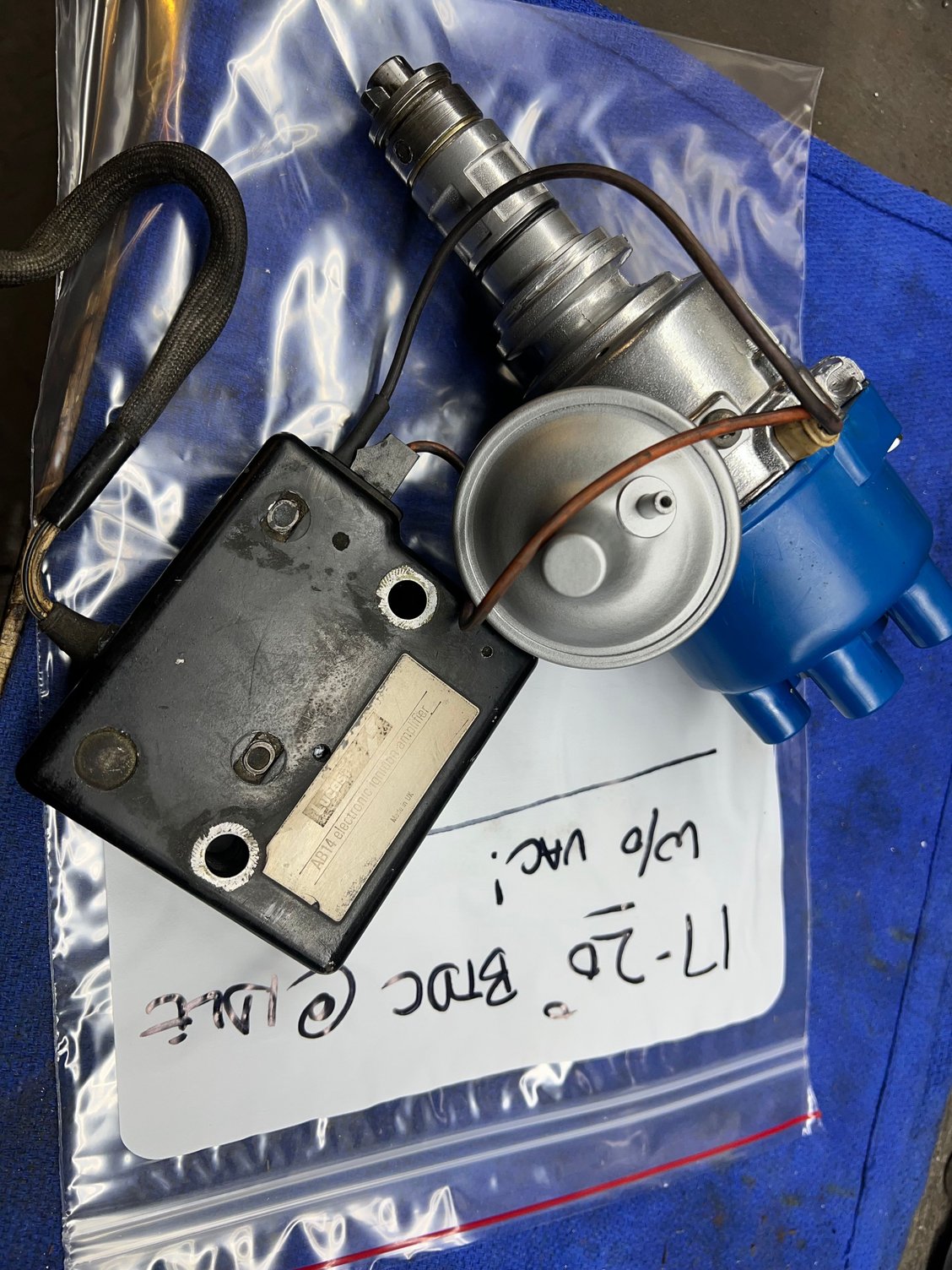

I pulled the entire distributor today and shipped it out to a rebuild shop I will let you guys know how it turns out

Had the entire unit rebuilt by Jeff over at Advanced Distributors. He works so quickly, can’t wait for it to come back to install it. He said it was in pretty bad shape so it should make a world of difference. I will let you know how it goes.

Did the Distributor require a new upper bearing in the casting???
The good thing with Jeff, is you now it was tested on a distributor test bench, if you do the work yourself, the car is the test bed.
