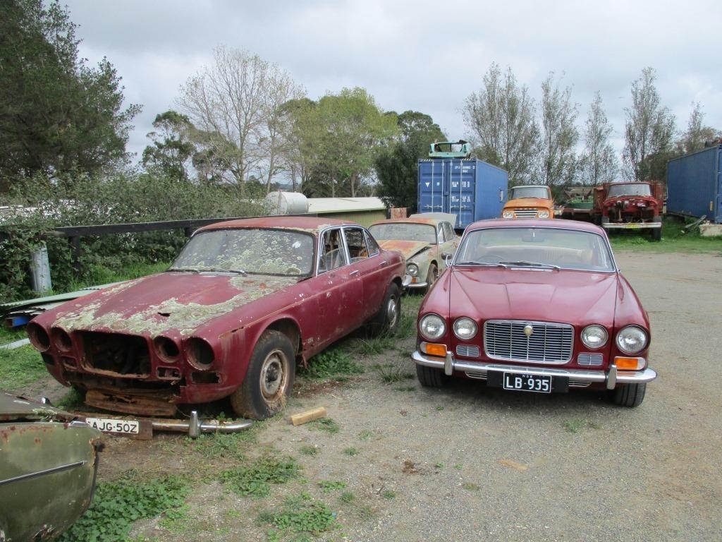

Here is a quick history of two cars, Both started out from Browns lane factory as Series 1 XJ6 autos in regency red with biscuit interior. The first car stayed on the road until around 2003, when most likely advancing corrosion meant she could no longer pass annual roadworthy. This car was then bought by a collector and taken to a field filled with other cars for company. Unfortunately this field was high above the sea and subject to easterly breezes bringing salt air. Many years later the collector, having done nothing with his field of cars died. His cars were then sold at auction. The now very rusty XJ6 attracted the attention of an enthusiast. But so bad was the rust, he was unsure whether the car would fall apart when trying to move it. He was only prepared to pay $50 so a Hot Rodder bought the car for $150. The enthusiast spoke to the Hot Rodder and asked what he wanted the car for - just the front and rear suspension was the reply. So our enthusiast negotiated salvage for the remainder.
Our second car did not suffer the same fate and was bought when only 10 years old, and has remained in a nice dry garage ever since. The enthusiast now has a jumble of trim parts (some already removed) and the two cars met for the first time today.

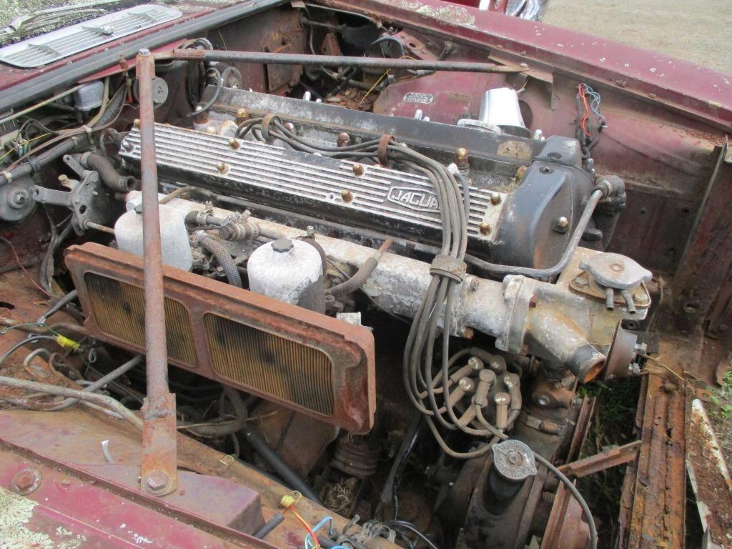

here is the engine of the first XJ6. I am having this to see if I can rebuild it. Long shot I know as it will have cracked bores or rotten studs.

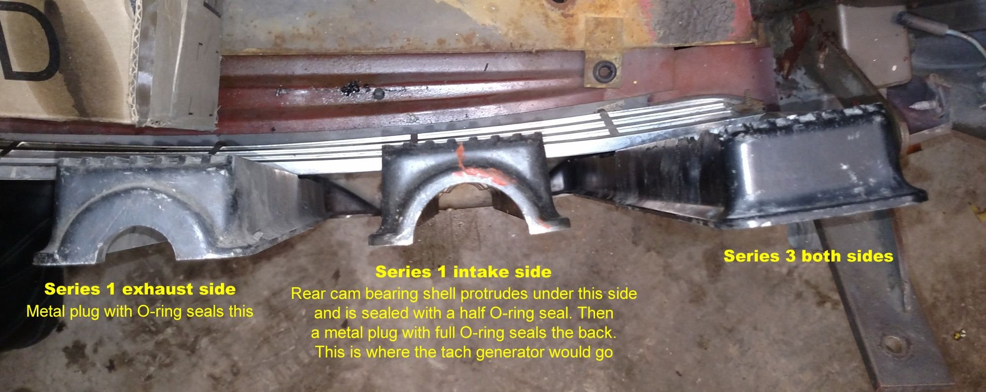

Hi, they will interchange as far as bolt pattern is concerned the problem is the S1 XJ6 (and earlier non-ribbed) cam covers have half moon shaped cutouts in the back to accommodate a plug. This is leftover from earlier cars that had a tach generator.
You can use them but need to modify the early cover for use with the S3 head and half moon seal. Not complicated for a good welder. You basically just need to close the hole in the back of the cam cover.

Hi Jose, your 3.8 has half moon seals? that's unusual - are you sure the head is original?
Below is a comparison of the S1 XJ6 cam covers. This is also how the earlier non-ribbed versions look. So basically to use S1 covers on a S3 head you need to close the holes in the back and provide a flat surface for the gasket to seal. S3 XJ6 uses only half moon seals that fit into the head cutout.
