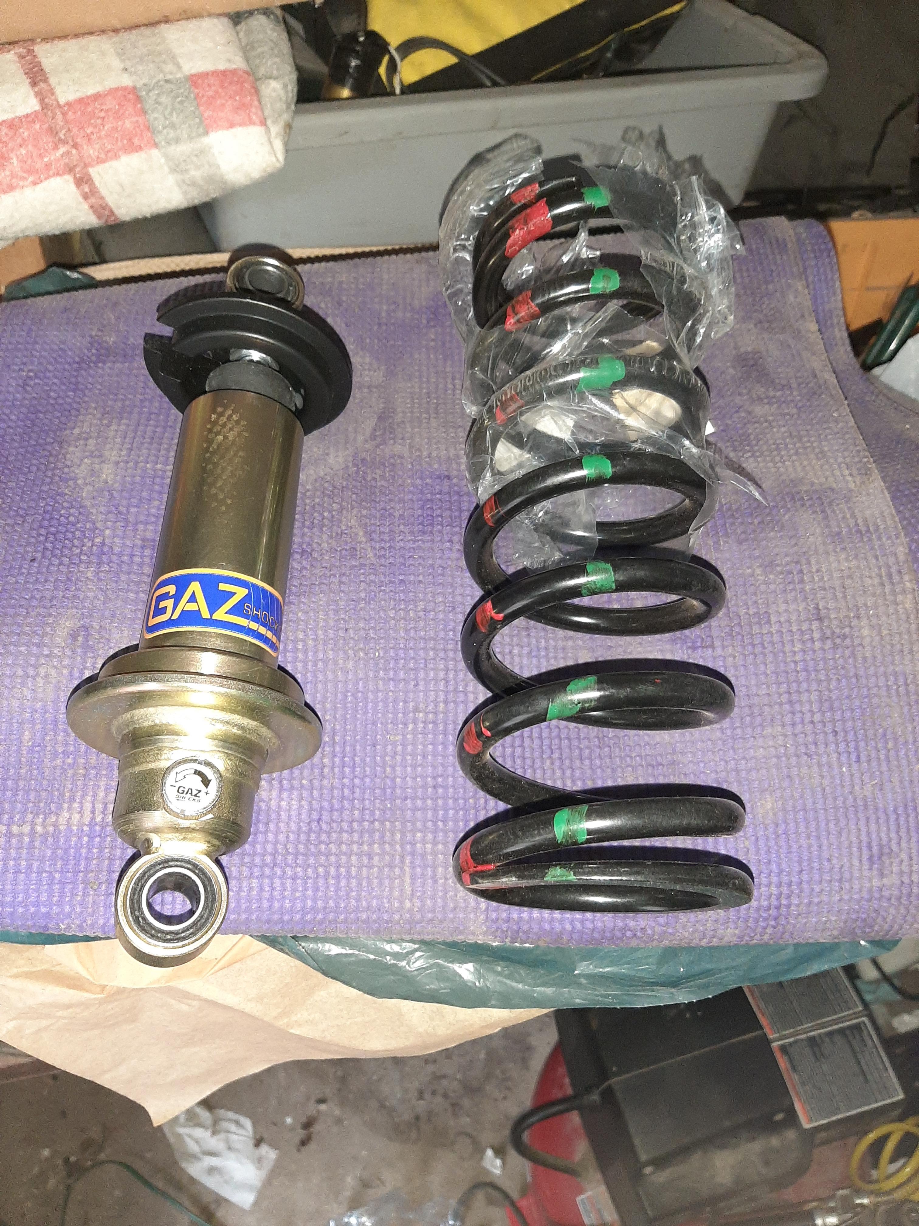

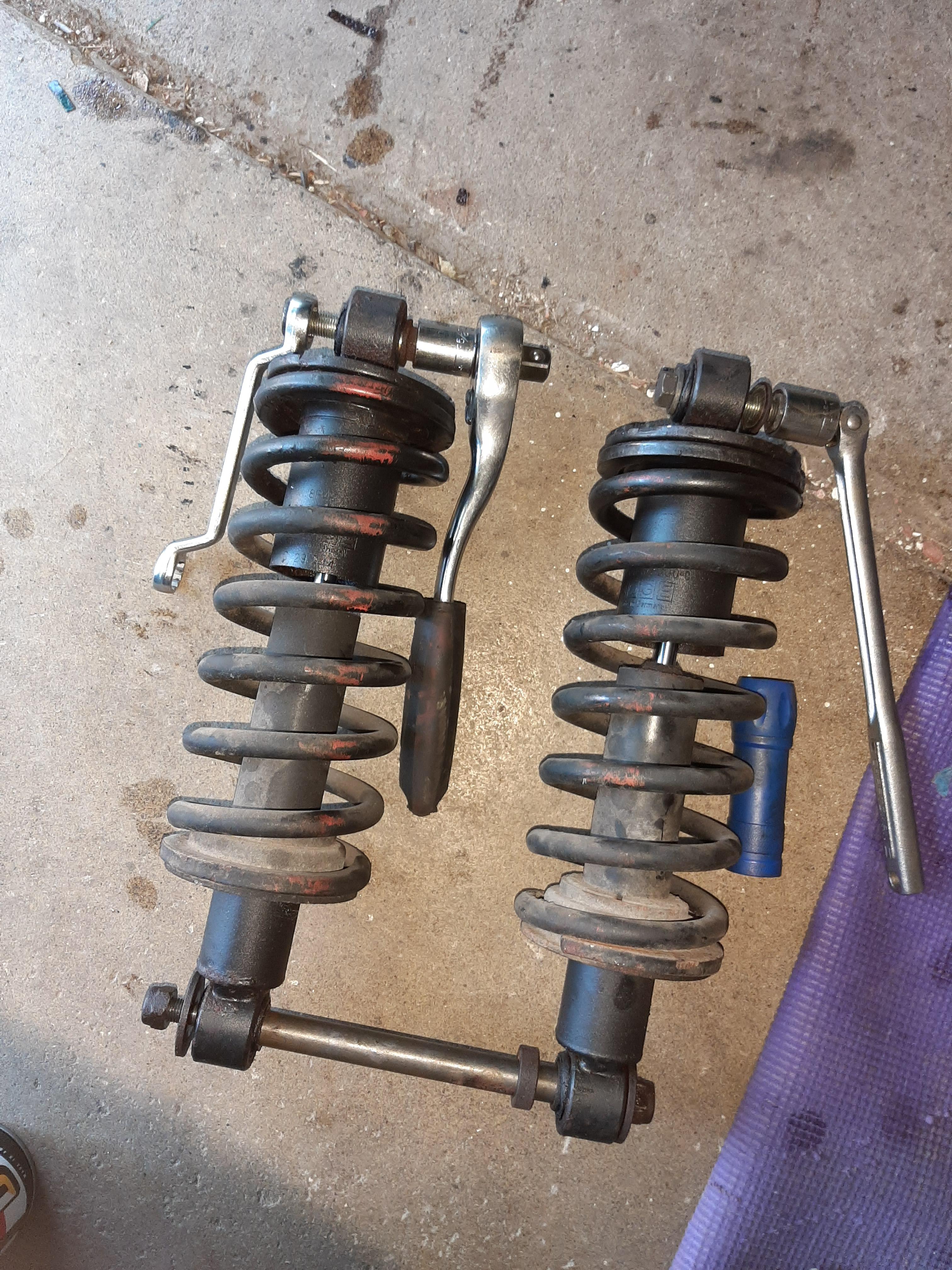

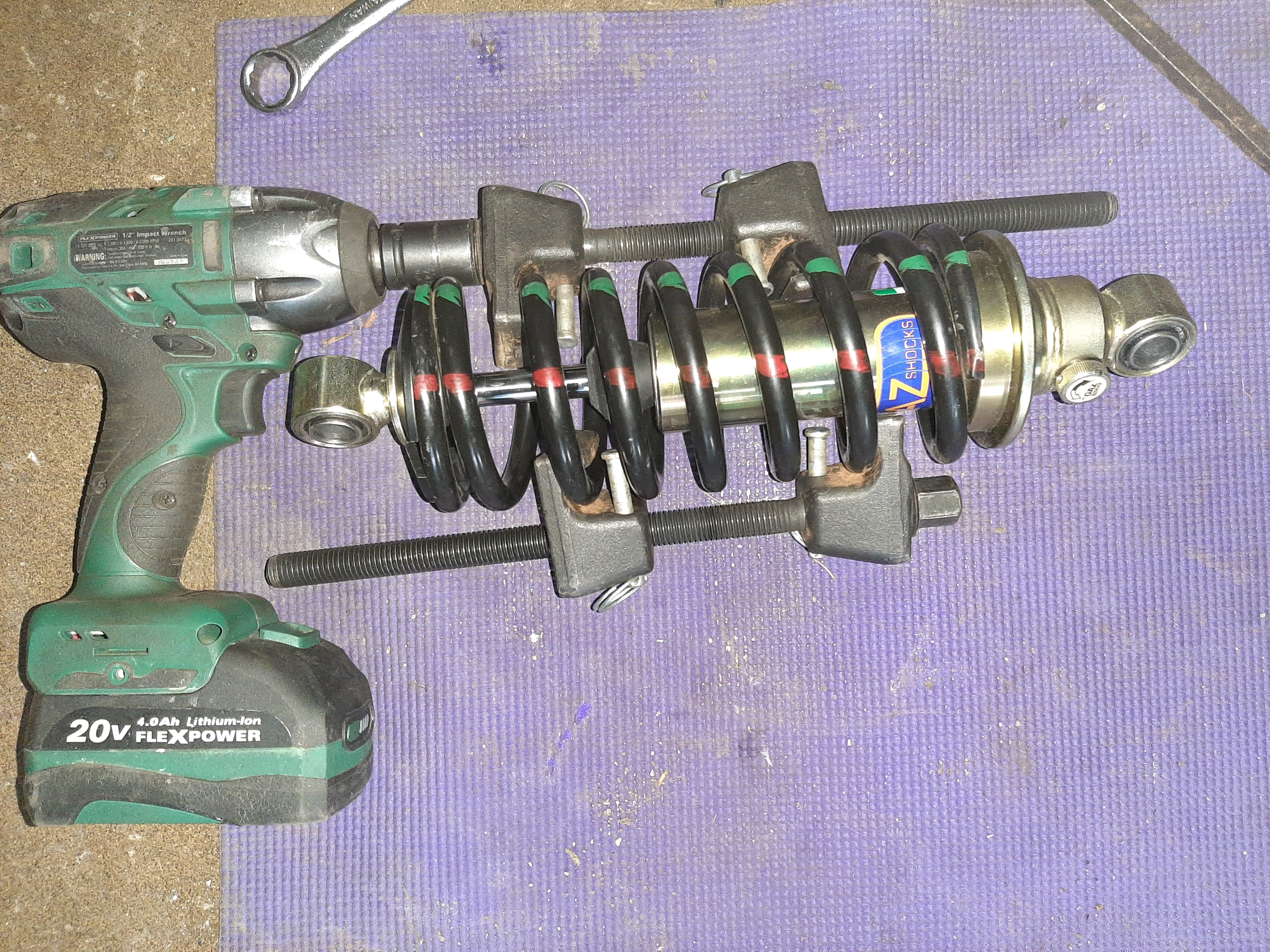

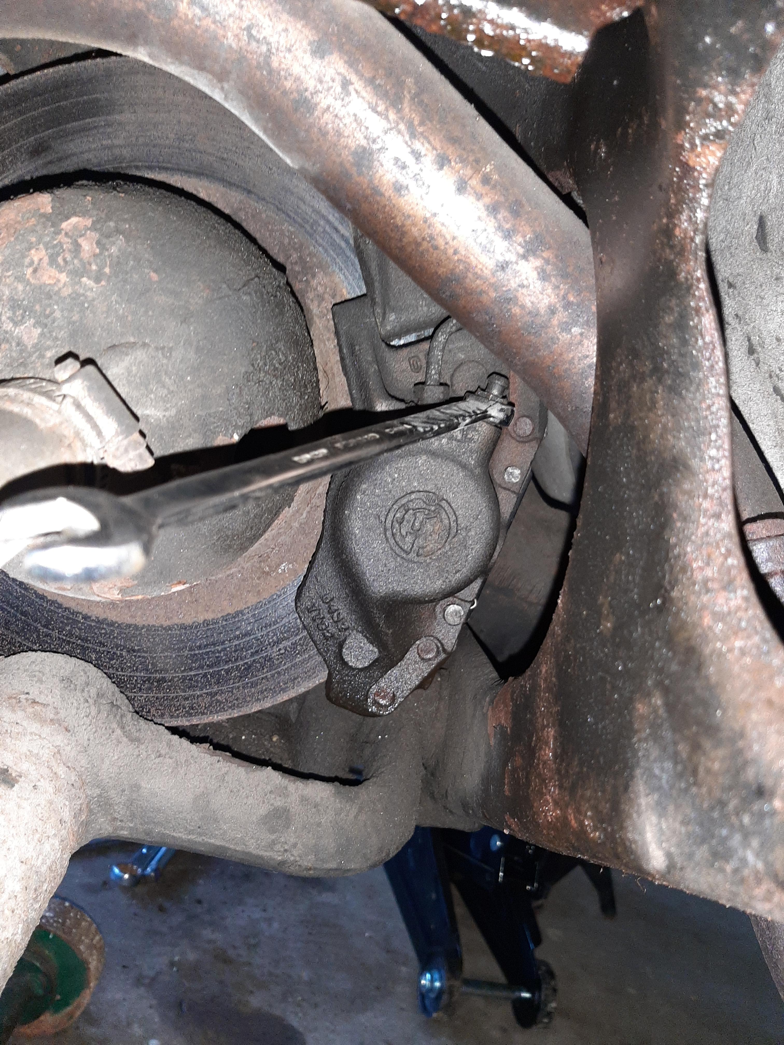

hi: my butt is firmly planted on the ground as i work on the underside of my car as well. admittedly i had to remove the one of the rear shocks on each side to get a clear pathway but i get the impression that this is well within your ability.

easier than it sounds. to remove: 1 top bolt and nut.....same for the bottom....pretty good bolt/nut access too...someone will have to do this to properly bleed the system so it might as well be you.....i've read your posts and you are very capable..... unless your rear shocks/spring are new, take the money you will save and apply it to new set of gaz adjustable shocks and springs....i really noticed the difference.
