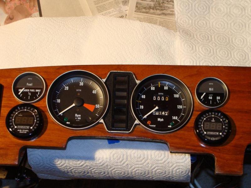

Hi guys, so I've got a 1975 Series II XJ6 and I bought an Innovate MTX-L air/fuel ratio gauge and it came with the Bosch Wideband O2 Sensor (LSU4.2). Can anybody give me suggestions on the best place to mount this on the exhaust system?

Hi rustfreemike, thank you for responding! I'm just learning about this stuff. I thought the needles were fixed, but when I rebuilt my carbs, that's what I noticed. I have about 2-3 turns of adjustment. Something made me feel that maybe somebody tried changing the needles out to a different profile. In any case, my carbs seem to work properly, but maybe just because they're old, they don't seem to adjust to OEM specification. I originally bought the air/ratio fuel gauge just to help tune it up, but because circumstances changed, I decided to mount the gauge on my dash and permanently install the sensor. I know the carbs won't be perfect, but I was hoping to adjust the air/fuel ratio to the optimum of the most used RPM of the engine. What pushed me in this direction is that when I originally got the car, the carbs were in such bad shape that all the car did was blow out billows of black smoke and the whole air pollution system was totally plugged up with carbon. Parts of the EGR pipe were totally plugged with carbon. So I'm working with this air/fuel ratio gauge to understand quantitatively how the carbs are running.
