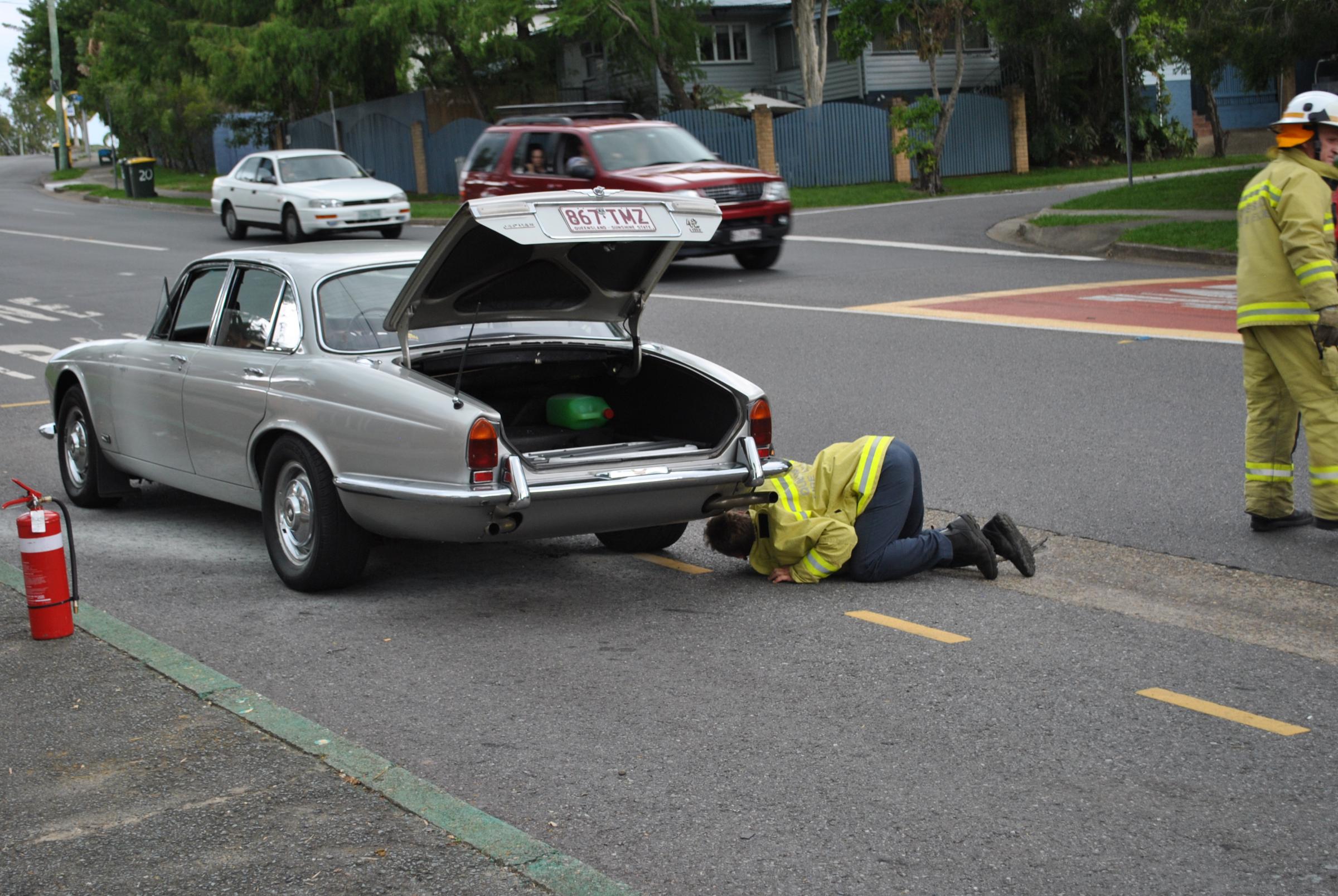

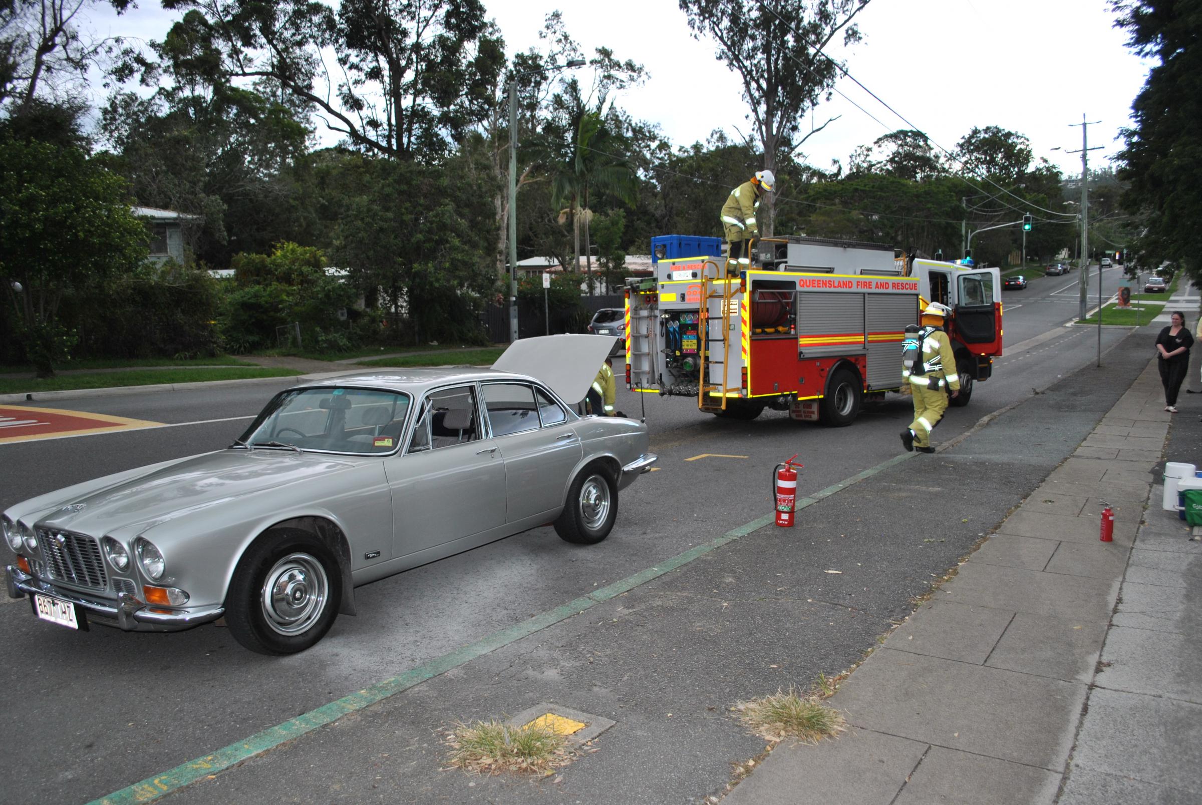

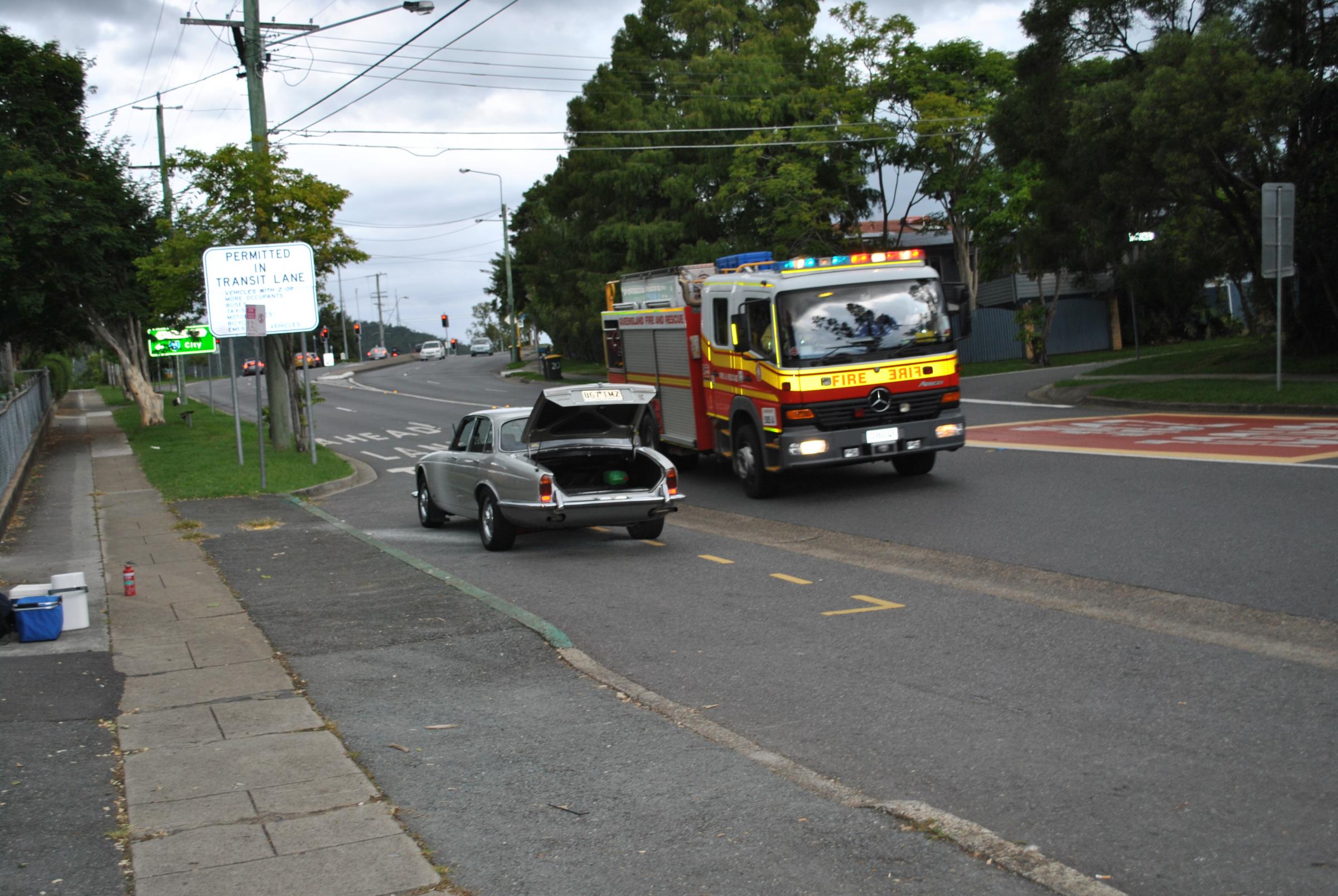

Hi All, took the wife and nieghbours for a Sunday drive in the mountains today.
XJ6 caught fire on the way home.
No idea why but I took the fire extinguisher off the garage wall before we left and put it in the boot!. Got to be lucky some of the time
Attached Thumbnails Sunday drive ends with 000, I'm on fire.-dsc_8819.jpg   Sunday drive ends with 000, I'm on fire.-dsc_8825.jpg   Sunday drive ends with 000, I'm on fire.-dsc_8826.jpg   Sunday drive ends with 000, I'm on fire.-dsc_8829.jpg

Don't know, stopped at the lights and smoke bellowing from rear gaurds. Pulled up around the corner and had a look under,black melted plastic dripping from above right pipe where it goes up over the axle etc. Called Racq to get it towed but while we were waiting the smoke was getting worse so popped under for a gander and had a fireball ball happening up around top of suspension right near fuel tank . That's when the work place fire training kicked in and emptied the extinguisher into the fire then proceeded to call 000.
Got it in the garage at home now,was nearly dark by the time we got home so will investigate the cause tomorrow. Still no idea what it was. Right side of the car is sitting about 2" lower than the left now.
And yes everyone is ok,the girls a bit shaken. But they were sitting right above the fire

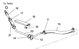

The fuel feed pipe from the side of the tank (item 20) to the pump is routed round the rear silencer. Here in the "Land of Rust", these would badly corrode posing a fire risk.
Even though rust isn't an issue in your country, the pipe or the rubber connections could have deteriorated over time.

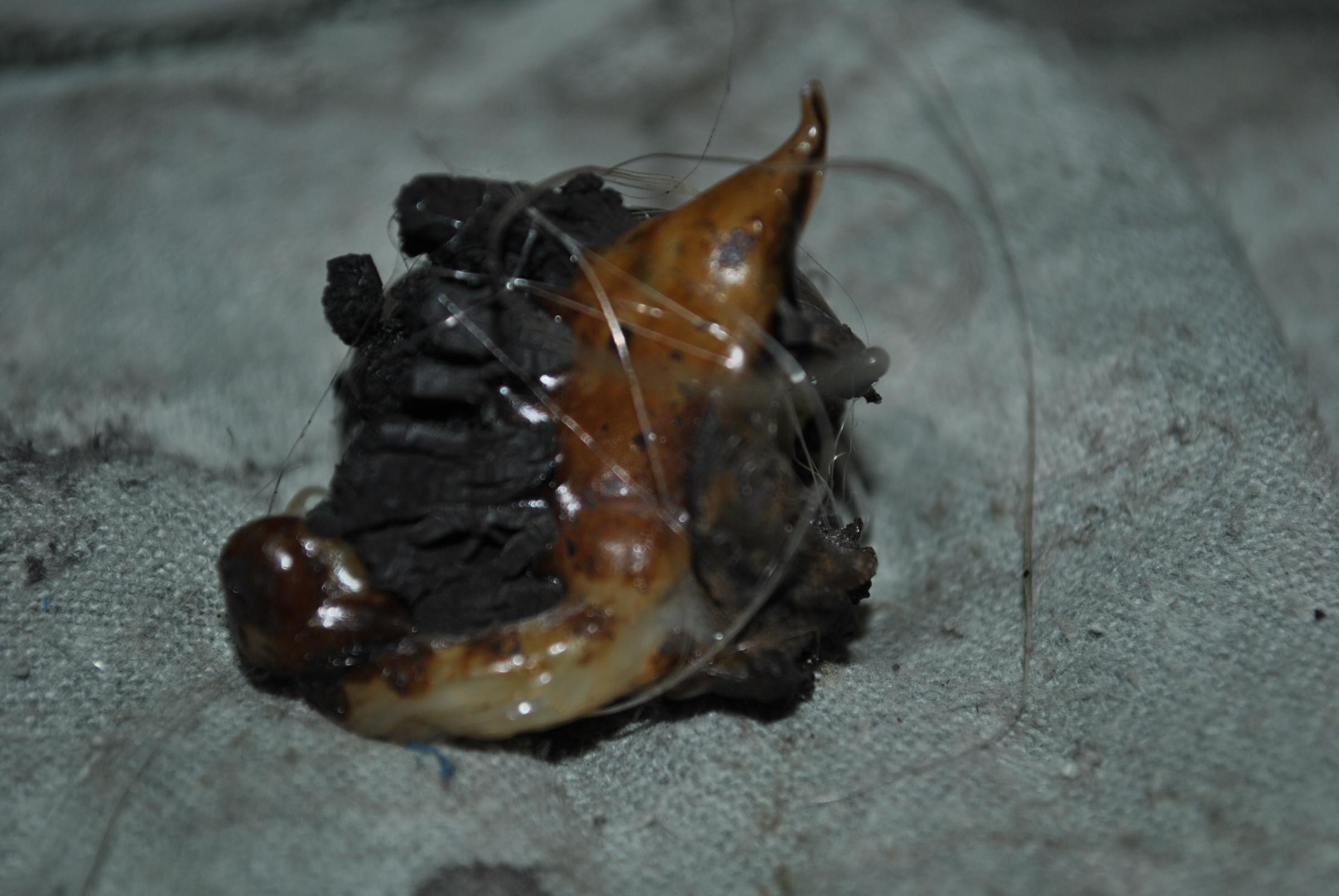

Default found 1 part on road.
Going to put it up on stands in the morning and have a good poke around to see if I can find the cause. If I can't find the cause or there is damage to shocks etc
I may put in an insurance claim . The brake peddle was getting a bit spongy at the last couple of lights I stopped at but I was putting that down to the very steep decent on a mountain road we had just done(20 km of downhill braking)

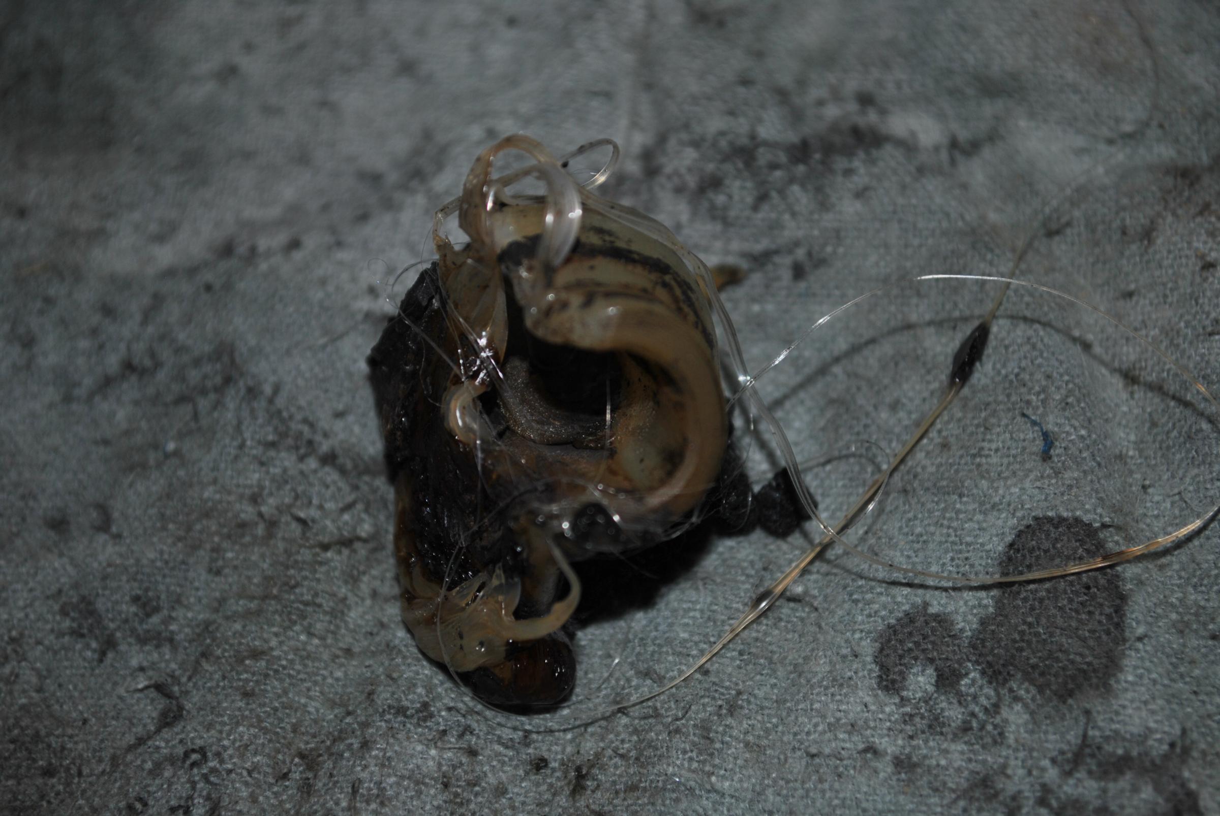

I found this on the road after car was put on tilt tray,I think it may be an upper mounting bush off a shock. Daylight will give some answers.

That "bushing" does look like shocker related, and looks like "Nolathane" to me.

The shocker bush more than likely answers the low stance I reckon.
