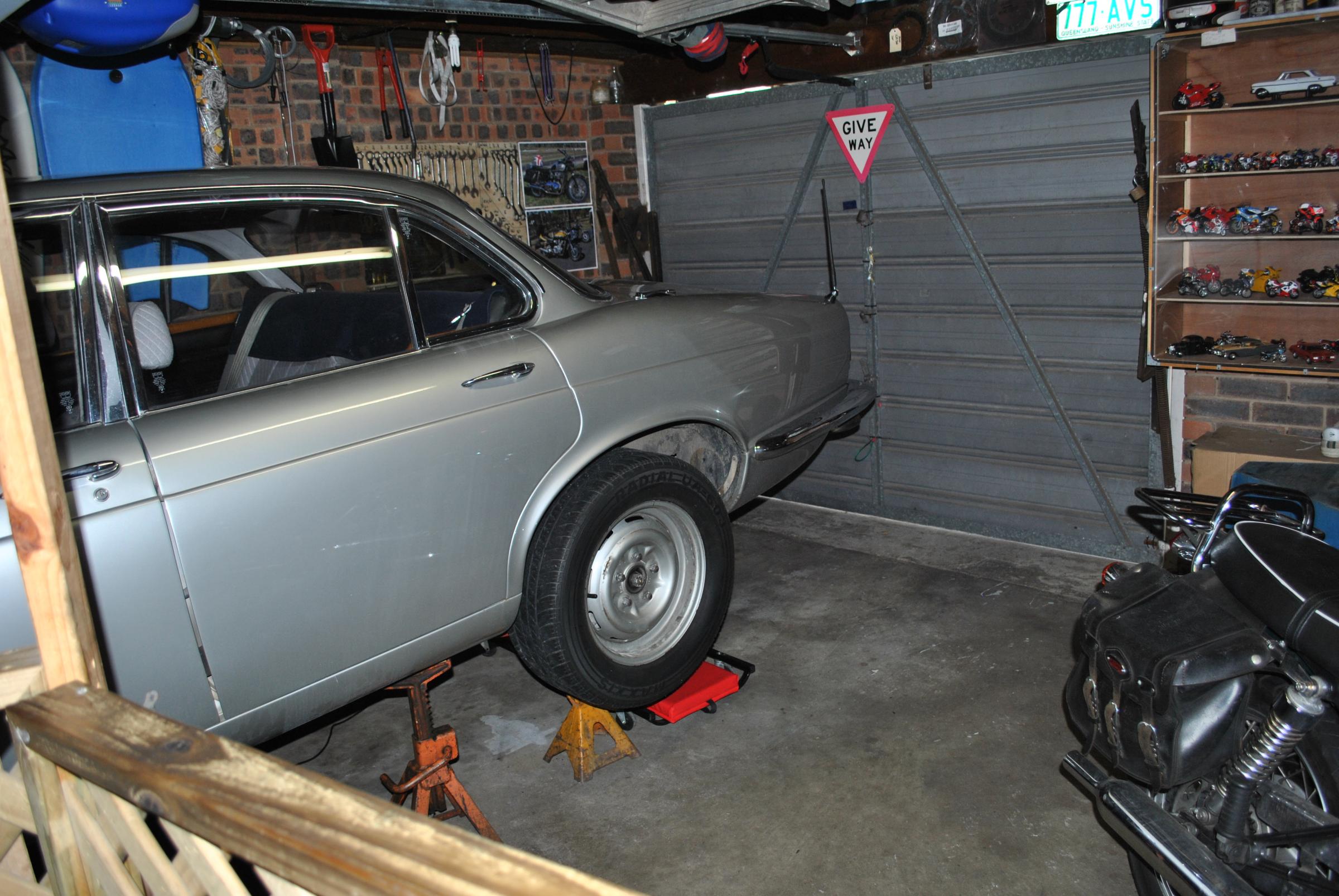

The assessor came today,pretty well told me to start stripping it myself as the claim probably won't be accepted.
Thought as much.

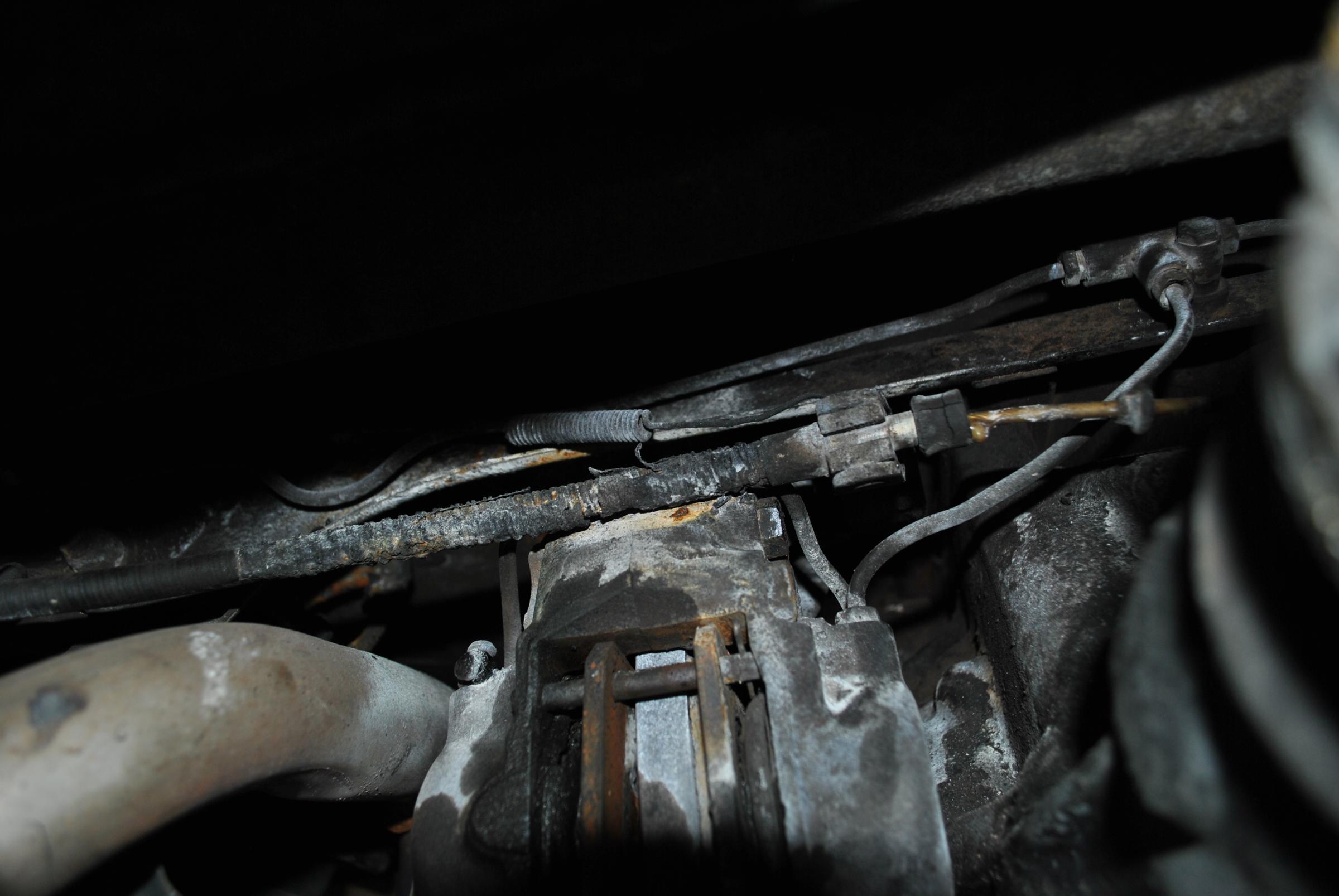

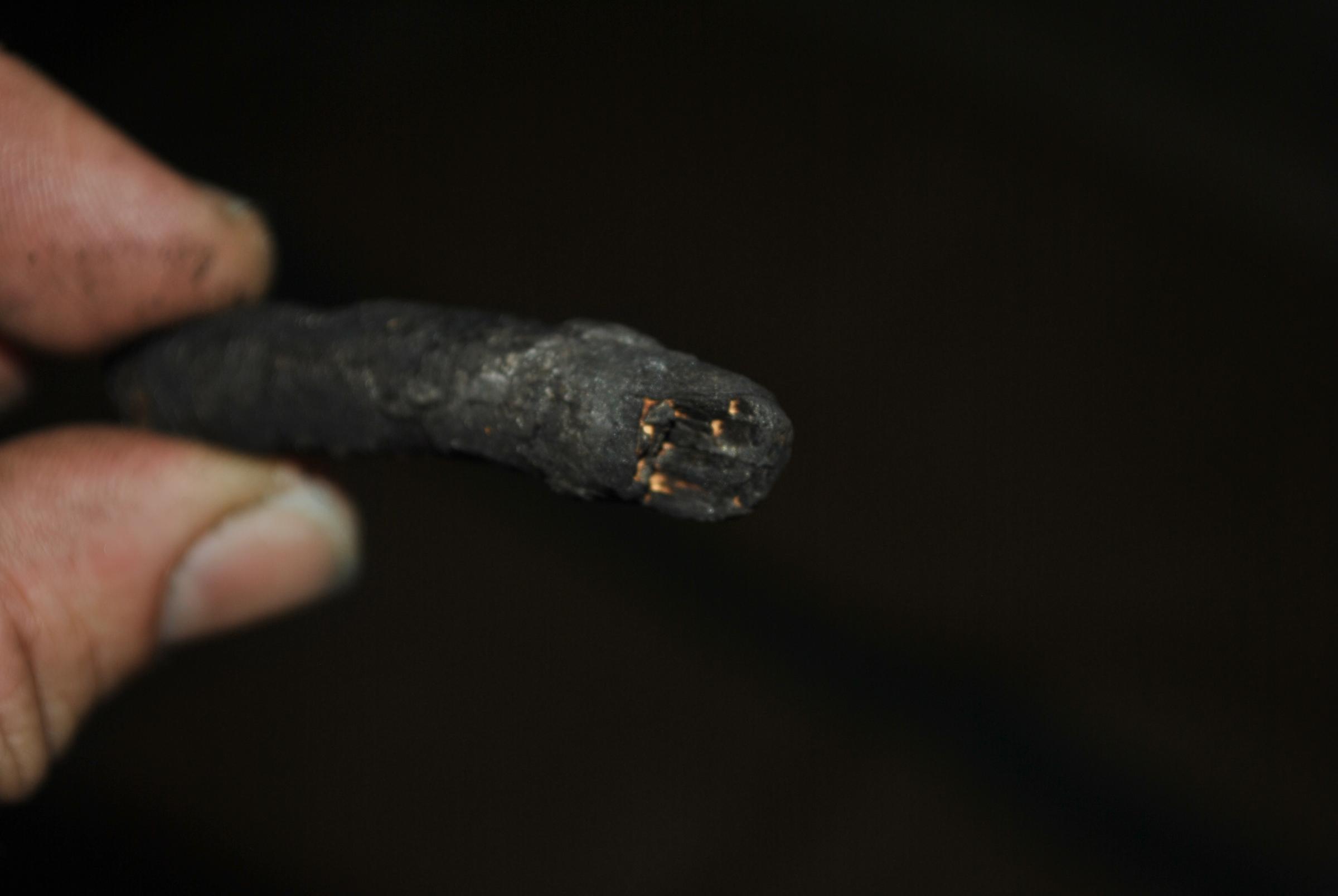

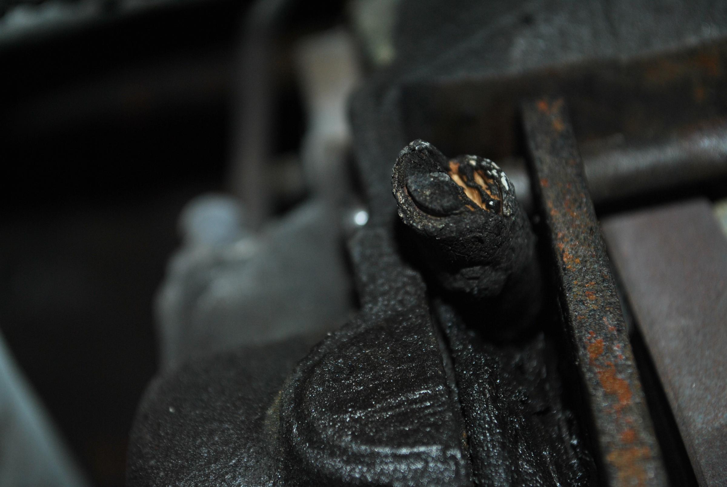

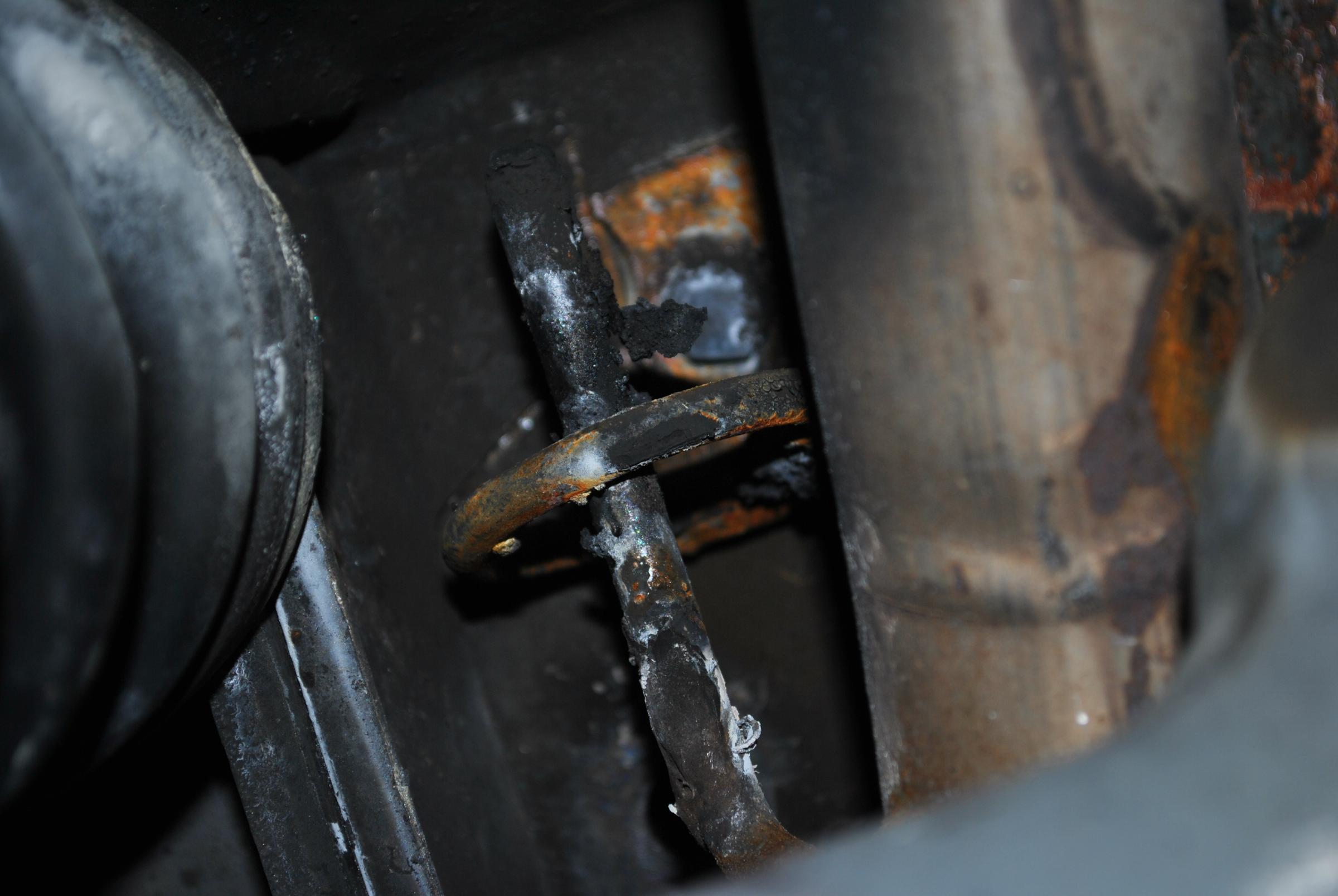

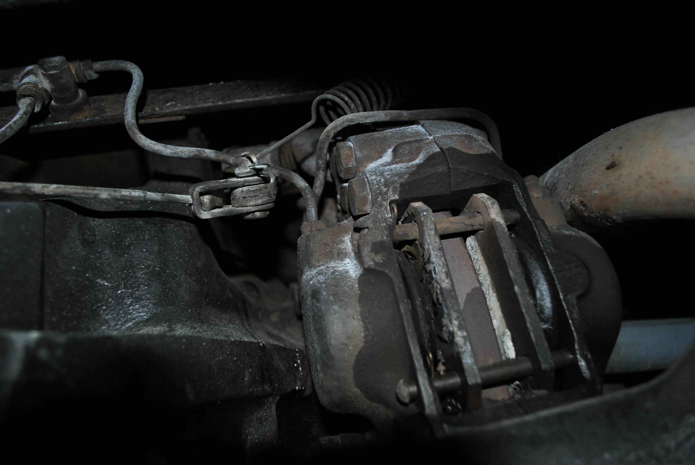

Here are some pics. Could this stick between pad and piston cause that much heat?
Thought as much.
Lookin' that way, Mt Glorious is 50km of **** hot bike roads,but always sticks and branches to avoid. Tree lined roads all the way. I ran over a few on the way down,but not uncommon. Usually hit a few sticks on that road on the bike. Easy to see how it could happen with inboard brakes,wouldn't happen if they were in the normal place.
Have been Riding/driving this road for 25 years. Best bike road around Brisbane. 50km of tight and sweeping corners with steep accents and decents. Not uncommon to avoid sticks/branches on the road,have hit plenty on the bikes and did feel a few hit the floor pan on Sunday(as I say,not uncommon). Trees are right up to the edge of sealed road.
My "walk by theory" is a branch flicked up from the road and part of it lodged in the caliper,after a while metal to metal caused heat that melted the piston seals. Sparks ignited the paint or exhaust hanger and proceeded to ignite brake fluid from calpier.
Just lucky I stuck my head under for a gander I guess.

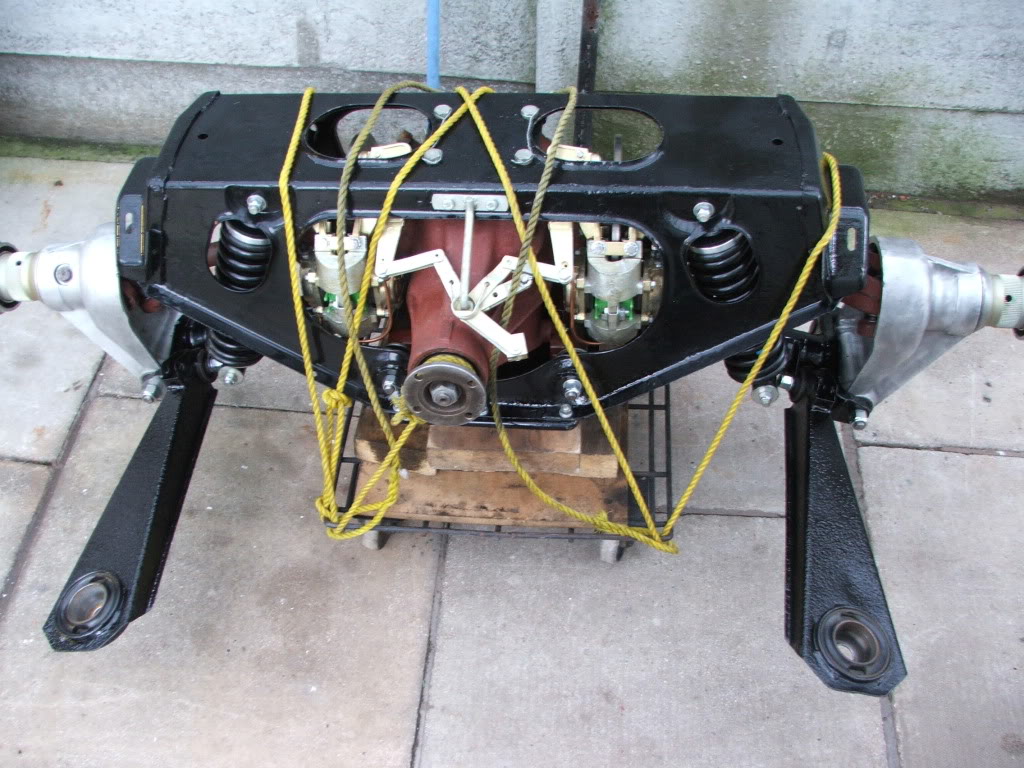

It's not as bad as I was expecting. The big plus is you got the fire under control before the bodywork was affected.
A rebuild of the rear suspension will be costly in parts. Everything rubber and all bearings will need replacement after the fire.
The low cost solution in the UK would be to get a complete IRS (Independent Rear Suspension) from a scrap car.
Is this likely to be an option in Australia where early cars last forever and scrappers must be rare?
There is a couple of complete rear ends available, but only problem is they are 2000km away. But already started the search.
Will a series 2 or 3 unit fit ?
It looks a lot better after a good hosing down and cleaning away of soot and powder.
