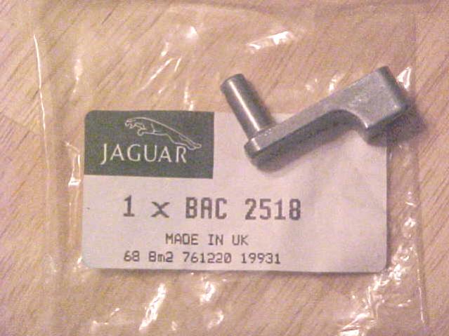

the rear seat squab is the rear seat Back. In order to remove it, just remove two screws at the front bottom of the rear seat, then lift the seat and remove from car. The seat Back has two screws at the bottom too, remove those too. then push the seat Back from the bottom UP, to disengage it from its brackets. remove Back from car.
The sunroof motor is located at the center with two cables.
TRIVIA:
you can manually open and close the sunroof with a little cranking tool that Jaguar included in every XJ. Most cars have lost them by now, although it would be wise to look in the trunk, removing the square upholstery panel which is held in place by two black plastic screws. Use a coin to turn the screws.
Many US cars came with this tool mounted to one of two beams behind this upholstery panel, where there is a square hole in one of them, very close to the back of the sunroof motor. Usually they were held there with a nylon tie. Who knows, it might still be there.
you simply attach the crank tool to the bottom pin of the sunroof motor and turn it, just like a window crank. Clockwise and counter-clockwise to open or close the sunroof panel.
These crank tools can still be ordered through the Jaguar dealer. About $40.00 nowadays I would think. Maybe cheaper.
This tool is a good way to check the sunroof motor gear. If the gear is stripped, it will skip as you turn the motor.
But it could be something as simple as the gear and cable COVER not being tight enough, so I would check it by turning it manually before replacing the motor.
So guys, run and get them cranking tools, if you can't find them, let me know. Here's a picture.
Jose
