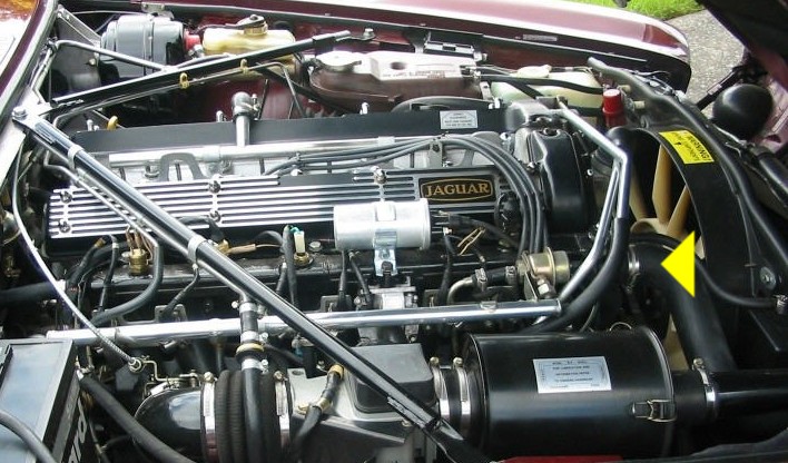

Jose's Avatar
Posts: 9,139
Likes: 2,662
front of radiator, follow the top radiator Hose until it reaches the front of the engine, towards the passenger side. (see yellow arrow in picture)
once you separate the Hose at the engine side, there is a steel housing with nuts;
if you can remove the nuts without breaking the studs, then you pry the housing and under the housing you will see the thermostat. Observe the orientation before removing it, the new one goes in one-way only.
if you break one of the studs while trying to remove the thermostat housing nuts, you are in big trouble, so be very careful. Spray RustBlaster or ******** on all the nuts for a few days before attempting to loosen the nuts. It is a known issue that the studs break when you put a wrench to them. You are warned.
the alternative is to take the car to an experienced Jaguar mechanic and let him/her do the job.
Also there are two different temperature thermostats, make sure you buy the correct temperature thermostat for the region where you live. Go to a Jaguar Dealer, do not install a cheap aftermarket thermostat, these cars don't like cheap thermostats.

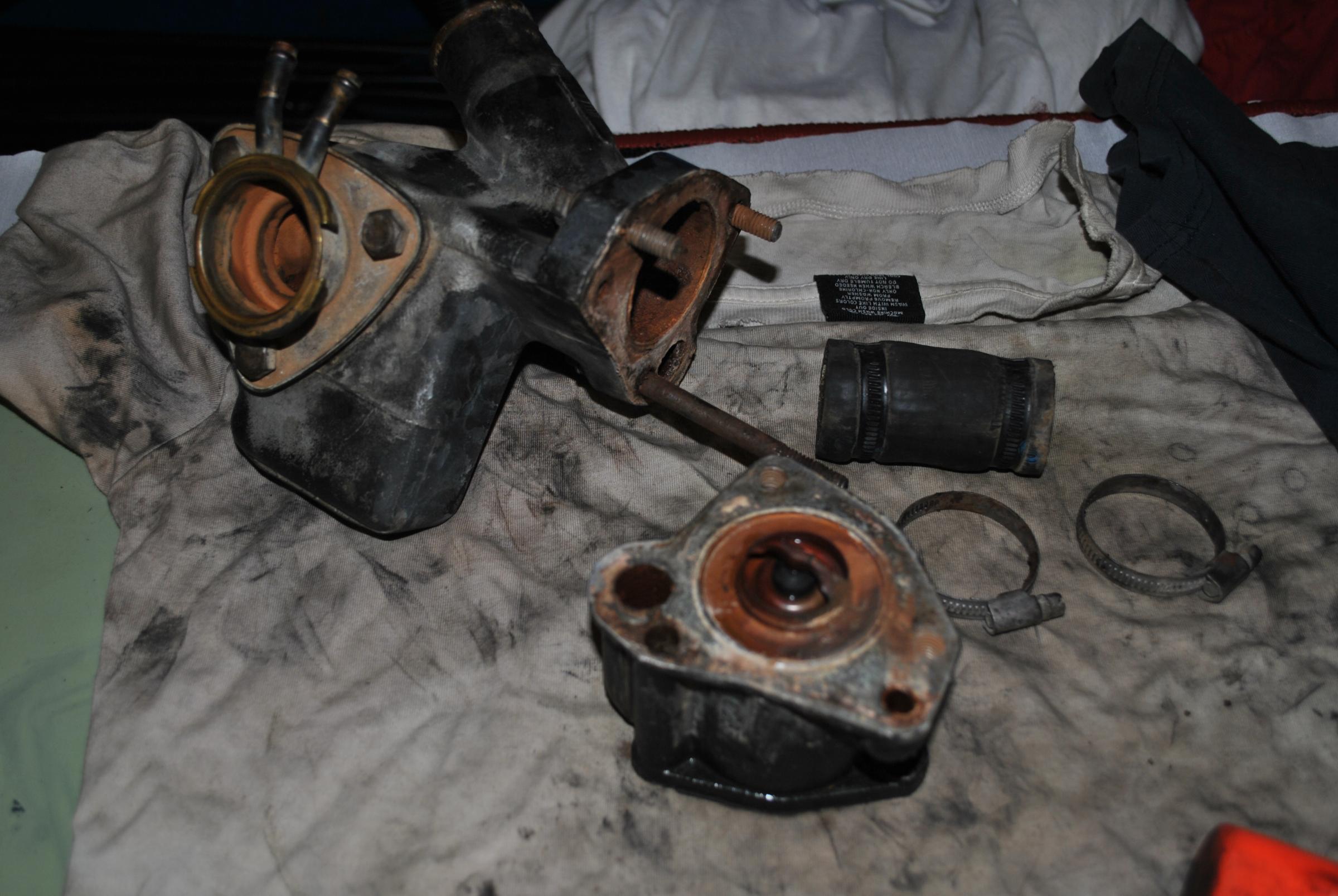

o1xjr's Avatar
Posts: 28,386
Likes: 6,340
Default Series 1 XJ6
One picture of the housing in place, the second with it removed.
The S3 looks similar except for the tank in front of it in the books I have.
Thermostat location-dsc_0099.jpgThermostat location-dsc_9938.jpgThermostat location-dsc_9937.jpg
