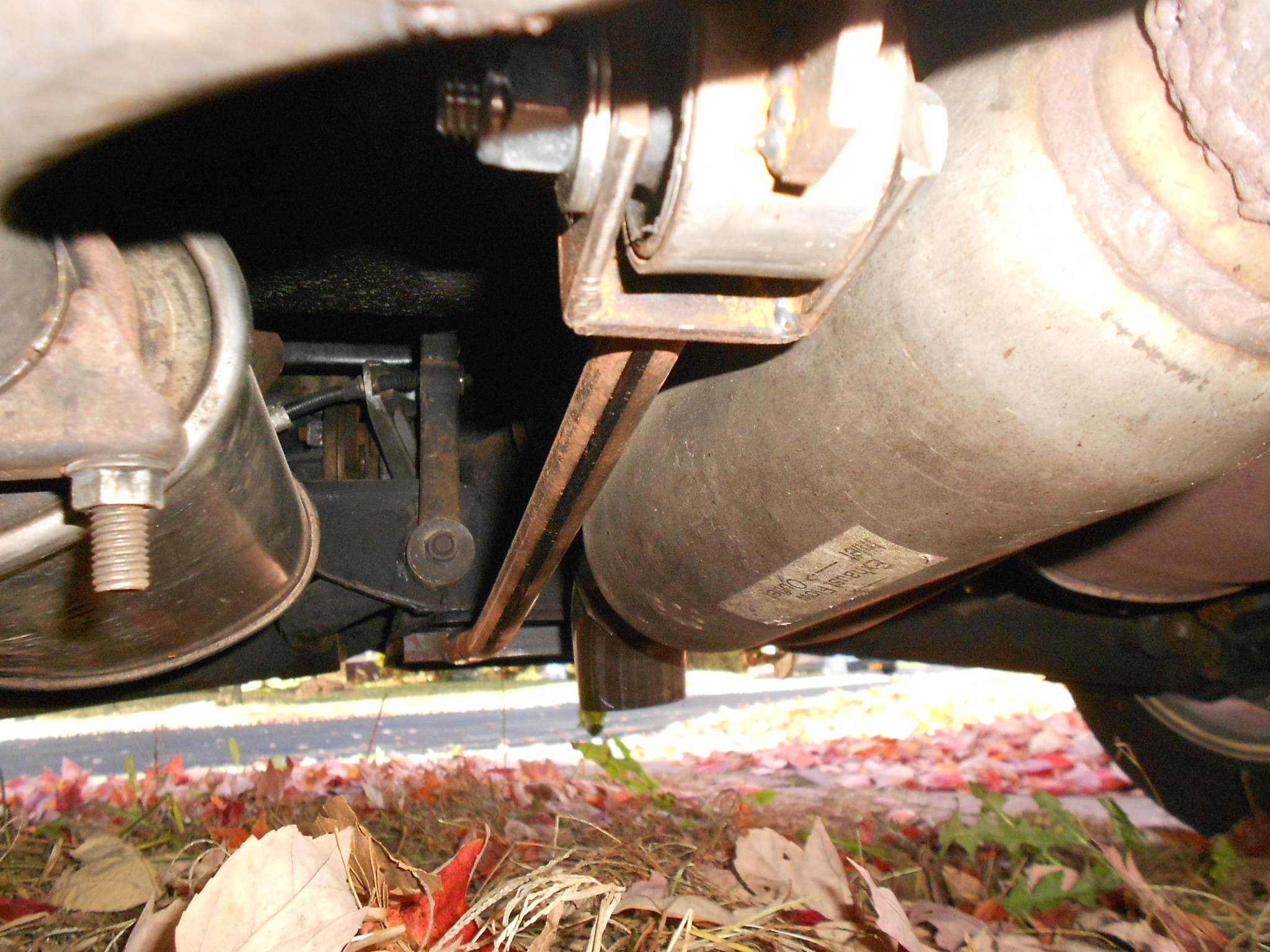

I had the same problem with my SBC 400. I had the same heavy drum beat on hard acceleration. It's known in performance circles that the Jag IRS rolls when under high torque loads and while surfing around the interweb I saw many ways others devised to control it. Most were solid or fixed and would have transmitted NVH to the body of the car. I chose a strut mounted to the cage bottom for a long moment arm that was bushed at the end for isolation. I fabricated it as a bolt on because I didn't know if it would work. One end bolts to the bottom of the IRS cage using the plate bolts and the other end bolts to the chassis using the bolt holes that were used for the center bearing support plate. The bushing I used is the small radius arm bushing pressed into some thick wall tubing that happened to be the right size. After I installed this I had no more drum beat, no more wheel hop and no additional harshness.

Not ideal and probably wont accomplish anything unless you use 4 of them and set it up like a 4 bar live axel rear. You need stop the IRS from rotating around the center line of the wheel so a fixing bar needs to be solid on one end and long for leverage. The one you specified from speedway seems to be able to twist at both ends so as the irs moves it would simple move with it. Look at how jag solve the problem in the XJ40.
here is another good application...using the XJ40 support. I wanted to do this but exhaust routing was an issue and that piece was hard to find alone.
