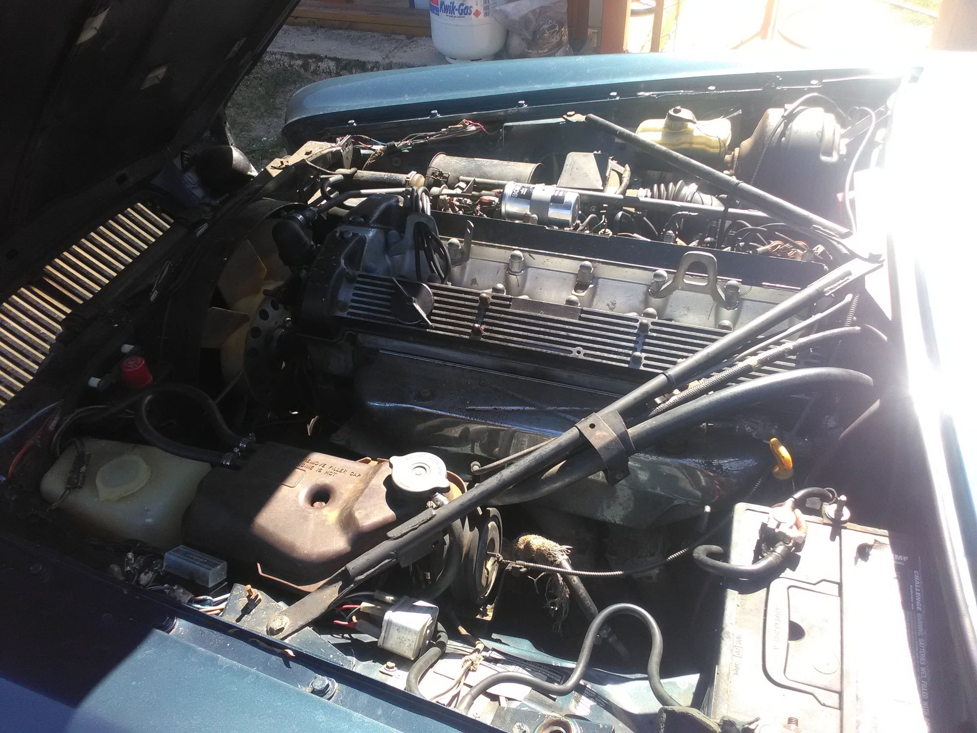

Old Apr 19, 2017 | 11:11 PM
bjsovereign's Avatar
Joined: Mar 2017
Posts: 68
Likes: 17
Hmmmmm
Old Apr 19, 2017 | 11:12 PM
Joined: Mar 2017
Posts: 68
Likes: 17
Old Apr 19, 2017 | 11:20 PM
Joined: Mar 2017
Posts: 68
Likes: 17
Old Apr 19, 2017 | 11:30 PM
Doug's Avatar
Posts: 25,528
Likes: 11,721
From: Pacific Northwest USA
OK, looks like Lucas CEI.
I don't see a ballast resistor for the coil.
Do you have a volt-ohm meter?
Or a 12v test light?
DD

Likes: 17
Might have found part of the reason. At least all efi wiring in good condition. Will just retape the harness but replacing the white with black stripe going from the coil back to the plug at the start of the injector harness, the green that goes to the sensor above injectors 3&4 from somewhere down below and the wires (white and white/black stripe down to the amplifier. From coil to efi harness
Green wire from sensor behind coil on water rail to down below somewhere.
