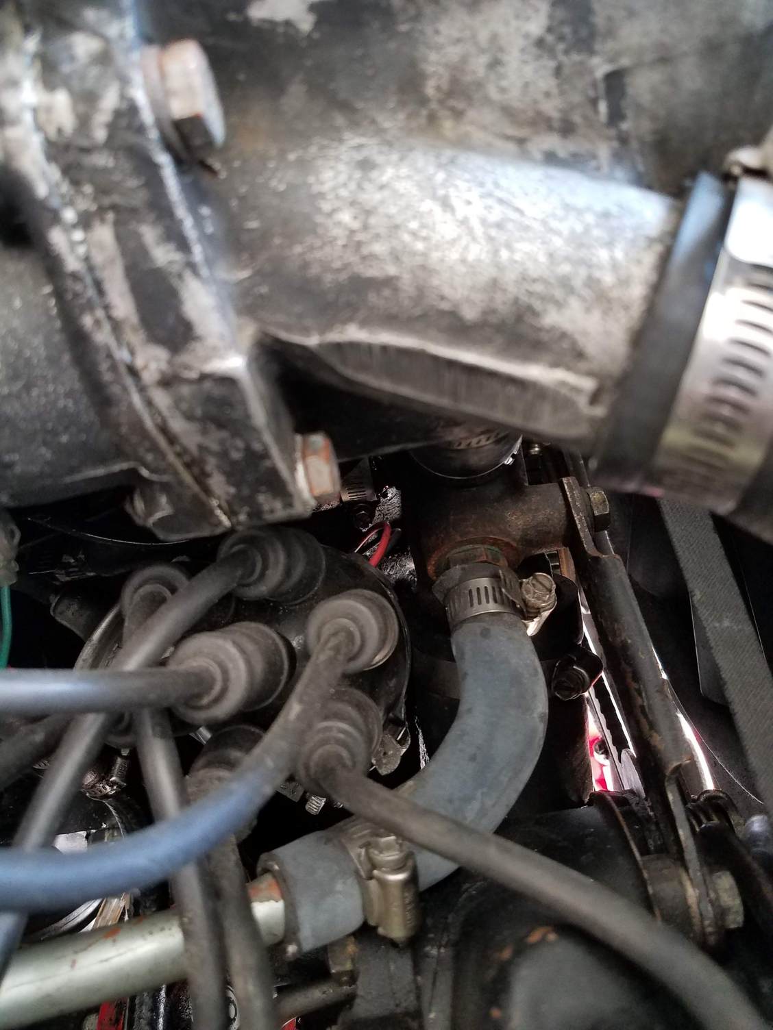

These two pics show the orientation of the distributor on my '74 XJ6. If you are hitting interferences and still 8-10 degrees out, you may need to reorient the distributor. I think its possible to install the distributor 180 degrees out, then reconfigure the wires so that 6 is on 1, 2 is on 5, etc.... you may be able to get it to run, but you don't have enough adjustment to get it where it needs to be.
As far as not smooth at 55... my car always hated 55, was not a comfortable speed.
I haven't run points in years. I would encourage you to pursue a pertronix or luminition set up. One less thing to worry about or more importantly it allows you to rule out variables that maybe causing bad performance. For those that love adjusting points, my counter point is that on this particular car, it is a pain in the *** to get to that distributor.. you'll spend enough time on that side of the engine compartment as it is, why add distributor work?
