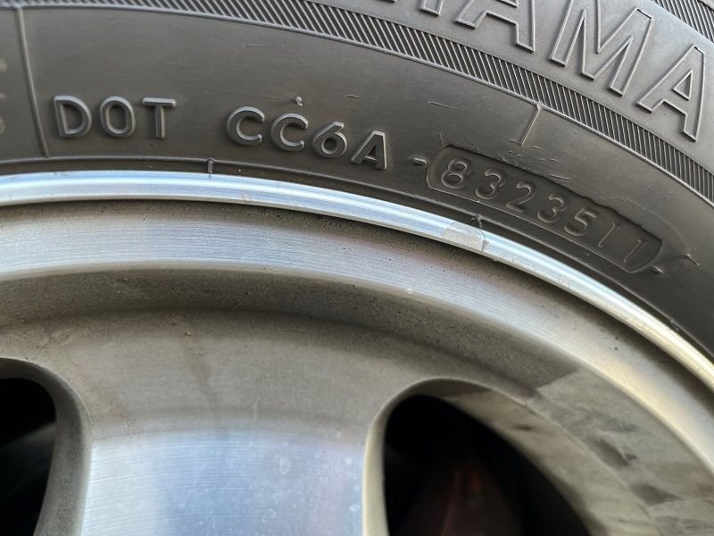

I thought the date code was a 4-digit number with the week and year of manufacture. Were my tires made the 35th week in 2011? The tires are Yokohama YK580's in the stock 225-55R-16 size. I see the YK580s are still available today, but was the design really around way back in 2011? The tires have plenty of tread, but if they are 11 years old then they probably should be replaced regardless.
If my understanding of date codes is correct, and I think it is, yes, 35th week of 2011
Everyone has different comfort levels. I'd be inclined to replace 'em unless my driving was 100% limited to merely putt-putting around town.

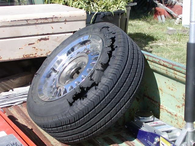

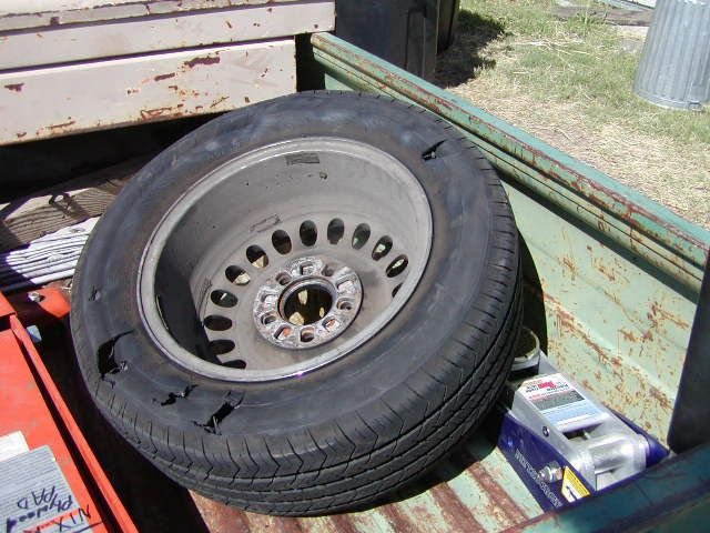

When Nix first came to live with us she had Brand New Michelins all around. Then still had rubber whiskers so we thought we were getting a real deal. And as usual I drove the car like I stole it.
About 3 weeks later I was rounding a curve at about 70 (still testing the car's capabilities) when she gave me a little wobble and rubber parts went flying all over the road. The left rear tire has *Shredded* on that curve! Shredded I say!
Only then did we learn that these tires were 10 YEARS OLD!! The PO had kept them in storage against the day he sold the car and we fell for it.
The US DOT says tires should be used for no more than 6 years (I've never got 6 years out of a set of tires). Most of the tire stores I have dealt with won't sell any tire over 3 years old.
I did learn my lesson that time though, and I learned how to read tire codes.
As Doug says, your tires were were built in 2011. Definitely time to invest in new ones.

Wow, Elinor. A picture is worth a thousand words!
