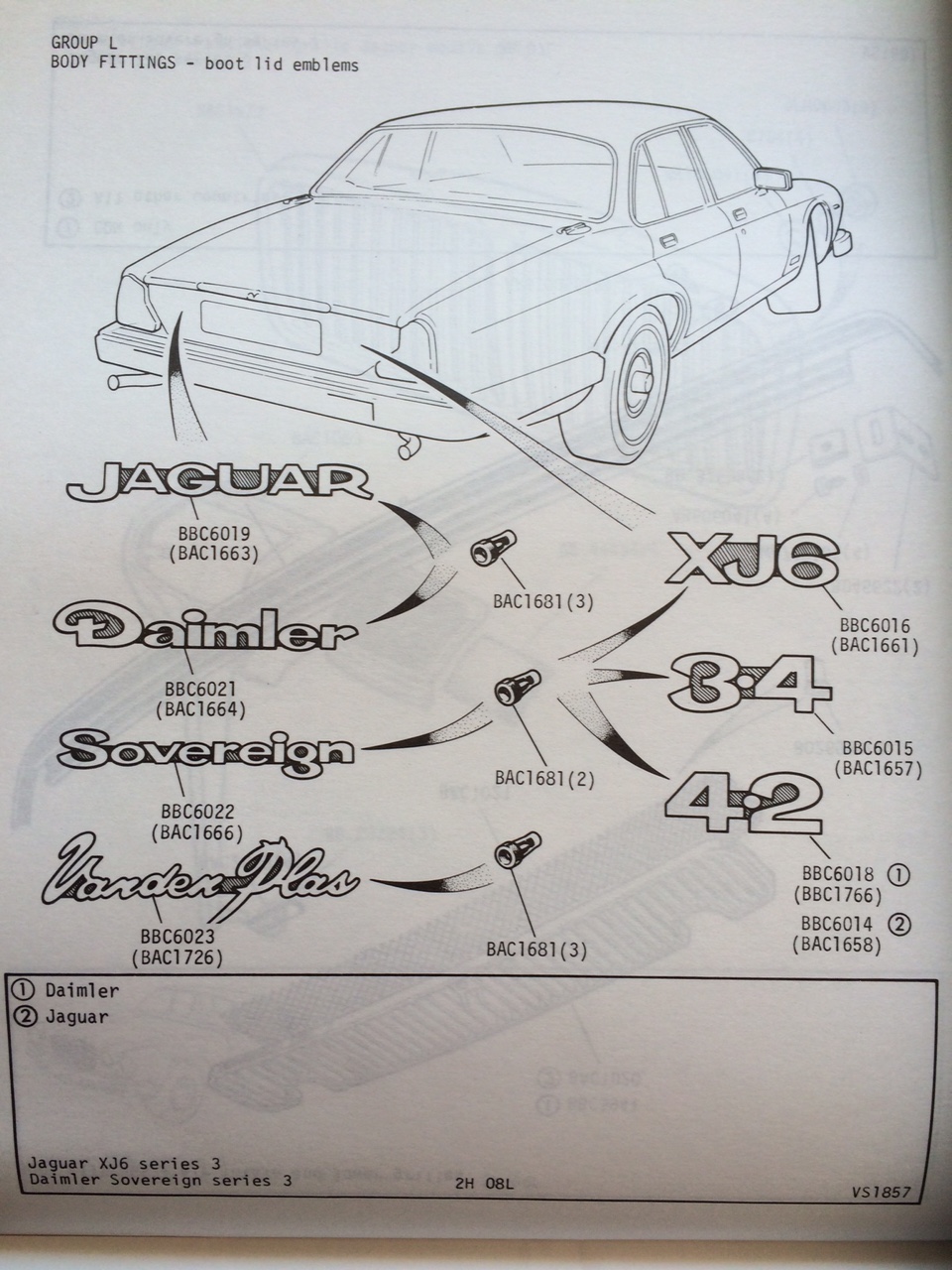

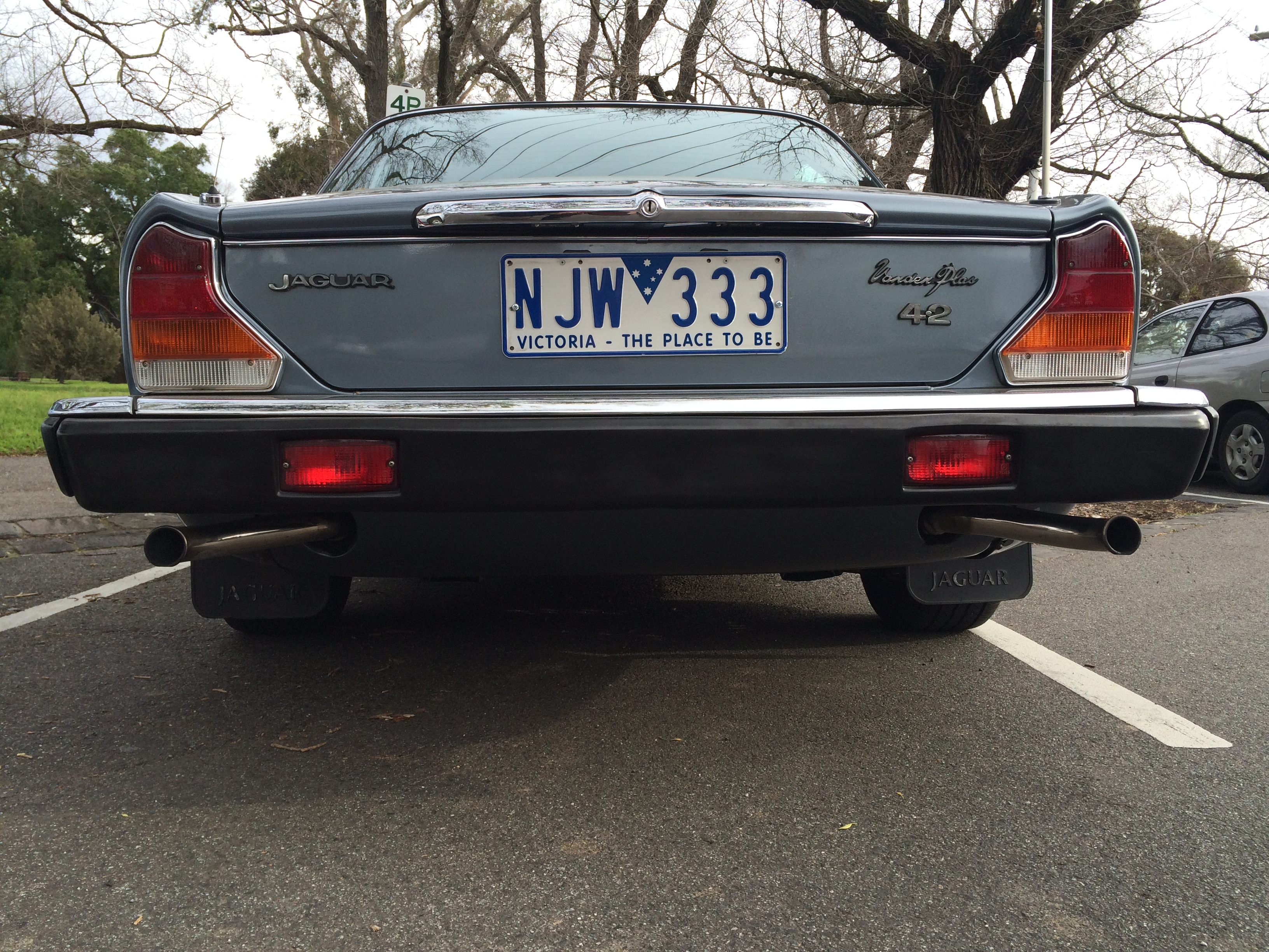

the car in the photo is a VDP but the VDP badge was stolen before I bought the car from deceased estate the son said he did not remember which side it came off the boot lid ,She has Daimler on the passenger side and double six on the Drivers side,she has all the VDP requirements and R in the VIN plus the forum after seeing interior photos concluded she is a VDP,he polished the mark out of where it sat.

Hi Prettydaim,
Jaguar / Daimler badge goes on near (left) side
Model - Xj6, Sovereign, Vanden Plas goes on off (right) side
Cheers,
Nigel

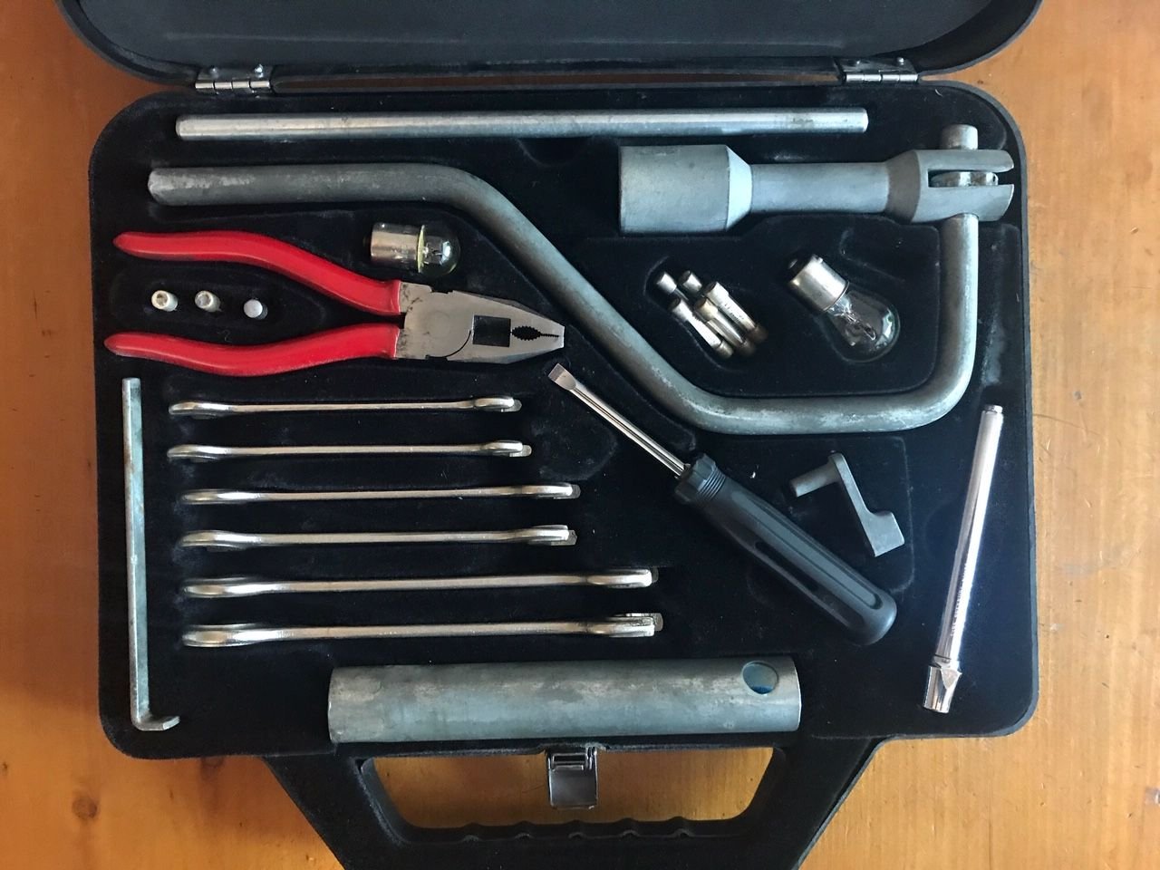

I think I have see a long box tool kit, but it was incomplete so unable to identify the application. However I have 2 complete XJ6 kits and 1 complete XJ12 kits.The all use the same "briefcase" box (I'll attach the picture, but also depicted at the front of this thread). The difference is in the interior panel profile and a few of the tools.The XJ12 had an alternate spark plug socket for 5/8" plugs to the XJ6 tube and rod plug socket for the 11/16" plugs. I copied the RH mounting location and duplicated the bracket from pictures I found somewhere. As it happens the RH trim panel and trunk wall is already configured for the bracket installation (even on my US car): there is an anchor bracket ready for a speed nut on the side wall and there are cutouts and holes in the fiberboard panel under the carpet.: The installation is as factory as one can get without the original bits. Incidentally, I can reproduce the bracket set if there is any interest. Waterjet cut, form and paint and attach to existing holes.
I don't have both tool kits here, but I'll get pictures of the two kits to post this weekend.
