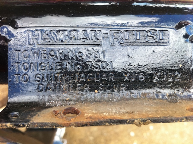

Thanks David,
I have (hopefully) attached two pictures of the towbar... (just have to excuse the brick).
The bar fits snugly up inside the bumper, and attaches to the bottom of the boot, where I will have to drill some holes in the wheel well to be able to bolt it up underneath the car.
Hope the pictures help to show the design of the tow bar... seems as though the tow bar is for a non "foglit" S3 XJ or an XJS2(?)
regards,
Rhys
regards,
Rhys
