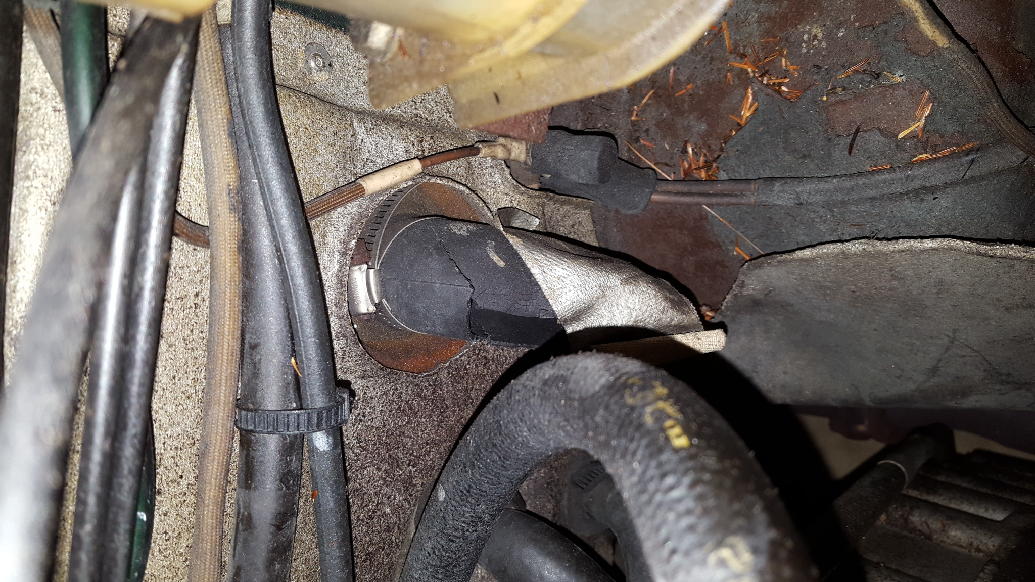

Hose coming out of the firewall into the engine bay (see picture) is cracked and has tape on it but is this a vent tube or what?

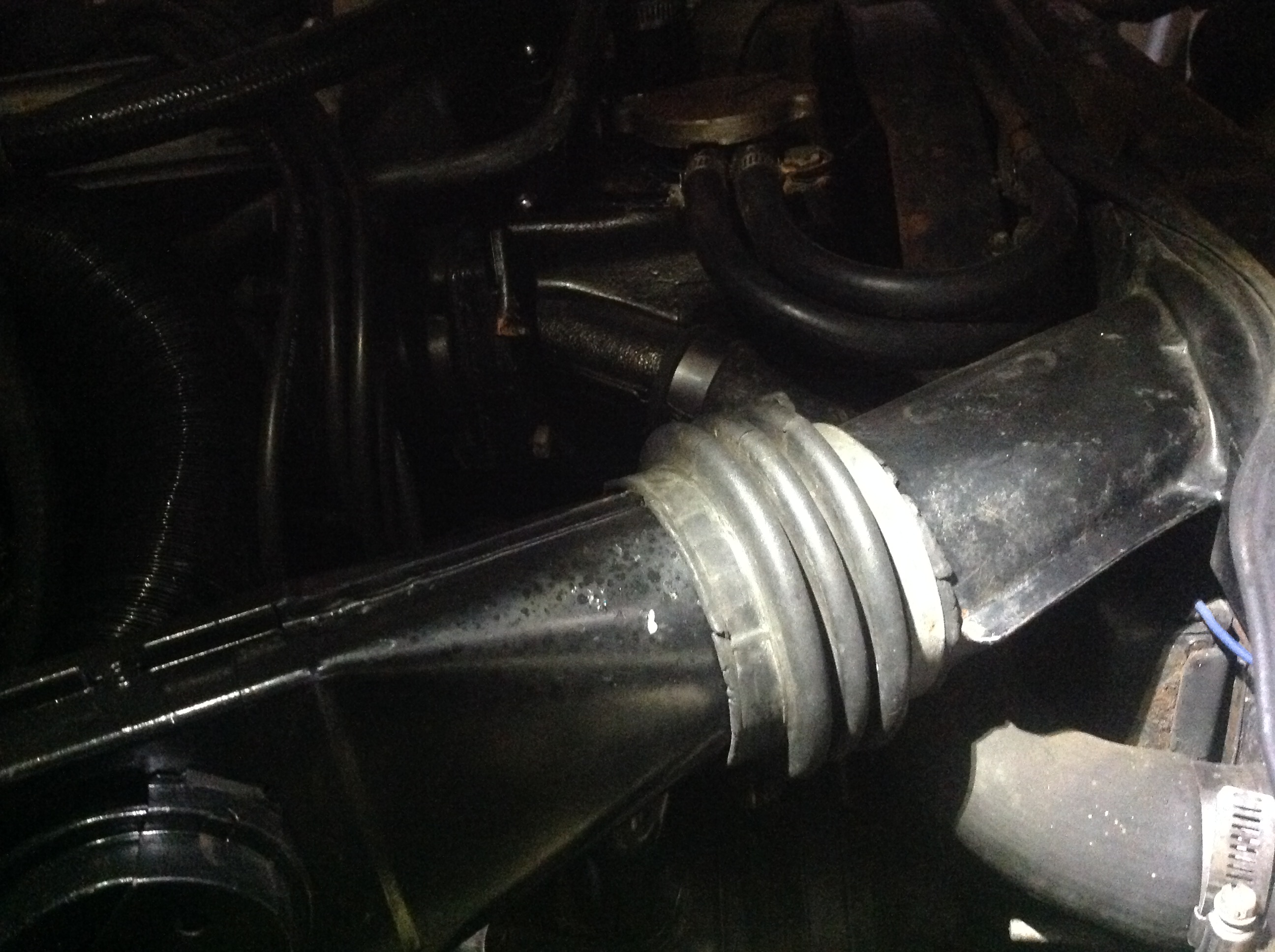

Air filter pipe towards the bumper was cracked and had been taped. Anyone know a part number for this? I think I saw flexible hose in some part diagrams but he pictures of the part doesn't really look like the pic here.

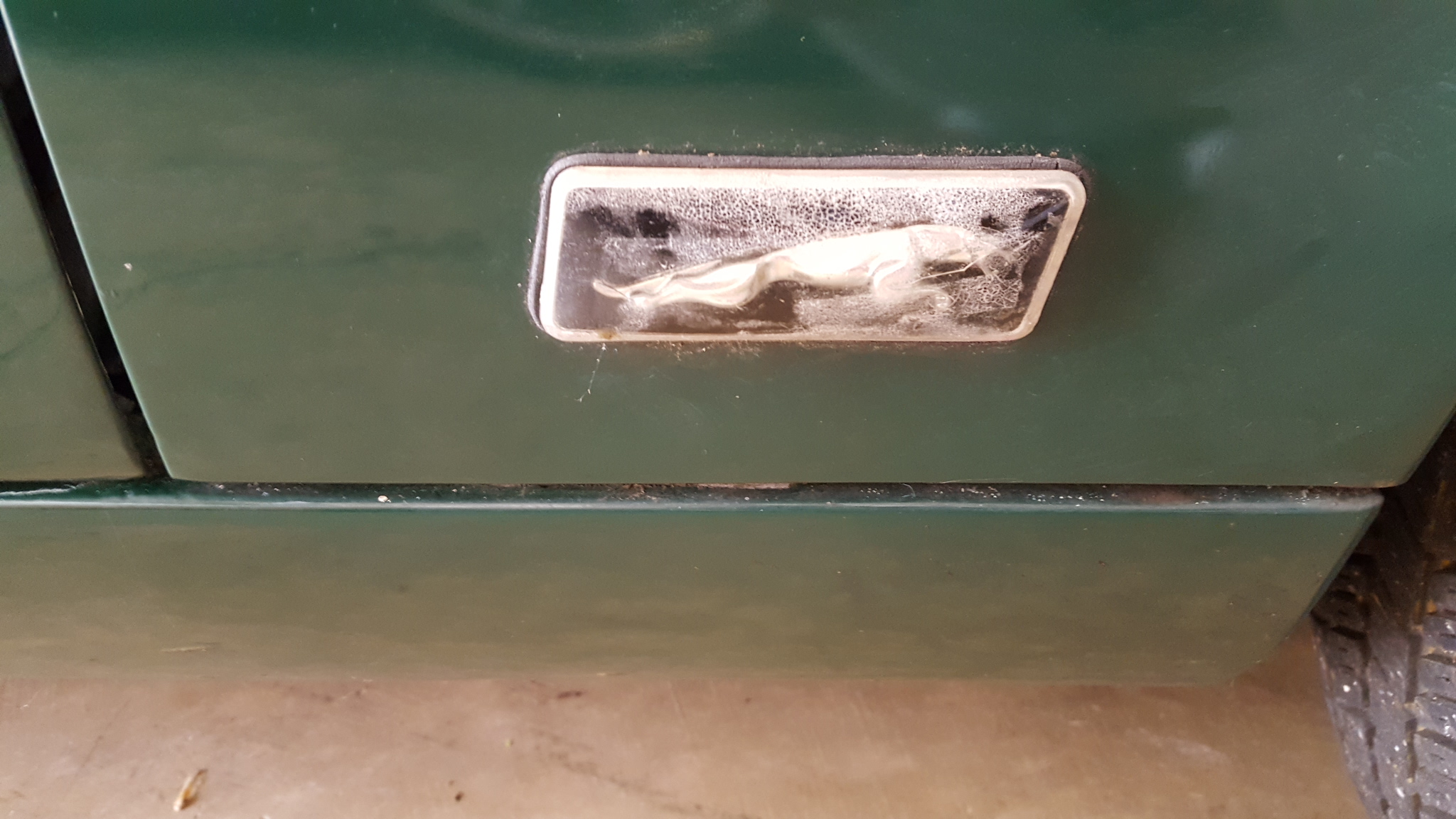

Side emblems look very hazy and front emblem is broke. I think i found where to get the front but couldn't find the side cats. Any suggestions?
That is where rain water drains from the grill under the windshield. I don't know what good the tape would be, one of mine is completely missing. They're very hard and brittle by now, after all these decades baking in the engine bay. If you bump it accidentally it will doubtless shatter anyway.
My front emblem is broken, I've not seen one that isn't. But EverydayXJ.com, David Bodger posts in here sometimes, he's a breaker on the East Coast. He has all sorts of Xj6 parts, used of course, but only the good ones get sent out. He'll have what you want and even tell you how to change it.

"Hose coming out of the firewall into the engine bay (see picture) is cracked and has tape on it but is this a vent tube or what?"
that's called the cowl drain. you might get one from a later XJ up to 1992 or just get a radiator hose of the right diameter that fits the drain tube and that has a 90 degree elbow, like an upside down " L ".
the emblems are available, check eBay daily or click on the links below:
grille emblem:
NEW JAGUAR GRILLE BADGE EMBLEM 74-87 XJ6 XJ12 BD42436 | eBay
side / wing emblems:
80-88 Jaguar Leaping Cat set fender side emblem badge logo W/Gasket XJ6 XJ8 OEM | eBay

Air filter pipe on my '74 has rubber as per photo...

I think the part number is c37549.
Jaguar HOT AIR PICK UP FLEX HOSE TO AIR CLEANE - C37549-OE
Yeah, it looks like I'm missing that accordion style flex tubing.

Found the hose. Actually was C33448. There is an air hose on the back side of the air filter housing that may need to be replaced. Ordered the little 1449 bulbs for the fuel switch button and all new fuses under the dash. New air filter too. Will do master cyl and booster too.
